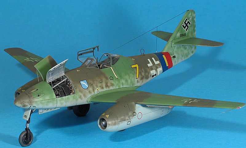

Mix some paint on the thin side, and practice spraying until you can paint a thin line without any spatter. You may have to adjust your paint mix, air pressure, and paint volume until you can do this. When you find the adjustments that work for you, try painting small irregular “outline” shapes, then filling them in.
If you look at pics of actual aircraft, you’ll notice that the mottle are not polka-dots, but irregular shapes. I first paint the shape as an outline, then fill it. When I have these painted, I mist a little of the same paint around the area. This reduces the chances of it looking like spots.
This camo was painted with the above technique.
