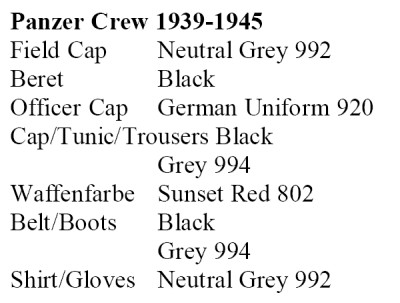

I have this base color recommendations from a German uniform painting guide
… and to get an idea of how a commander and a crewman should look like …
Thank you guys for those recommendations and nice color photos. Those photos give some better inspiration to see the details of the uniform and the subtle differences in the shades. I just got back into modeling about 3 years ago. I started when I was 8 years old and quit in high school when girls replaced the plastic. :grinning_face: I bet that is a common story! I’m on a journey of re-learning and also just learning how to skill up. Trust me I wasn’t very good at it as a kid and I have a lot to learn now. I’m in a process of learning how to chip the paint on the tank and now how to see the different shades of colors to create more realism and interest.
