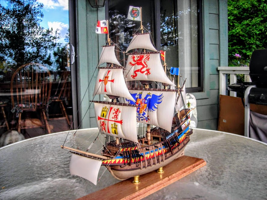

I have been completely busy for the last 6 or 7 years with mostly sailing ships & some steel warships, like this & I loved them.

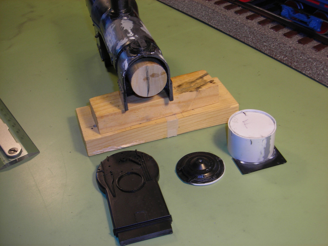

I had to make an extension for the Union Pacific 119 as she was a coal burner. I carefully cut 3 round discs sized to fit the existing smoke box & cut the General name plate backing off & fill the hole. This took some time. I also filled the spoked front wheels & this was another time spender.
I luckily found a wooden thread roll that just about fit the wheels & used it to cut around my circle & cut the center out.

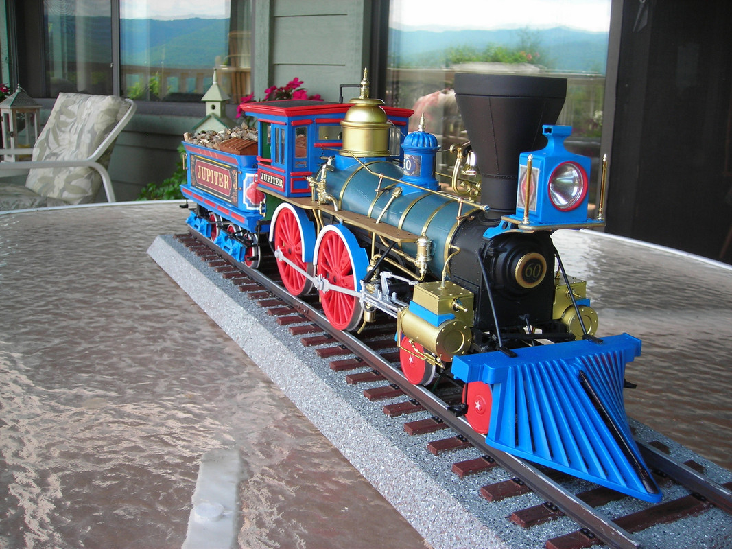

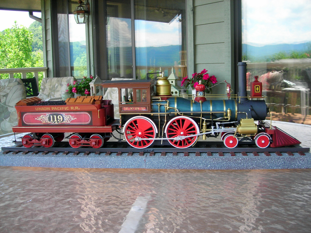

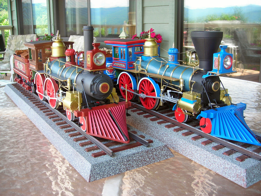

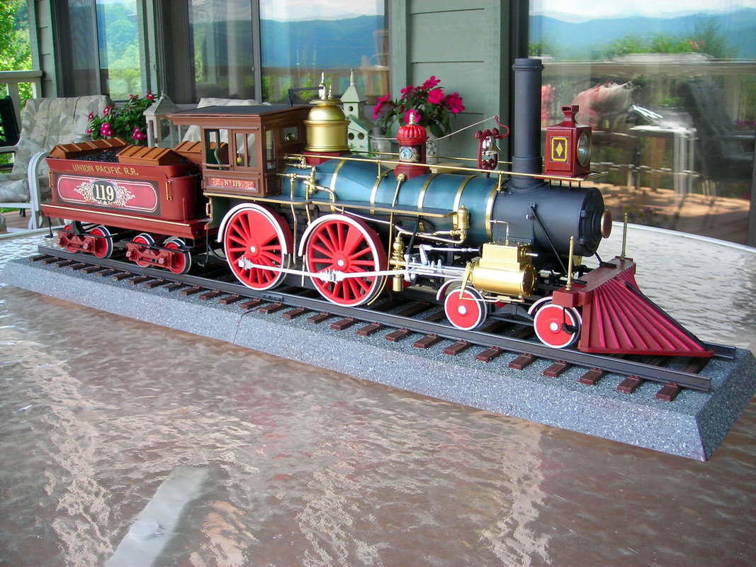

I will post 2 pictures of my finished models to keep you interested. It took me about 5 months to finish all 3 locos & I am pretty fast.
The paint colors are pretty correct as they just refinished the2 engines in 2015 & Walt Disney helped with finally getting the correct colors. The front smoke box was a dull black, The Boiler was all Russian Iron Blue & the 119 was a deep maroon Tender Cowcatcher ,light & sand dome. It had a red brown cab. & gold trim & bands. I used M&M Brass lacquer on all that I painted & reworked the kit brass castings.

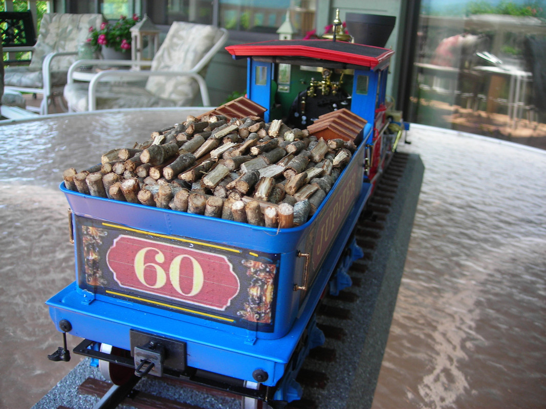

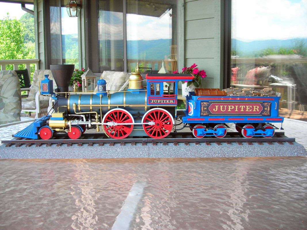

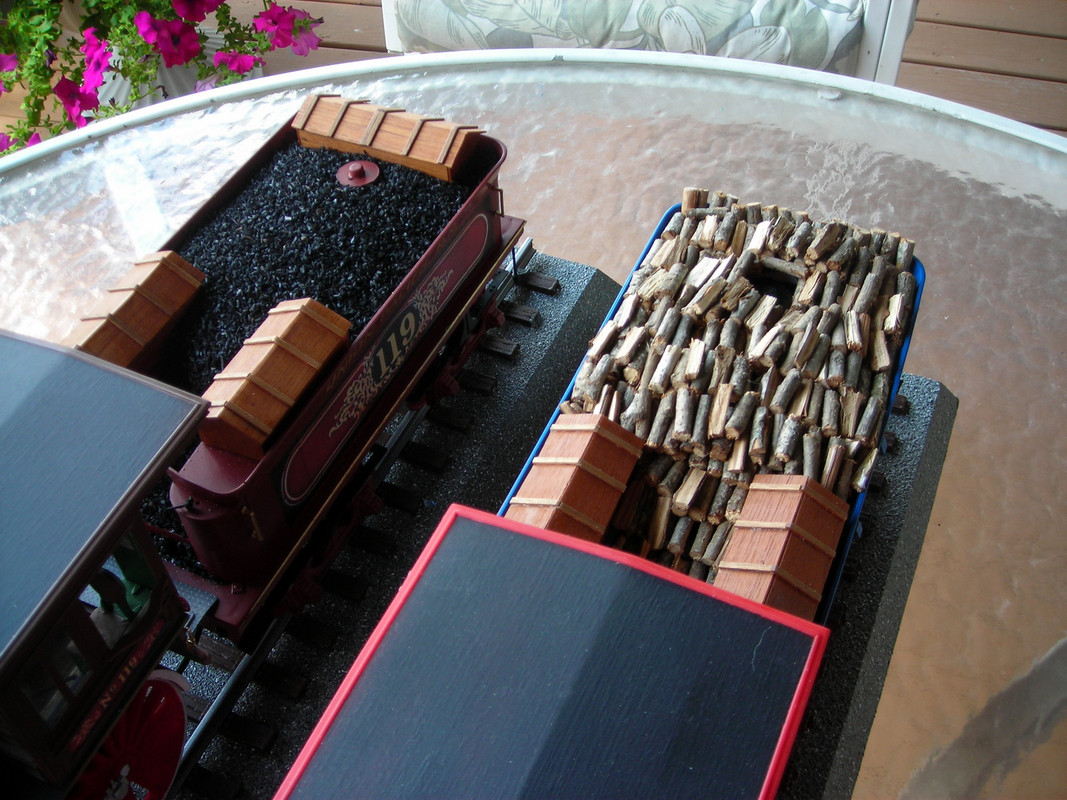

The Central Pacific, from Sacremento , Ca. , was the Jupiter. & it was a wood burner & all the wood came from my front yard & 2 Oak trees.They were really proud of there engines so they were trimmed up to a super degree. I saw them back in 1980 & they were painted in Red because they did not have the correct colors then.
Here are a few of the 2 & I love them.

I forgot this one of the coal & wood tenders. They were a lot of work.

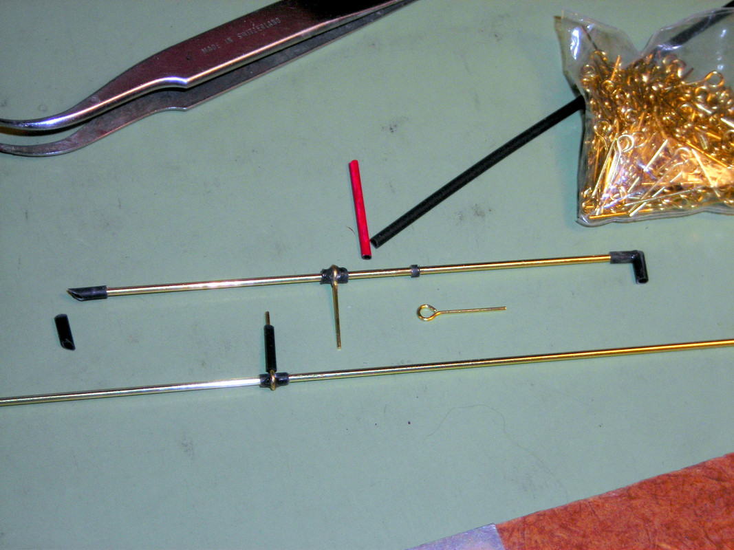

Here is something I just made up to do this. I used 3/64 brass rods for the handrails. I polished the brass first & did not lacquer it so my plastic tube would fit over it.
I use a brass eye bolt & a plastic tube that fit over the 3/64 rod. I cut the tube short & CA glued it in place I then found a small plastic tube to go over the eyebolt & cut it to length from the kit rail part. They set in place in holes in kit parts.
On the 119 I extended the raill all around the light & made corner fom the plastic tube CA glued at 90degrees . It worked & I drilled out each piece so my rail fit easily. I brass painted it all when done. I also cut the trim end off the kit rail & glued it on the Jupiter rail as it is shorter.

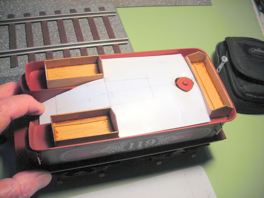

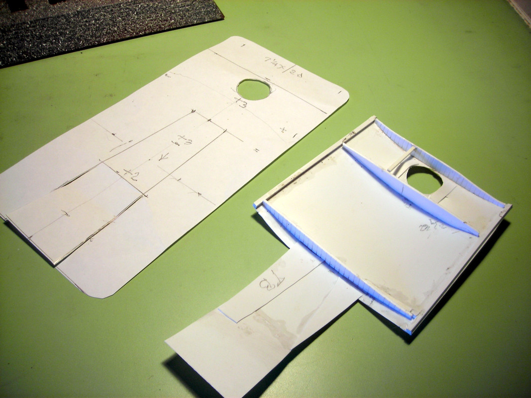

Another thing I did was made a raised base in the tender to use less wood or coal. I did not do this on the General & I was cutting wood for hours.
The top one is a paper pattern & the bottom is my raised plastic base. Cut it the same size as the inside tender as the raised center does not change it that much.

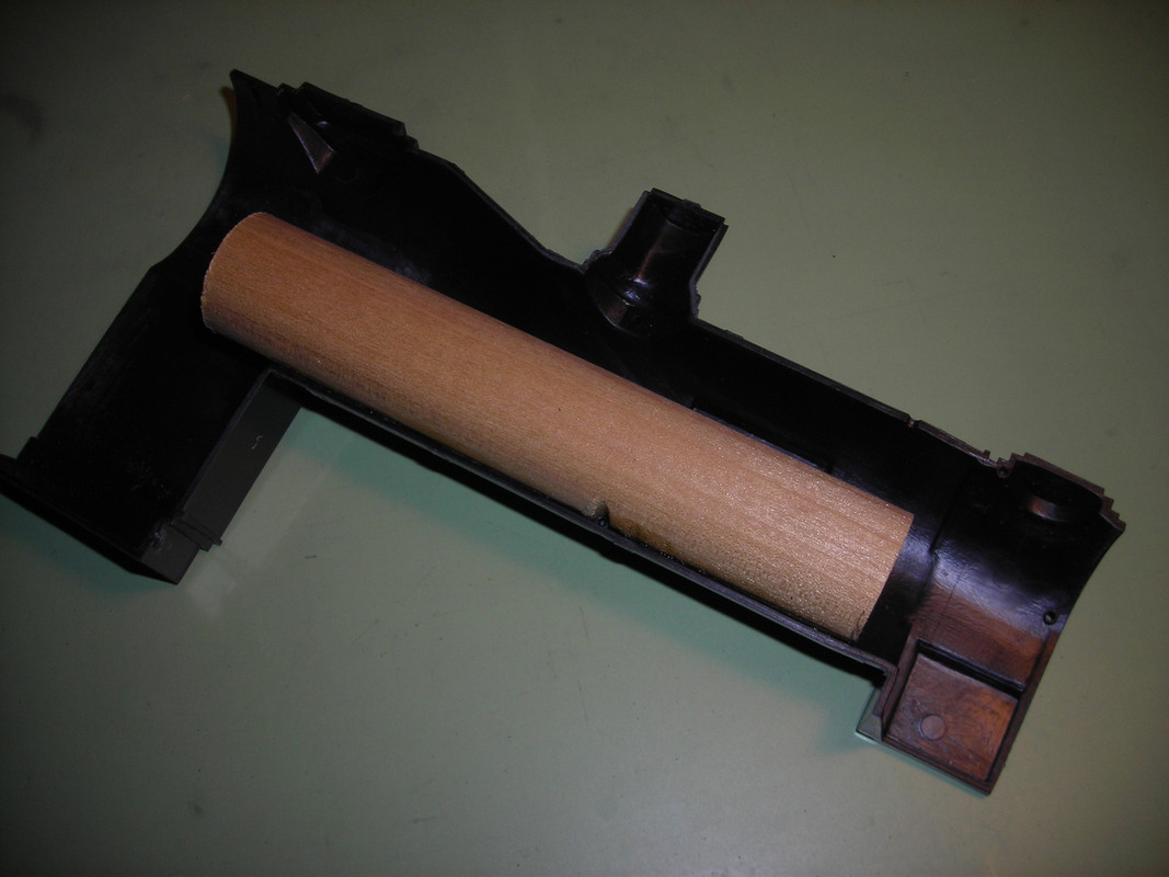

This is how I added the front half of the smokebox. I ran the big dowel right out to the front so i could glue on it. I cut the smokebox front castingout & had a small piece for the back section & the round front out front. I made a 3 piece extensiona little smaller than the kit part to leave room for 2 layers of plastic wrap.
You can see where I cut out the nameplate backing & filled.

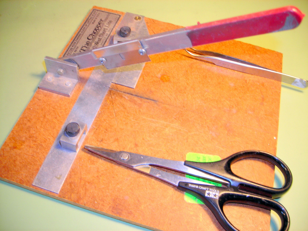

Neat little chopper for small things. Blade lasts a long time, but I get 100 at Lowes for about $8.
