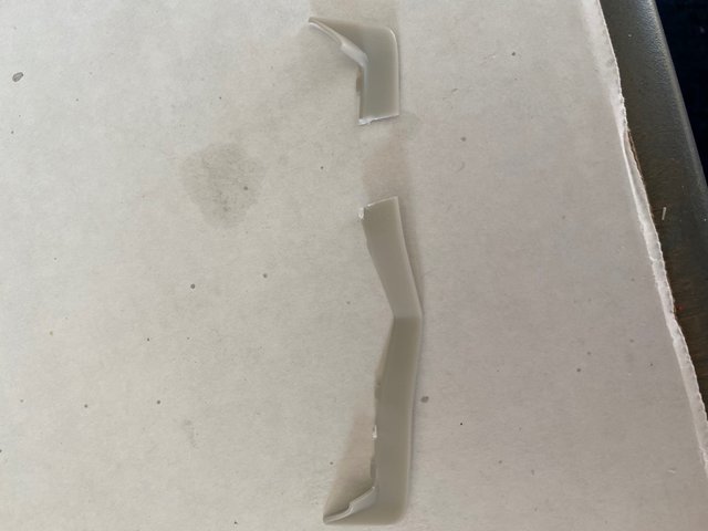

Then, as I went over all the pieces, I noticed that one was broken. With a bit of liquid cement and Tamya putty I managed to fix it. I just hope that the paint will cover everything up.

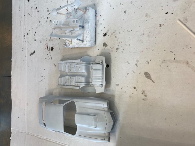

After cleaning all the part I was ready to start. The first thing I did is prep most of the body part for painting. I removed all the flash, lightly sanded everything with 400 then primed with a spray can. When I prime, I put 3 light layers with 20 minutes of drying time between them.

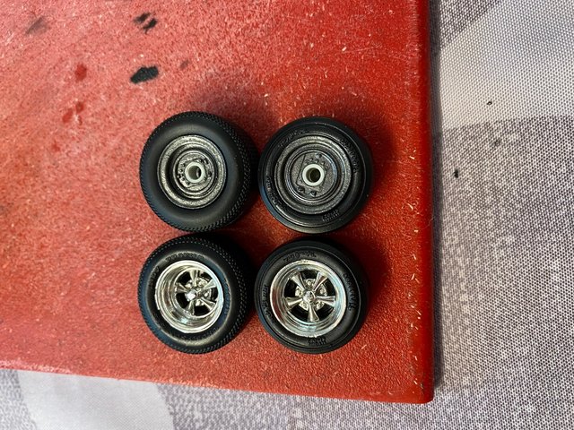

I let the primer dry for a couple of hours and meanwhile I did the four tires. Quite easy, I brush painted two coats of gun metal by tamya on the inside of the wheel and some homemade black accent on the chrome parts for a better look.
After 3 hours of drying time, I wet sanded (1500 grit) each body part and polished them with cheap toothpaste. Once the polishing was done I rinced them off and called it a day.

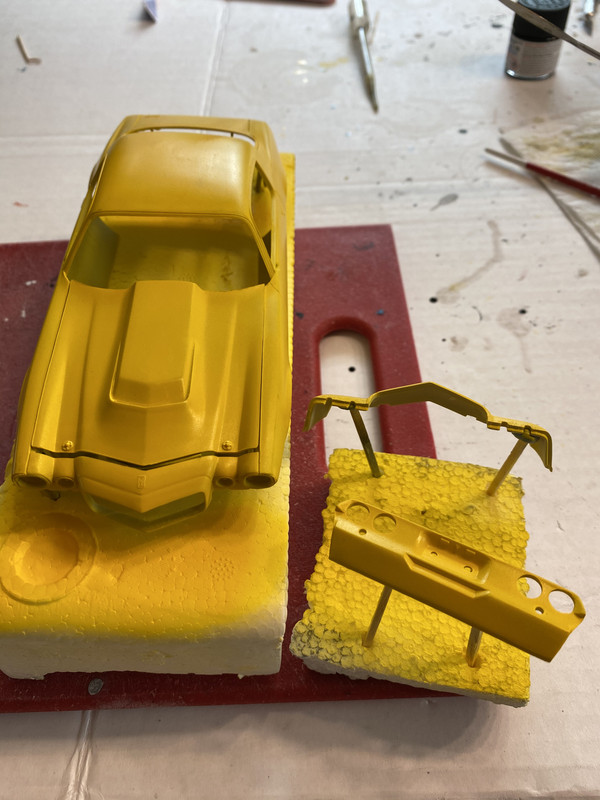

Alright, so here’s what I did yesterday.
Like planned, I started with painting the body. I used a bright yellow and aibrushed it.
I usually work this way to paint these parts :
First I lay a mist coat over everything, not really caring if I cover the body perfectly.
I wait 20 minutes and put a second mist coat
And then a third after another 20 minutes
Then I let the final mist coat cure for about 2-3 hours and brush a wet coat. A thicker coat trying to cover everything.
After this wet coat I protect the pieces for half an hour from dust and then let them dry in the open.
It’s my first time with a ‘‘professional’’ airbrush, so we can see that the coat is a bit uneven and yellow doesn’t cover a whole lot. I hope I’ll be able to give it a nice final look with the second wet coat once this one has cured for 24 hours.

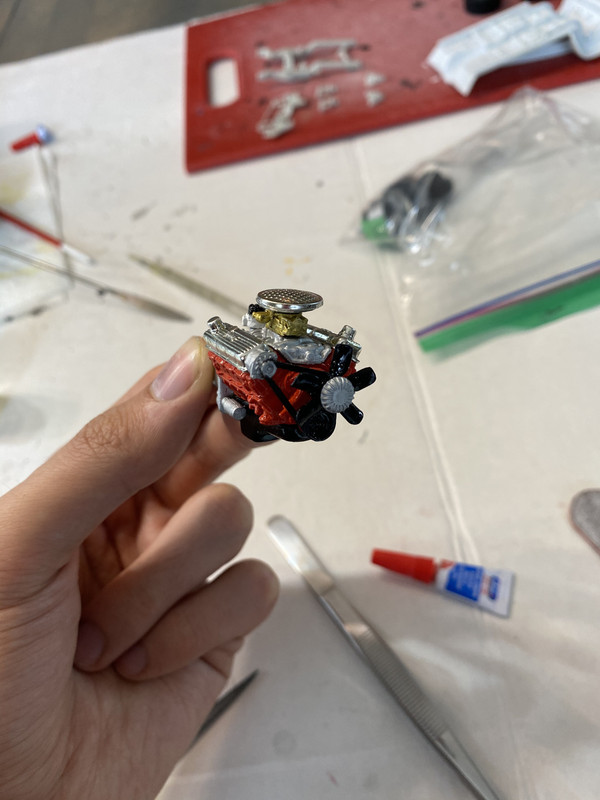

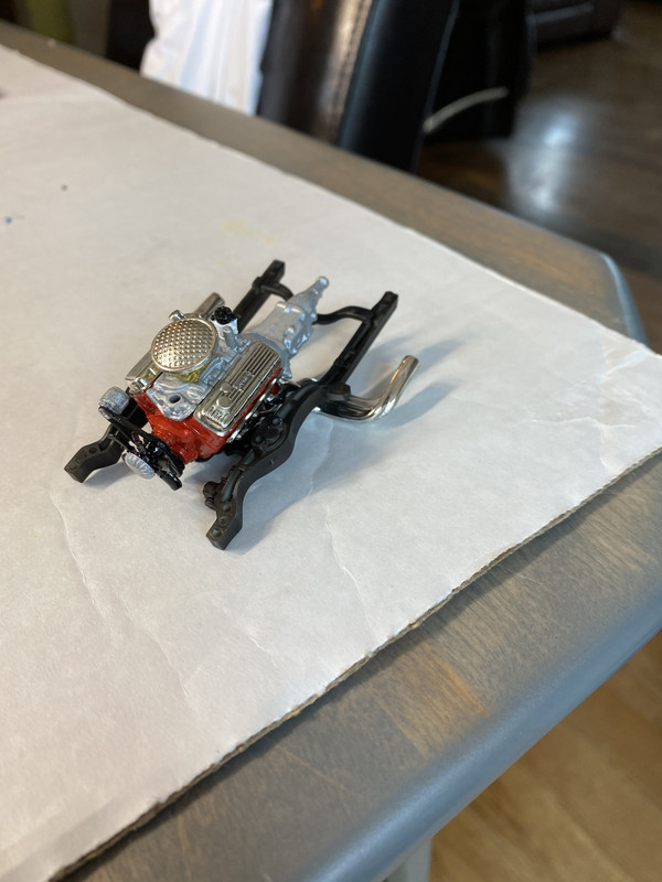

While the final mist coat dried, I started working on the motor. Everything went well, the first thing I did is paint the transmission aluminum and while this part was drying I painted a few others :
Aluminum for the starter and top part (forgot what it’s called)
gloss black for the oil pan.
For the engine block, I taped the transmission and mixed some red with a bit of orange to achieve the color ‘‘Chevy engine red’’ in the manual. I compared it from pictures and I think I am pretty close to the real thing.

I enjoyed your last build and this one is looking good as well. The part on top of the engine is the intake manifold. If you plan on building a lot of American cars and you live in the US or Canada (not sure about availability in Europe), I’d head over to your local auto parts house and pick up a spray can of Chevy orange. There will be enough in one can to do many engines. All of the Chevy muscle car engines will be this color, and you’ll find Chevy engines in a lot of street rods and customs. The reason for this is the same reason modern US custom cars and street rods use the LS motor today, Chevy made a lot of them, they were lightweight compared to their competitors, they made good power, were easy to work on, and performance parts were cheap. The stripes were painted on so they would be glossy. The interior was mostly vinyl, so there would be a sheen to it. Look forward to more.

Alright guys so here is what I did in the last two days.
First, I gave a second wet coat to the body pieces.
I dont know if it’s because it’s my first time with a decent airbrush or yellow doesn’t cover well ( probably both honestly), but I have a hard time getting an even finsih. I’ll probably end up adding one more coat. I still have the interior and the stripes to do…
Then I finished the motor, happy with the result.

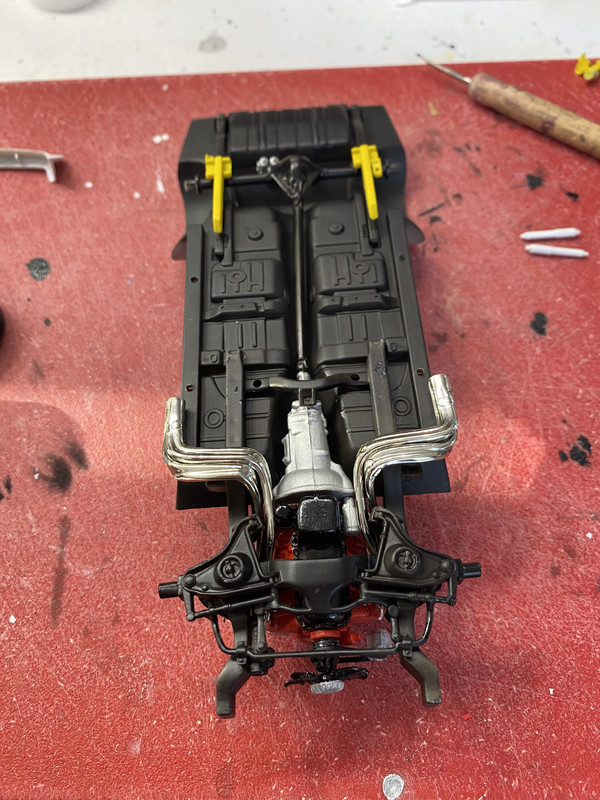

My next step was now the chassis. I airbrushed most of the part semi-gloss black.
Before putting everything together I want to paint the floor of the cabin which I’ll do soon. However I did put the motor on his rack. Now I’m letting everything dry overnight to manipulate the pieces freely tomorrow.
This is lookin’ swell so far Alexander. Will be watching this one.
Yellow is a hard color to apply. If you’re having trouble with the coverage that you want, try applying in thin layers till you get a good color base. This can take a little time but it’s worth the patience excercised throughout the process. After you get the coverage you’re after then you can wet sand any imperfections/ debris out and then go for the clear coat.
That is exactly the conclusion that I came to. I’m working on it every day, I’m getting close to what I want now, then its stripes and clear coat !
Here is a little update,
I am still painting the body, but I am getting close to the finish I am looking for. As I did that, I kept working on the chassis. I painted all the remaining parts for it.
Gloss black : Springs, rear axel, driving shaft
Gloss white : Shocks
Yellow : Traction bars
Aluminum : Fuel Pump
And glued everything together except for the shocks
Before putting the shocks and plated exhausts, I want to make some light touch up with my airbrush. Then, the chassis will be done.

Looks great and big thanks for posting to a site that lets you enlarge the pictures. I really dislike that one site many use.
As to getting yellow to cover, most will lay down white first. Seems it covers better than over the gray primer.
Looks great. On your next one, think about adding plug wires and battery cables. Not really hard, can do them with copper wire from a piece of stranded wire of the right size. The copper strand will bend to shape easily. Take a small drill bit and pin vise, make holes in the plug locations and the nubs on the distributor cap, secure with a touch of CA ( superglue), and paint in the color you want, either stock or aftermarket performance wires.
Battery cables are just a little bigger diameter.
