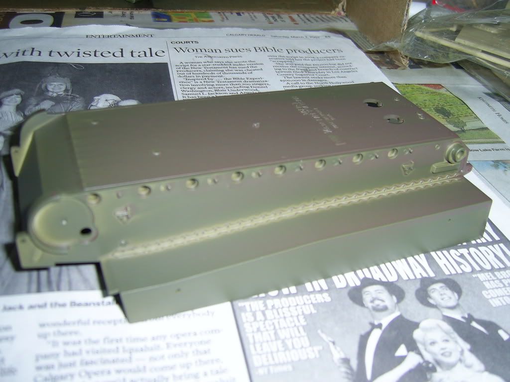

Yeah its T-rex again and I’m presently working on a academy 1/35 Tiger 1 early version for my czech diorama, the instruction says that the paint jobs should be desert camofloge, but for the “forgotten cities” scene souldn’t be that paint job, but I don’t know what? I was thinking of covering it with olive green but is there such style exsits on a tiger 1, and did this design was in the streets of czech cities. I painted the body piece olive green with spray paint (practic for airbrush will I will be getting soon at my 16th birthday this march 18). The result is much better than brush painting, its thine so if I want I could paint it over with panzer gray or another colour.

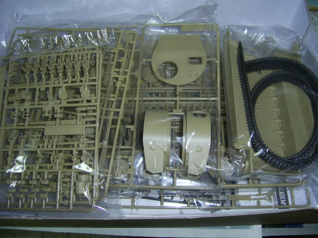

The kit box
inside the box

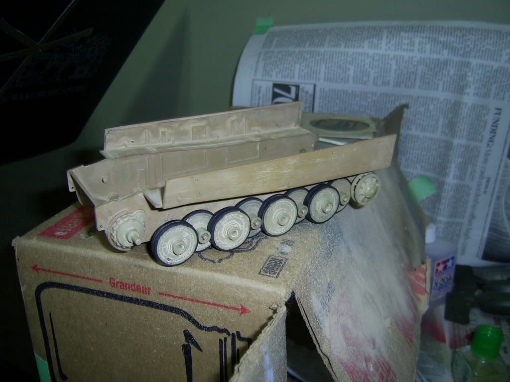

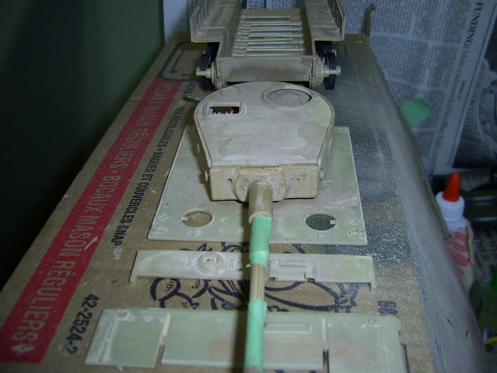

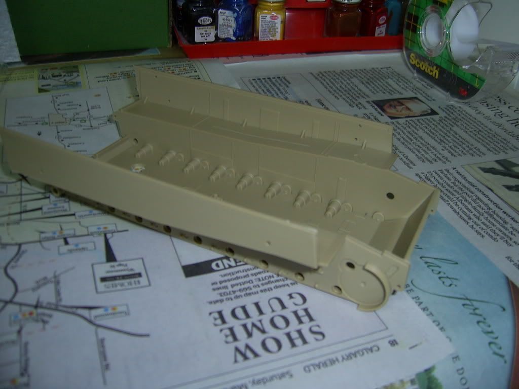

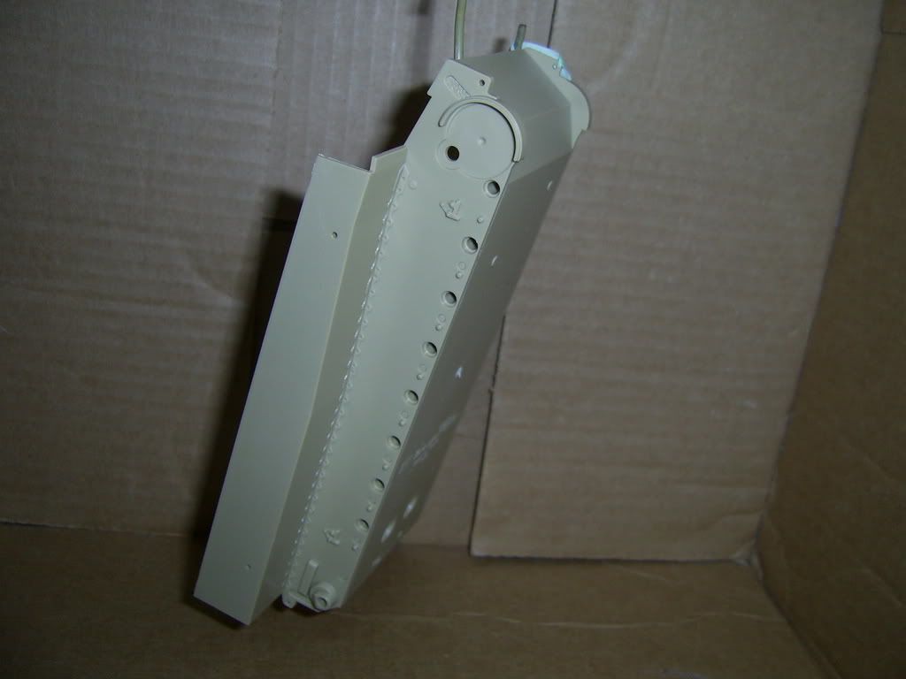

Body before paint
In cardboad paint booth.
Can I paint it over?
And I thought the german came at Czech in 1939 after poland, oops maybe it will still go together. And how do you stop air bubble from forming on the spraypaint pieces your painting?

The problem you’re having with your spray is most likely due to too much paint being applied. You should fill a container with hot tap water and let your spray can sit in it for about 2 minutes. The warmed (don’t boil the thing – it’ll explode) can will yield a finer and more consistent mist.
You should go over the model with several light coats from a distance of 8-12 inches away from the surface of the model. Each spray should be with a passing motion. The passing motion will give you a more even application. Start the spray to the left o the model and keep spraying until you pass the model. Not aim and shoot. These will lessen the possibility of runs and bubbles.
If you want to remove paint, get some rubber kitchen gloves and some EZOff Oven Cleaner. Follow the hazard warnings on the can – the EZ Off will remove your paint for you. Rinse it clean and use an old toothbrush to get the crevices. If the olive green coat isn’t too heavy, then you can just shoot over it.

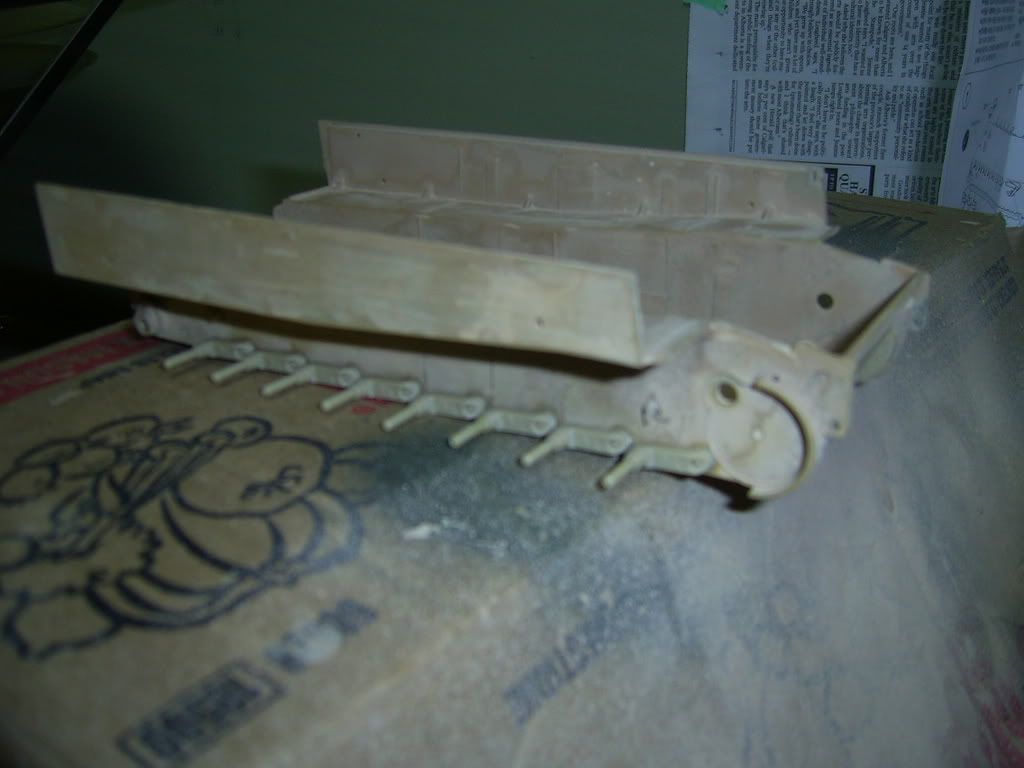

Hey great news![:D] The Tiger is going much better, after repainting the hull with my new airbrush and tamiya acrylic paint, some peices didn’t got entierly painted when I already rand out of paint (needed alot to remove the darker coat of paint, the olive green) It doesn’t look entierly dark yellow, more like desert but the final paint design will be russian 1944, but the final diorama will not be czech or russian, the tiger will be based on a image of my book.

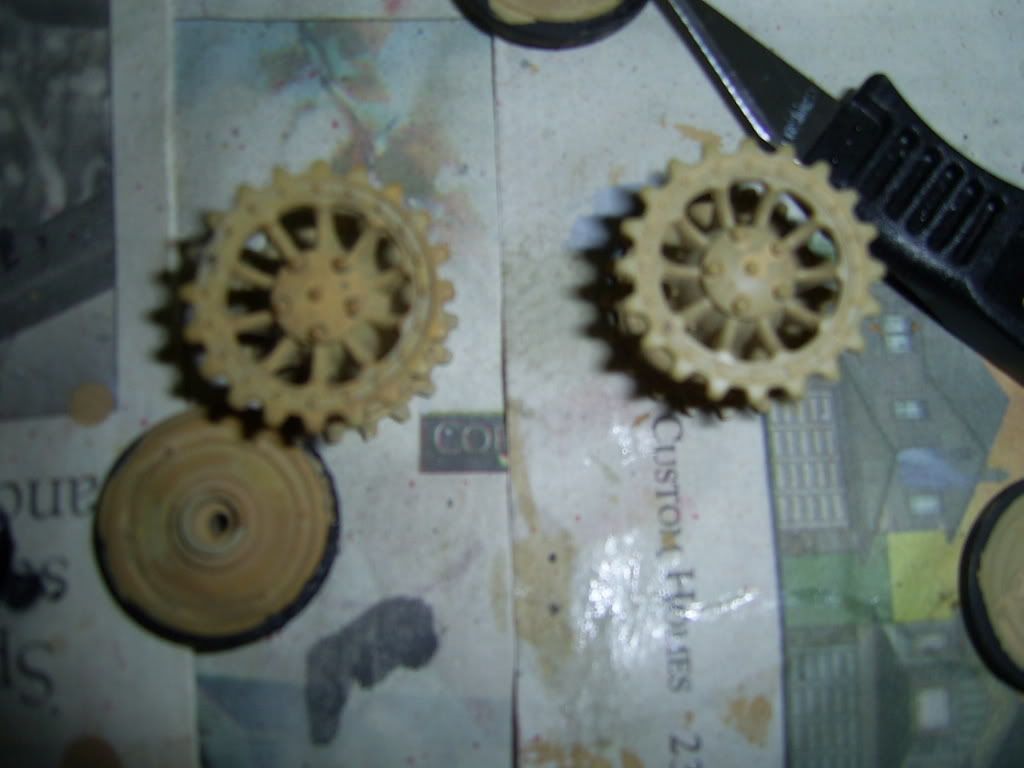

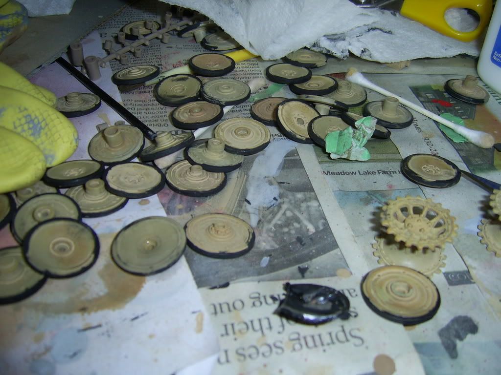

One of the gear wheel (the wheel that moves the tank tracks with the teeths) has a very realistic appears of dirty, perfect for the scene (don’t know how I did it, complete accident). I really need to get a picture of it! but my pictures won’t get downloaded to photobucket[:(!].
(from last forum, notice the realistique dirt wheel on left)

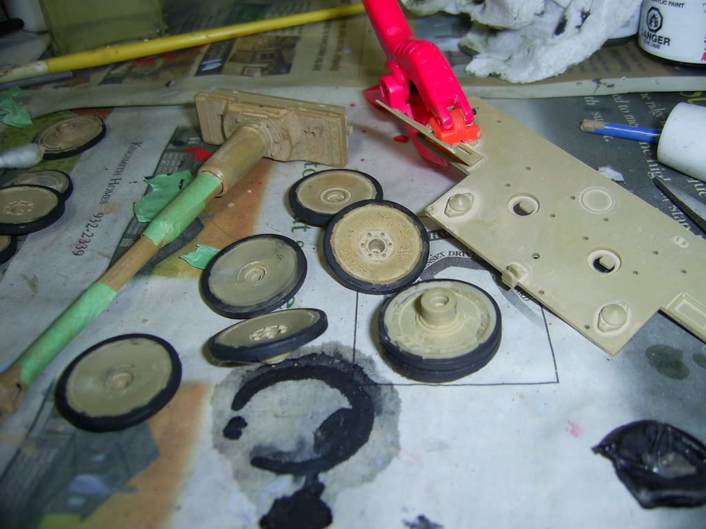

By the way, are all the wheels of the tiger rims painted flat black, and is it better to paint them after behind instal or seperately?

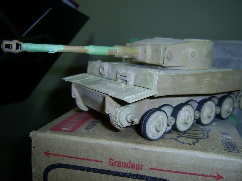

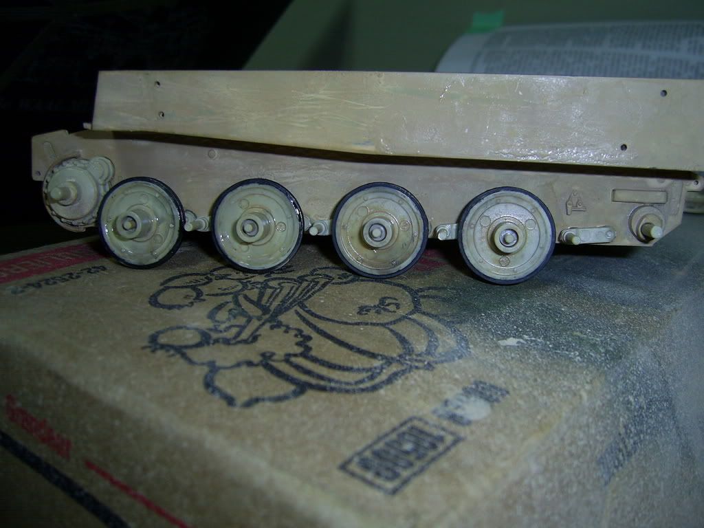

Doing good so far, most of the wheels are install but I think I should have install them after assembly and painting, needs another coat of desert yellow for the finishing touch.

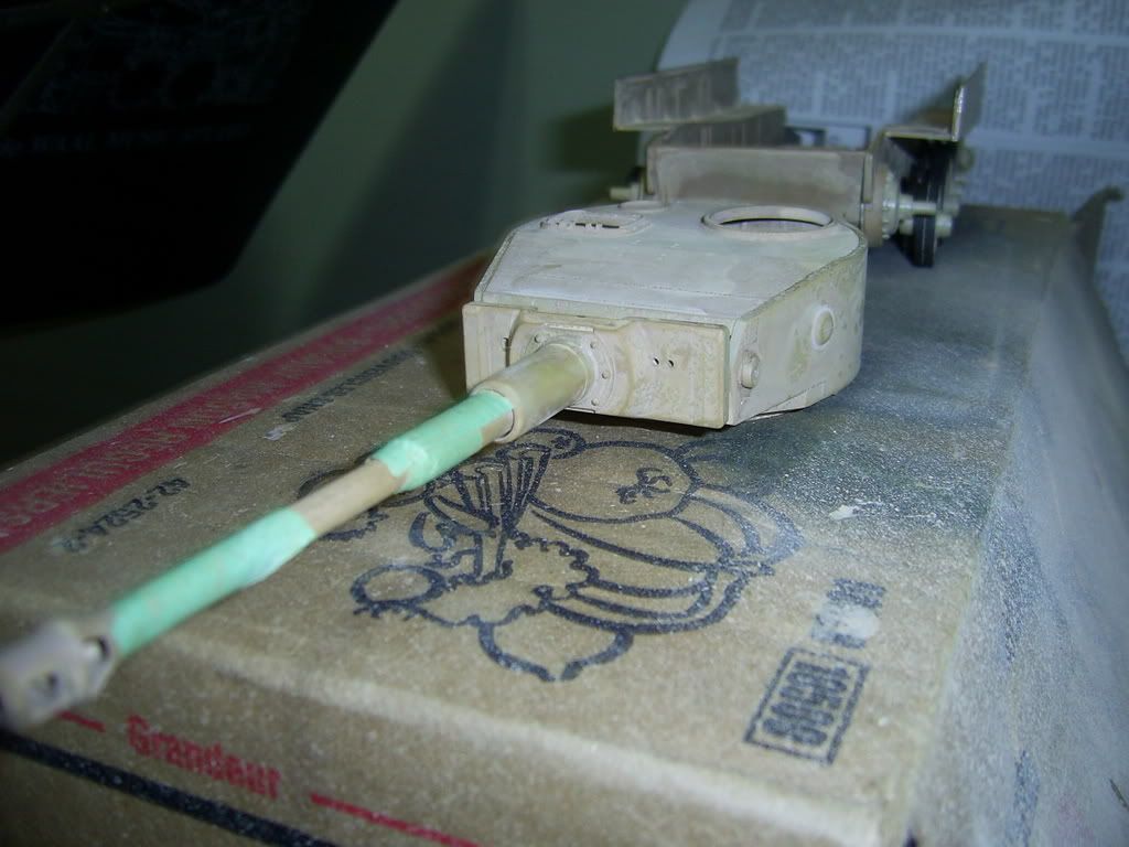

As the tiger comes to near completion I use my Badger 350 to do a coat of dark yellow to finish it of (hint to everyone, desert yelow is not the same as dark yellow) now I’ve applie stripes of red brown and forest green (mix of 50% olive green and 50% light green) the camo looks fantastic, I’m really proud of myself, although I mit have made the stipes too width.
A good idea of what it looks like.
