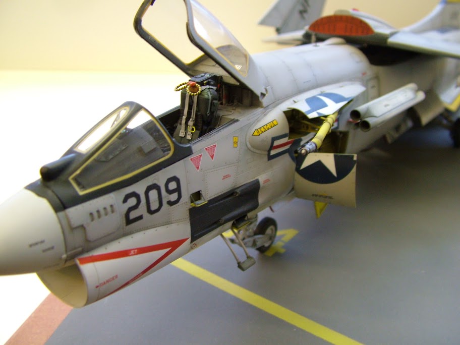

This is my latest model, a 1/32 Trumpeter F8E Crusader built using Aires cockpit, wheel bay and engine nozzle.
The speed brake bay is scratch built as is the detail under the wing. With the exception of the information stenciling and the few warnings around the cockpit area all markings and lettering is masked and sprayed.
This is rather ‘stylised’ with everything open but that’s how I set out to do it - weathering was kept low key but an attempt was made at faded paint - main reason for painting the markings. It was my first 1/32 after mainly 1/48 and proved at times a bit of a handful but despite saying that I wouldn’t do another (1/32) I now have the Trumpeter F-100d which I hope to begin shortly.

This is one gorgeous Crusader. Nice faded paintwork. Perfect masking for all your markings as well. Got the canopy sealant lines done perfect too! This must be a monster in 32nd.

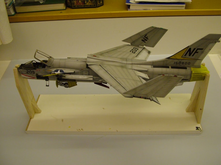

Hi again, Thanks for all your appreciative comments. This is the biggest aircraft built to date and it did prove to be a bit of a handful during construction. Once the fuselage was together it was held on a simple fixture made of balsa and particle board, the nose having an extension from plastic tube and plastic-card webs for support - the nose cone was finally fixed over this with a lump of Milliput to bring the weight forward though with that rear mounted main U/C , even with the Aires resin tailpipe, tail dragging wasn’t an issue. This shows it at a late stage just as the wings were added

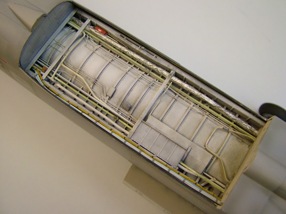

This is the top of the engine bay under the wing. Much of the kit detail was removed and replaced using various means - plasticard and rod/tube, wire, etch, tinfoil etc. The detail was copied as much as possible from the squadron walk round book.
This is the detail under the wing above the engine. The bolts are punchings of .010 plasticard applied with the tip of a brush and fixed with a drop of thin cement.
Once assembled most of this cannot be seen but it was the effect of the full size with the wing raised that was sought after.
The wheel bay was Aires with a minor amount of detailing added , the speed brake bay was rebuilt from scratch
The gun bays were enhanced with wire and etch though only the etched ammo feed chutes were used from the kit etch
And finally, as I’m sure you’ve had enough and I don’t want to over do things the cockpit …
Those canopy seals are masked and sprayed but are a little wider than liked - unfortunately they are moulded on so little could be done to narrow them.

Wow Tug, really nice work. I love the details, particularly the foil in the wing bay around the (hot air??) conduit.

Wait, you painted the markings? Thats even more awesome! Great job!

Marty, I’m not sure what the foil actually covers I just copied it from the SS walk-round book. I’m afraid I’m a bit of a ‘detail nut’ though I don’t count myself a ‘rivet counter’ - I just like to put detail in to give a more realistic effect. That said I find it hard to use artistic license - there has to be some proof. A considerable part of any build time is studying photos - usually in books rather than the net.
Allan - I’ve been painting markings for some time now. It’s not that difficult though it can be a bit time consuming. The preference to do so began when painting a Flanker - I faded the paintwork only to realise the decals didn’t quite match. It’s evolved since then, at first using ready made masks as well as cutting them out by hand . I now have a quarter share in a decal cutter which is an absolute boon - that will cut some pretty small masks. The smallest on the Crusader is the ‘09’ on the rudder
