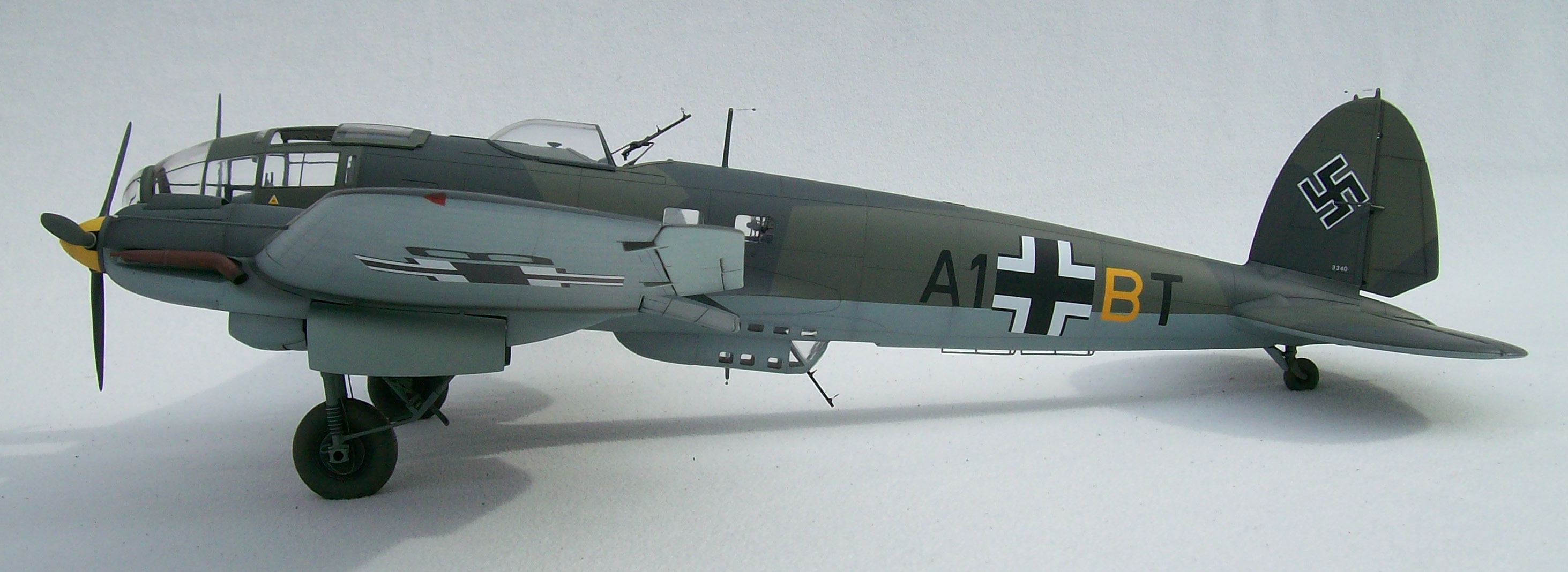

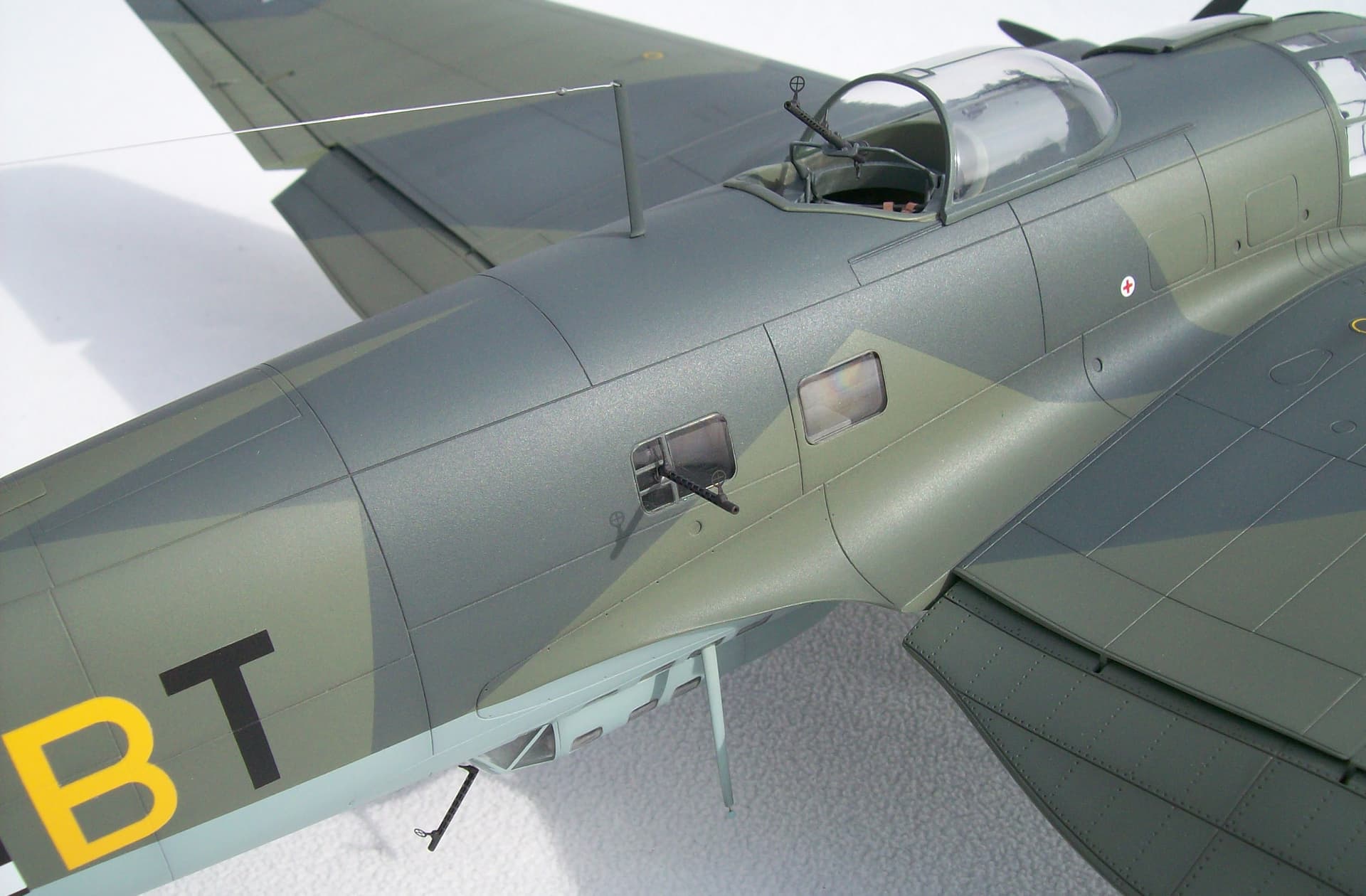

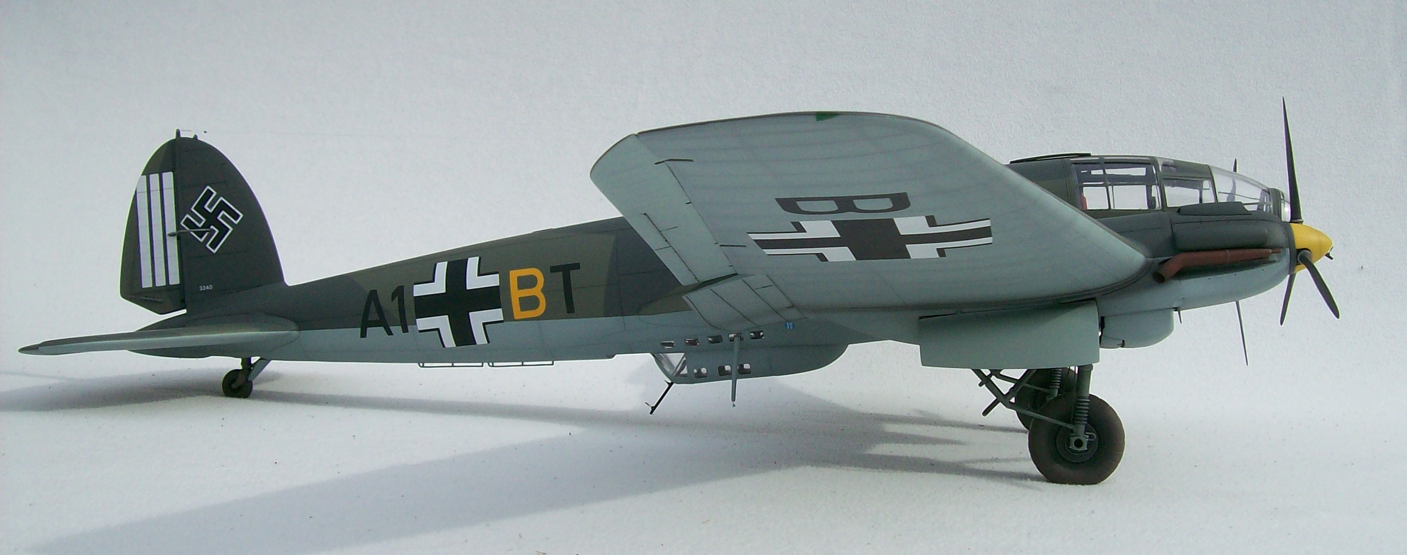

Fellow Modelers,

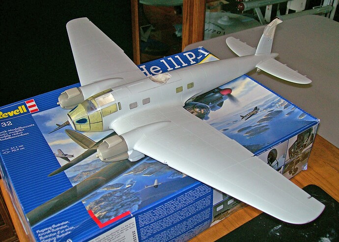

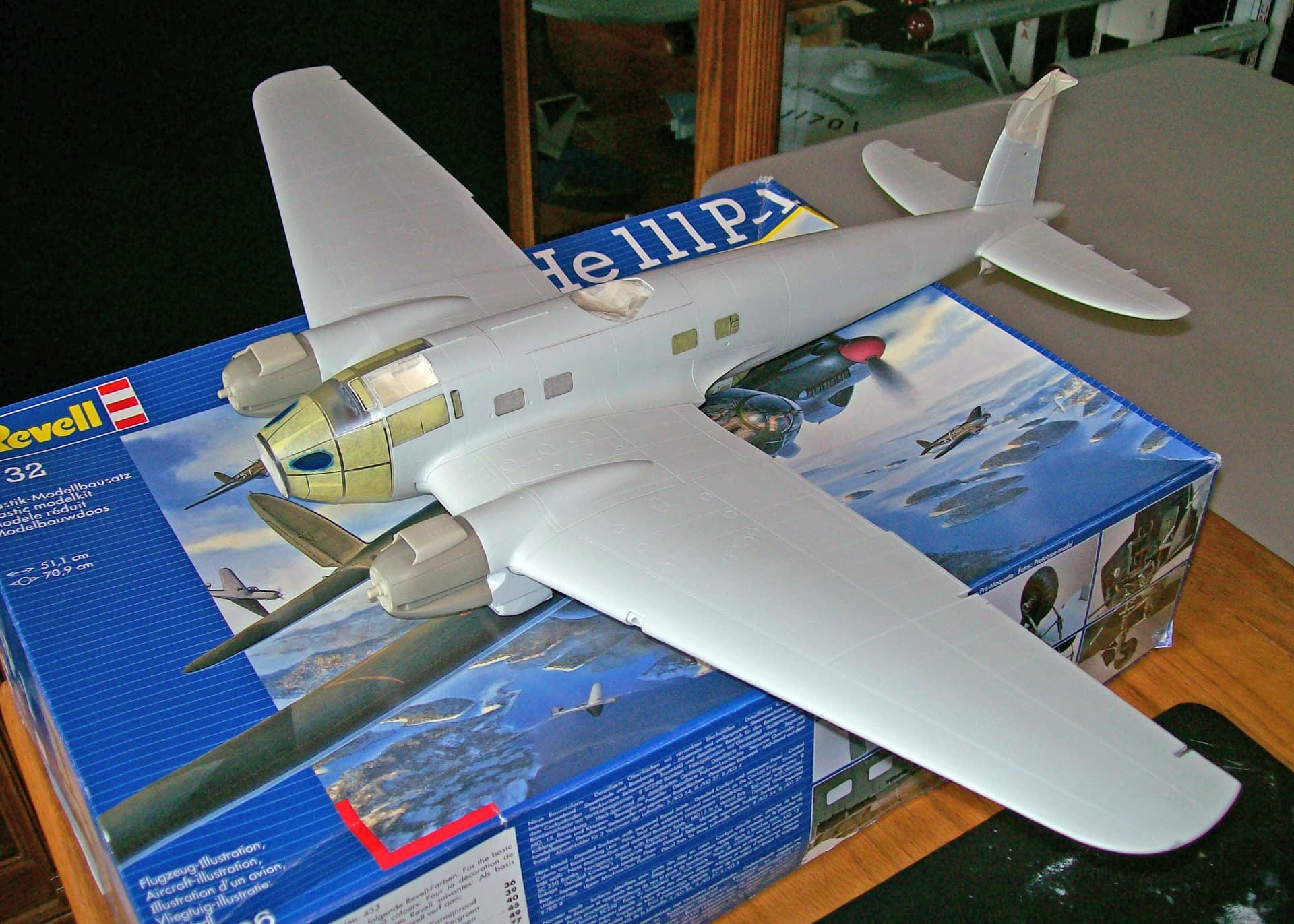

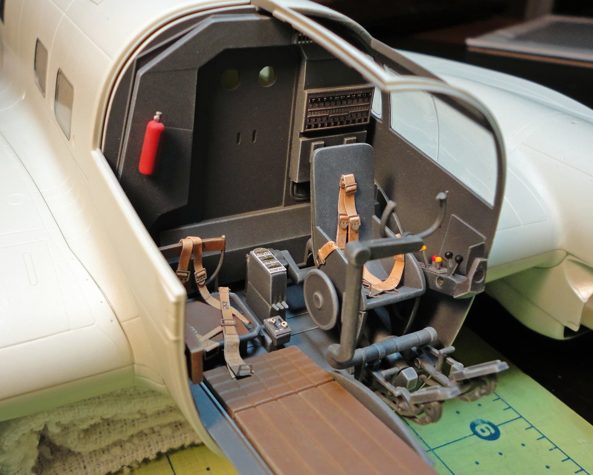

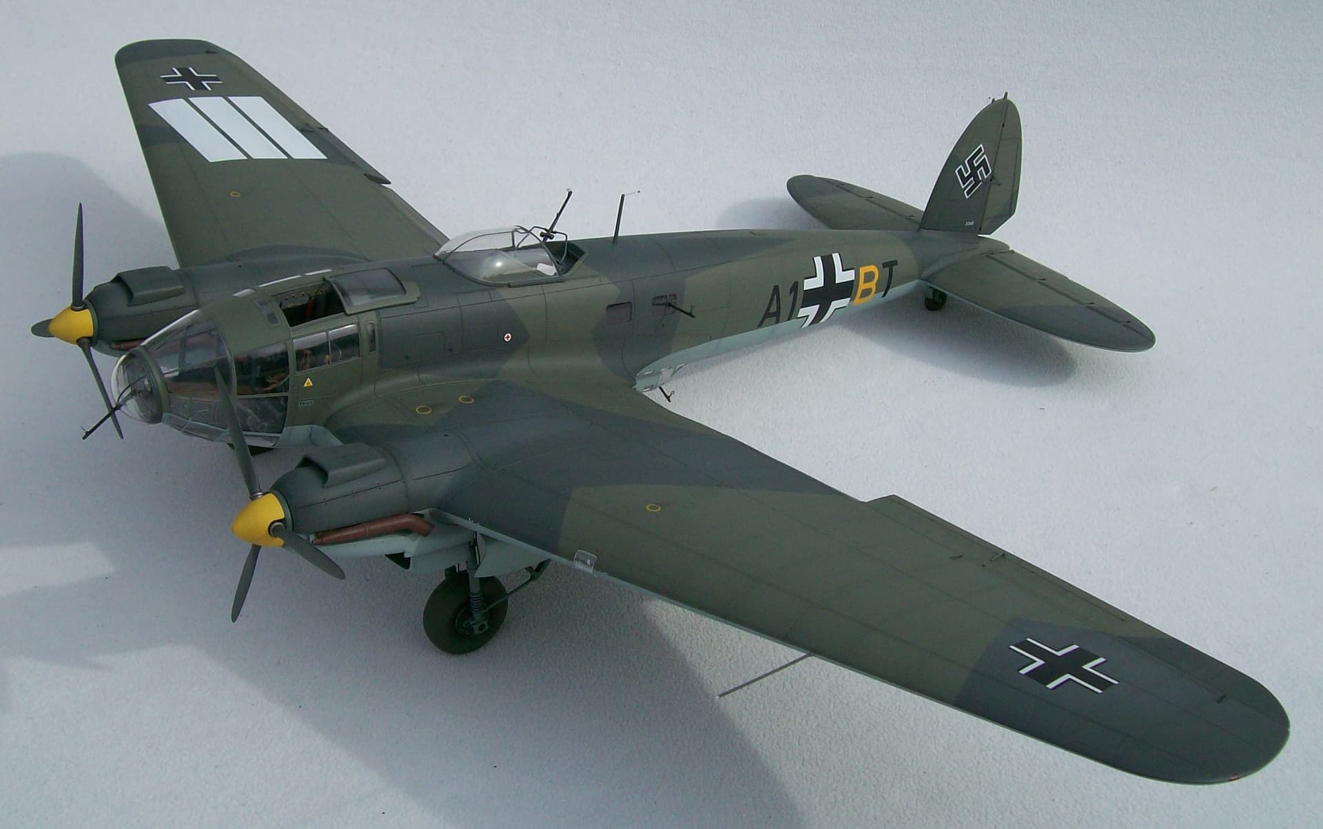

Below are photos of RevellAG’s 1/32 scale Heinkel’s HE-111 H3 German WW2 Medium Bomber built in 2018. The He-111 has always been one of my favorite aircraft and I decided to model it after a BoB (Battle of Britain) machine. The subject selected was an “H-3” aircraft (Work Number 3340) that participated in the BoB during the summer of 1940, specifically on September 15, 1940, now remembered as “Battle of Britain Day”. Several aftermarket sets were used to make the conversion from a “P-1” to “H-3” version of the aircraft. The aftermarket sets included: Eduard canopy mask set, Eduard cockpit photo-etched set, CMK engine nacelle conversion set, HK seatbelt set, and decals.
This He-111 H-3 (side code A1+BT) was assigned to KG53/III/9 or the 9th Squadron of the 3rd Group of the 53 Bomber Wing and was based out of Lille, France. Although bomber attacks took place all day on September 15th, 3340 participated in the mid-afternoon attack which totaled 114 bombers. The primary targets for this group were the West India Docks, Royal Victoria Docks and Surrey Commercial Dock warehouses. After crossing the Channel and reaching the vicinity of Gravesend, England (northwest of London) this armada came under attack from Spitfire fighters from 66, 72 and 229 Squadrons. The British fighters were above and in front of the Luftwaffe bombers when they began their diving attacks. During these attacks (lead by 66 Squadron) 3340 was hit multiple times, suffering heavy damage and wounding two non-commissioned officers. The damage was significant enough to force a return to base. 3340 was able to re-cross the Channel and enter France, making a forced (probably wheels up) landing in Armentieres, France about 10 miles short of the airfield in Lille. Luftwaffe records record 3340 suffered “40% damage” as a result of the action that day but it is unknown if the aircraft was repaired and returned to service or written off. The last two photos are of the actual aircraft before being shot down. I hope you enjoy the photos.

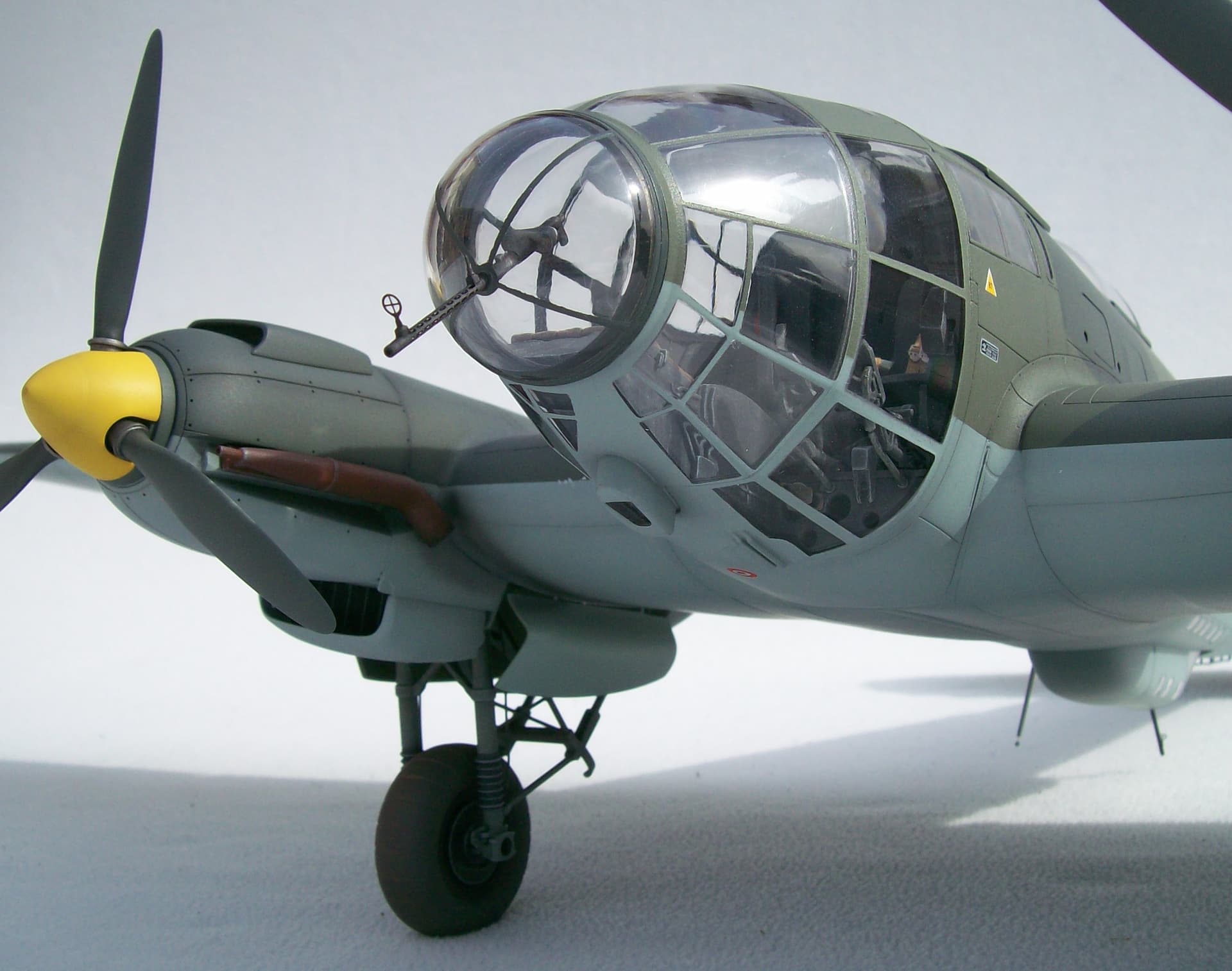

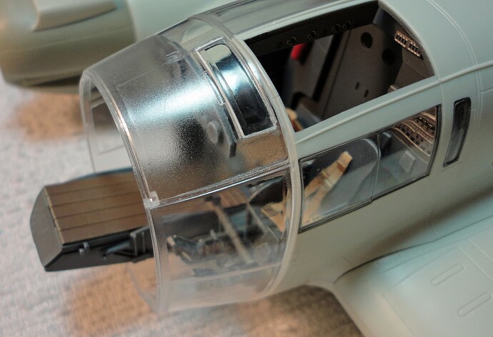

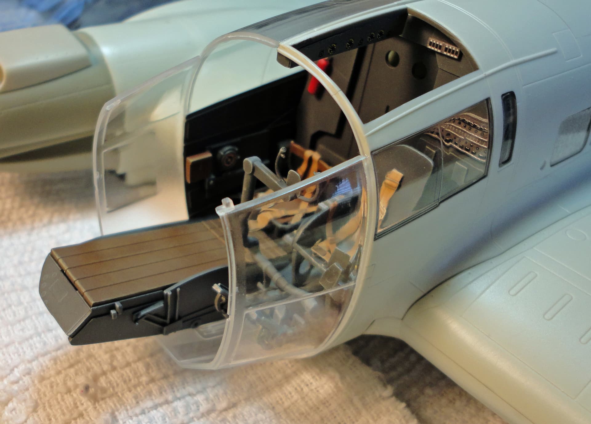

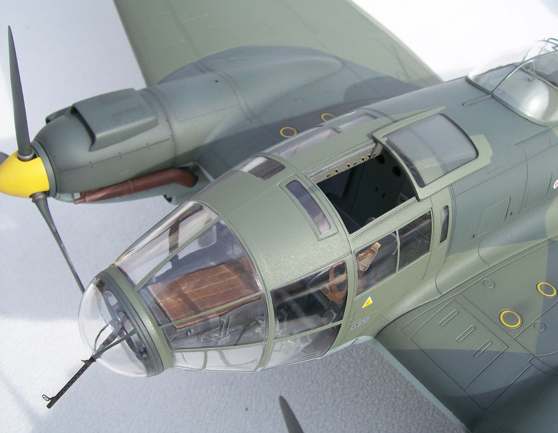

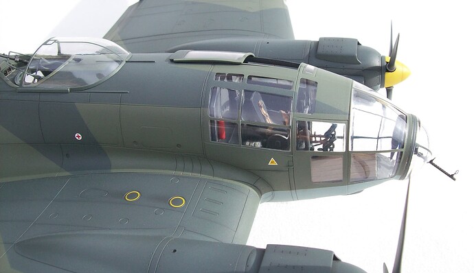

Very nicely done. Clear parts look perfect and crystal clear - I always think that makes a build so much better. Really nice build.
keavdog-Thanks for the compliment. I agree clean clear parts are critical. I have been happy with using Eduard canopy masks for many years.

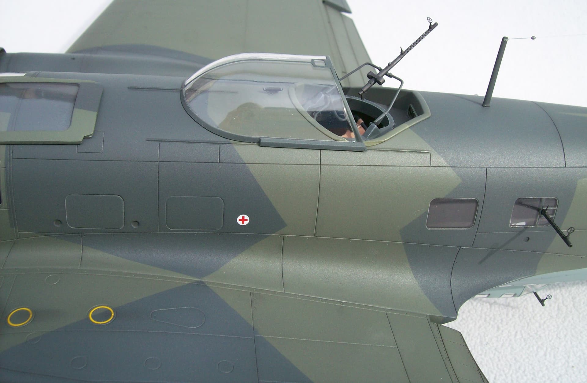

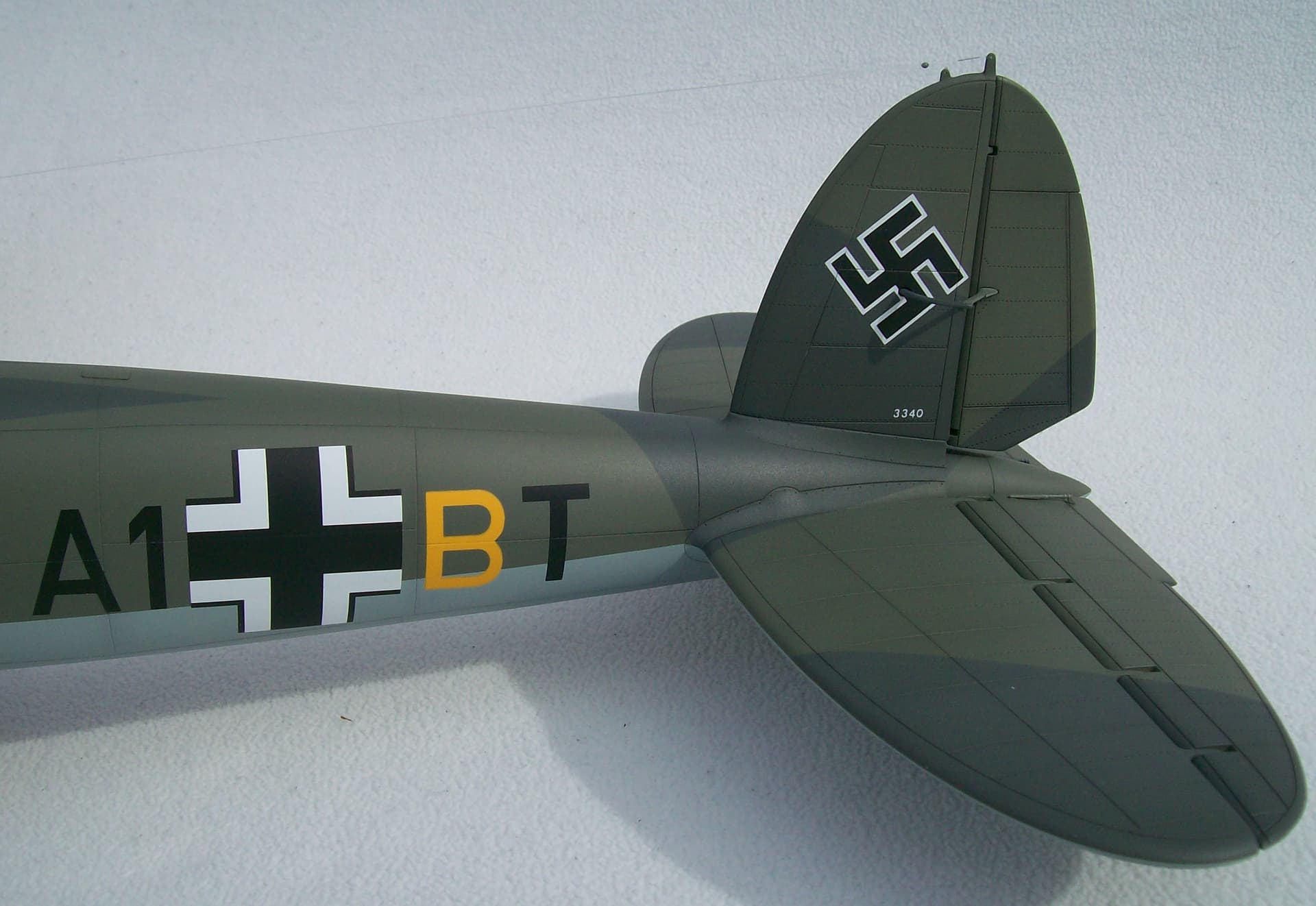

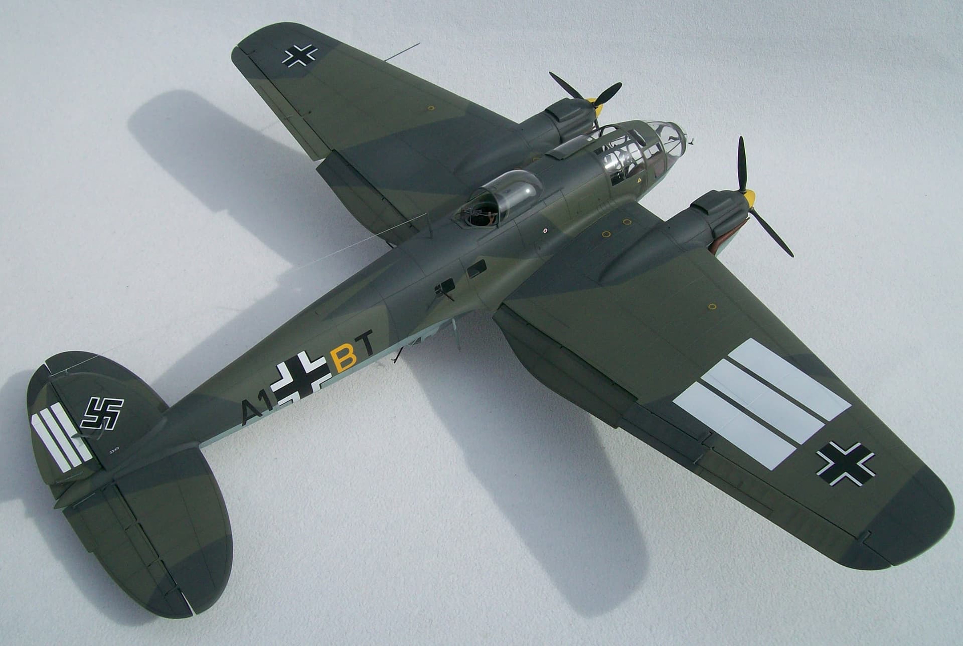

Great build. Very nice execution on the Paint job.. the canopies look stellar. Congratulations.
Cbowling-Thank you very much. The early war Luftwaffe splinter scheme is one of my favorites.

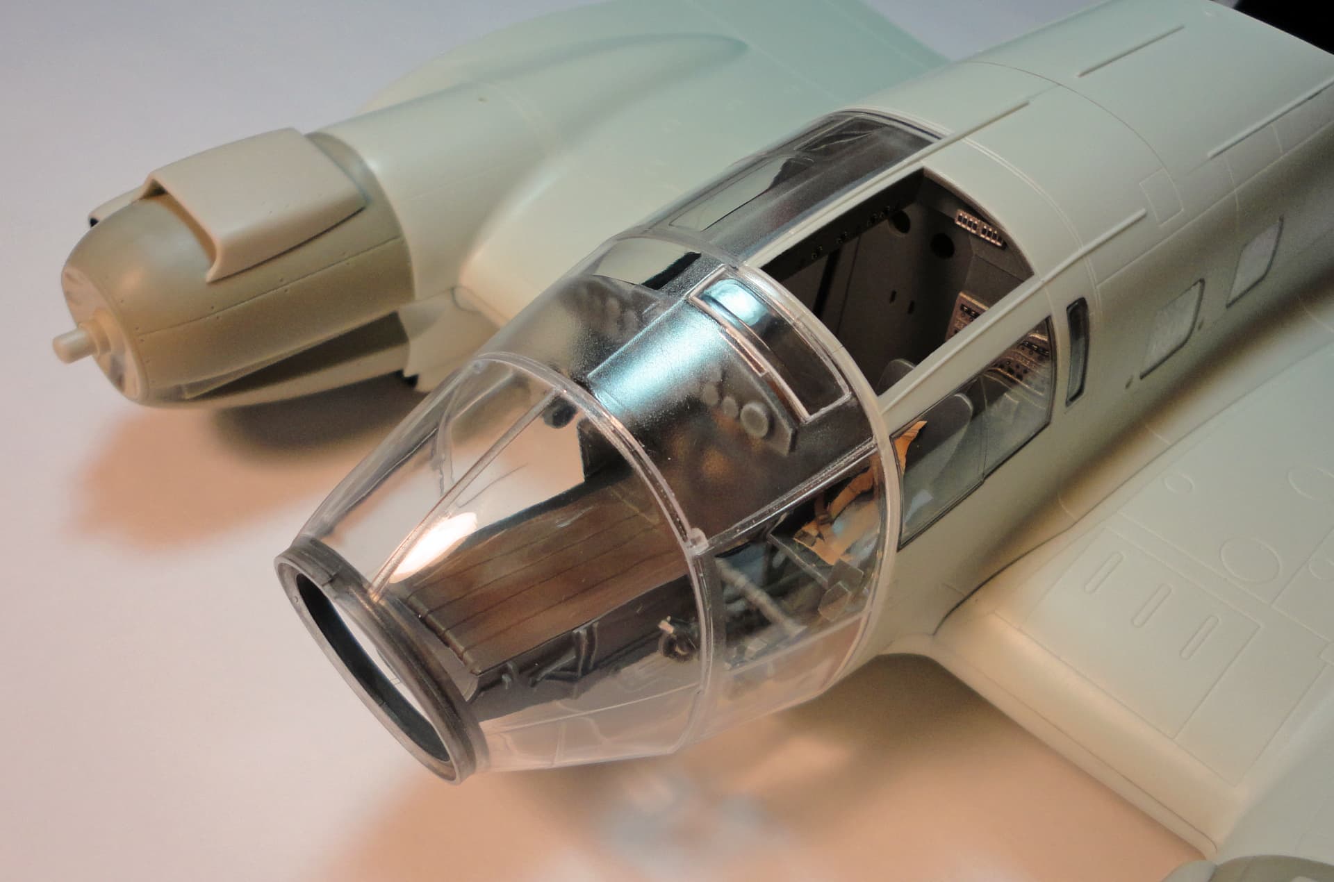

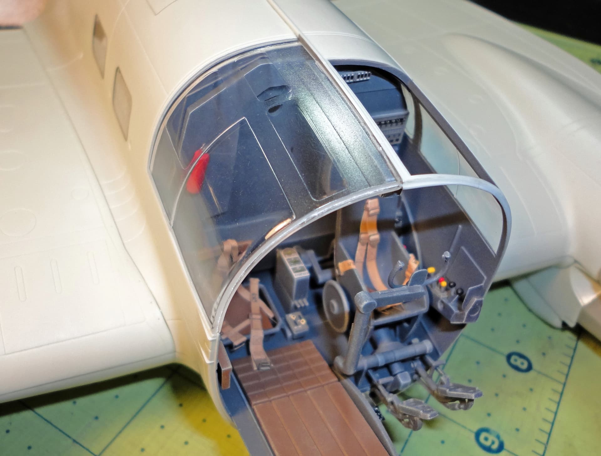

Wow really nice build, may I ask what you use for cementing your canopies, so clean I have to know :slight_smile:
jasransm-Thanks for the compliment! Most of the time I use White (aka Elmer’s) glue on most of the aircraft windows and canopies I work on. After it sets up, white glue has a surprising amount of strength.
On the clear five piece He-111 nose parts I had to have everything glued in place BEFRORE any painting was done, so a really strong glue connection was required. So instead of white glue I used very small amounts of 5-Minute Epoxy.

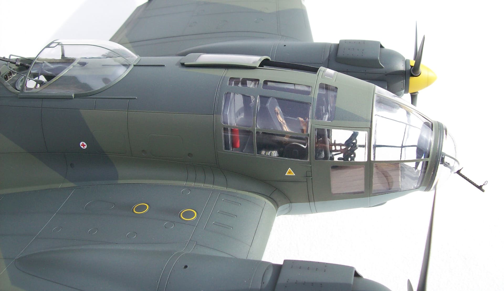

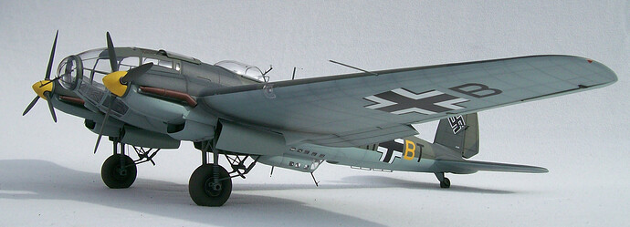

That “greenhouse” is so nicely done it looks like a 3D render!

Great build, the camo is perfect. Congratulations!
Tstabrawa-Thank you for the compliment!
