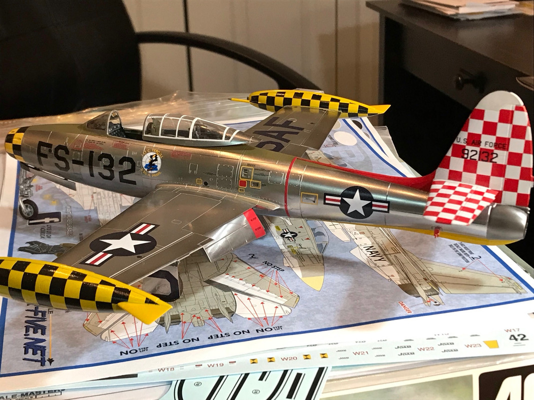

I have been using Future for over 20 years and have never had a cracking or yellowing issue. Future will go over anything, hand brushed or sprayed over flat paint. If used as an overcoat over a metallic finish, even though its gloss it will kill some of the reflectivity. AK has a product called Gauzy Gloss Enhancer that sprays on over metallics like Alclad and will not kill the reflectivity as seen on my F84.

Nice F-84, used enamel as the base?

Thanks. Base coat on the F84 is Testors gloss black enamel, polished out then Alclad was sprayed. The Gauzy product was sprayed to protect the Alclad from the masking tape used for masking. Decals are after market applied with Solvaset, no sealing coat was sprayed.
