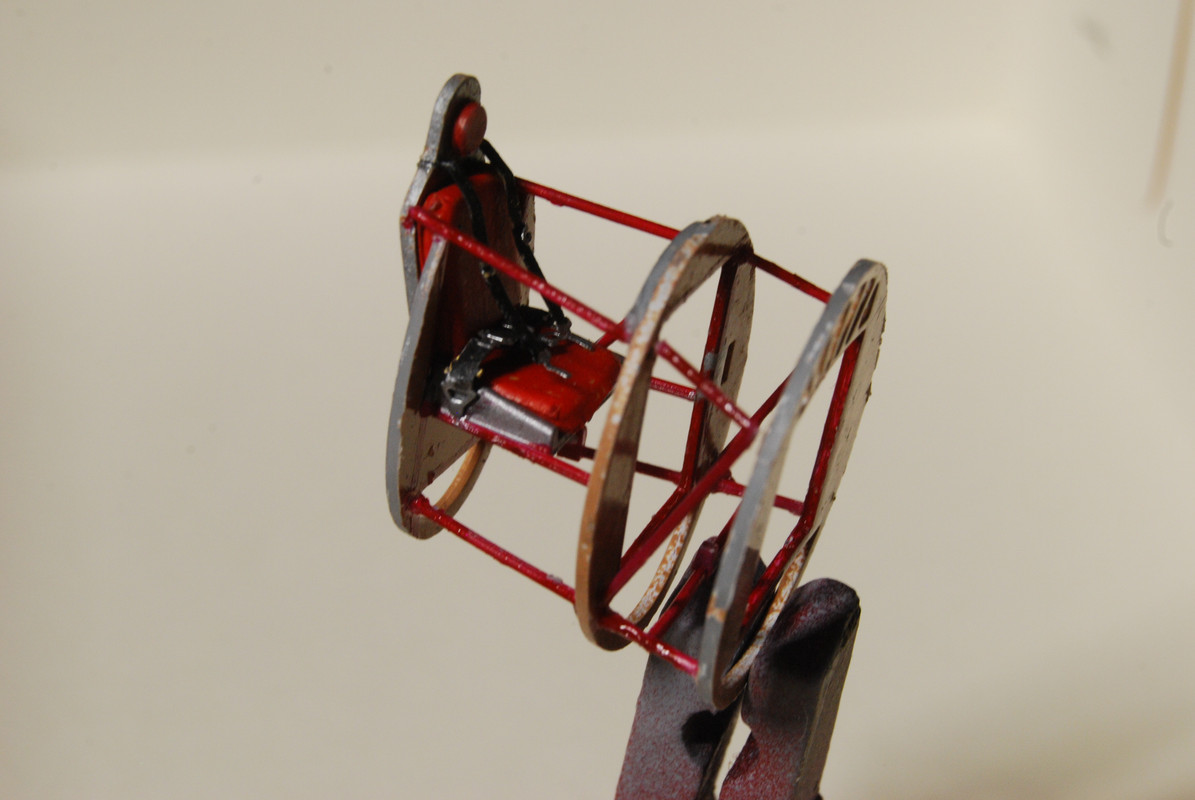

Started on the Dora Wings GeeBee. Given to me by a fellow modeler as an Xmas present. The kit is certainly detailed nicely, but the full size plane was not very large, so even in 1:48 this kit is a test of finger dexterity!
The cockpit detail includes the tubular framework. The longerons and braces are maybe 040, being generous, and there are several sections of longerons ending in dimples on the formers. The pins on the ends of the longerons are about 20 mil in diameter, and the same in length. I had a lot of sections fall off as I did the next section.

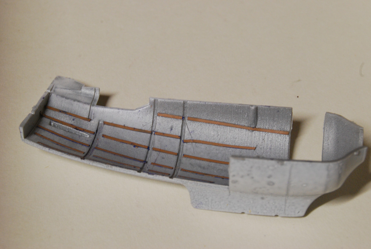

The fuselage does have the tubing frame and formers in the cockpit area, but not the stringers that fair out the covering to the section of the formers. These small stringers should be visible on the inside of the covering. I cut pieces of 1/32 trim tape and painted them Testors Wood. I had to cut the tapes a bit on the short side, since the formers fit into grooves in the fuselage sides with a very close fit (they’ll sure stay in place well, even if the longerons don’t.

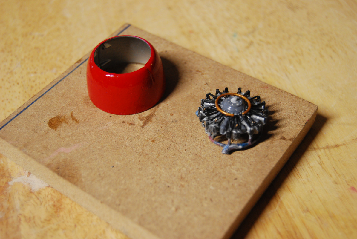

The cowl is done and ready to install, as is engine. That engine came out real nice. I did add plug wiring.
Nice job Don. That’s a little thing.

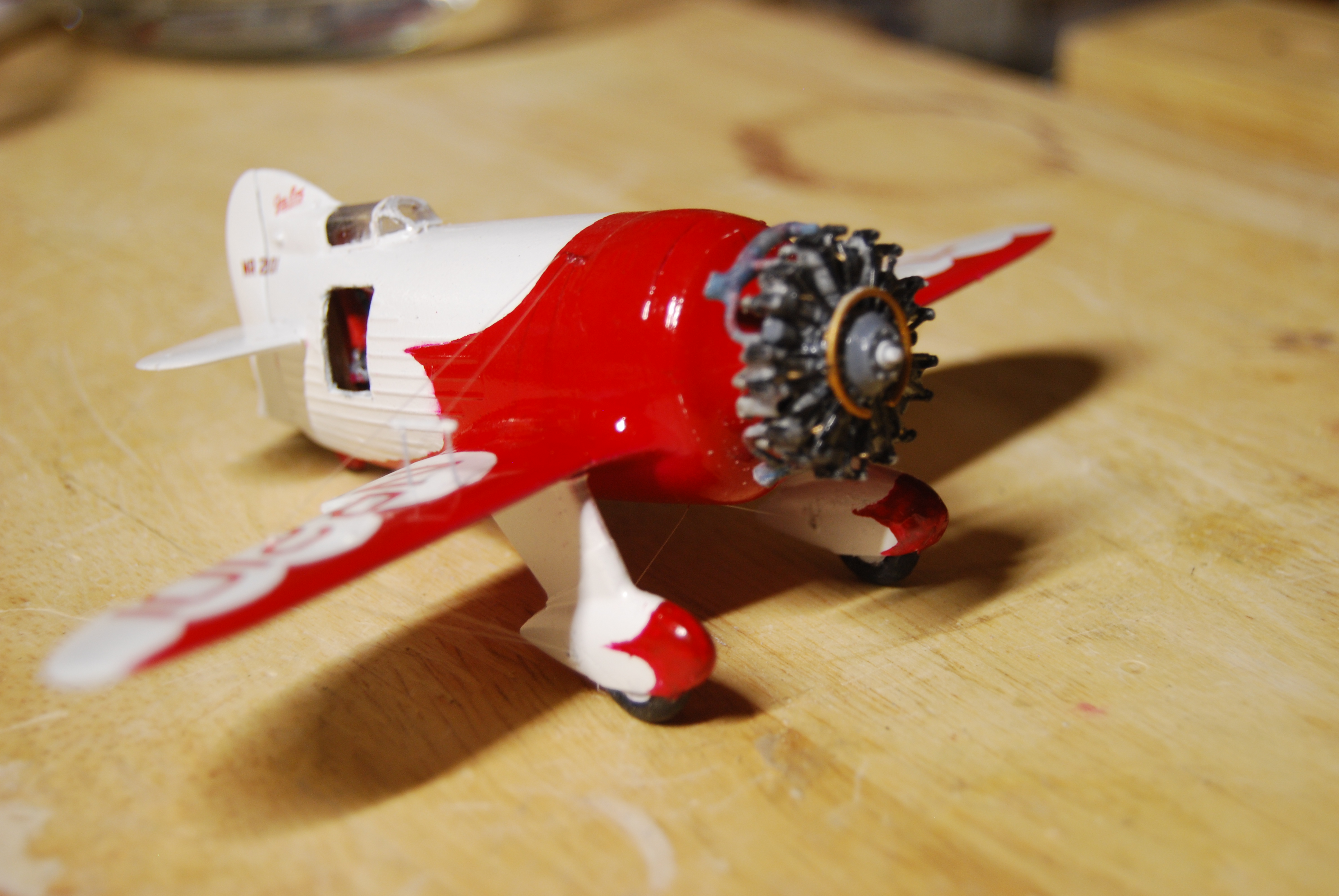

Got the red on.I applied tape to the areas to be masked, then used the kit masks to cut the tape. l I had some leakage around front of wheel struts which I will have to touch up. l also did not mask the wheel pants- the curvature is just too great for masking tape to stick well, so I will hand paint the front of the pants.

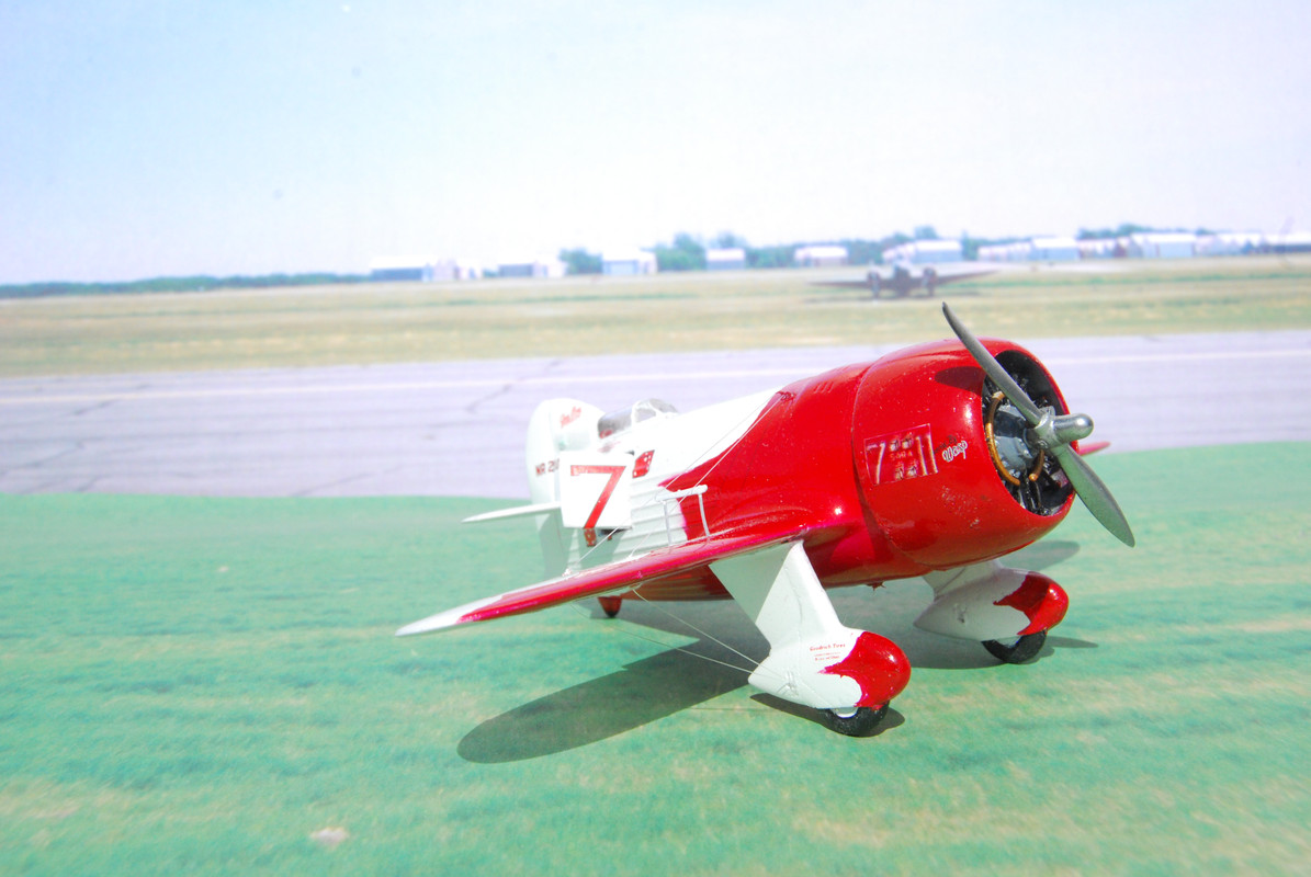

Got the rigging done. Used fine monofilament. Job was easier than I expected. Not very visible, so you may need to click on picture for a larger image.

very nice Don! I have always wanted to build one of these.
Looks good Don. I think I’m going to stick to 1/32 for this bird, if only to help with the pinstriping.
Great job Don.
I did not do the pinstriping. When looking at photos with about the same viewing angles as a scale viewing distance I could not see the stripes. 32nd scale may be different.

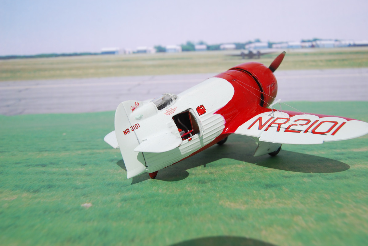

Finished!
Looks good, Don. I would imagine that unless the pinstriping were perfect it would detract rather than add to the model. And white is aalmost as unforgiving to work with as natural metal if you try to fix goofs. Maybe a decal for the black would be easiest.
That really came out great. Still not sure how that thing flew.
