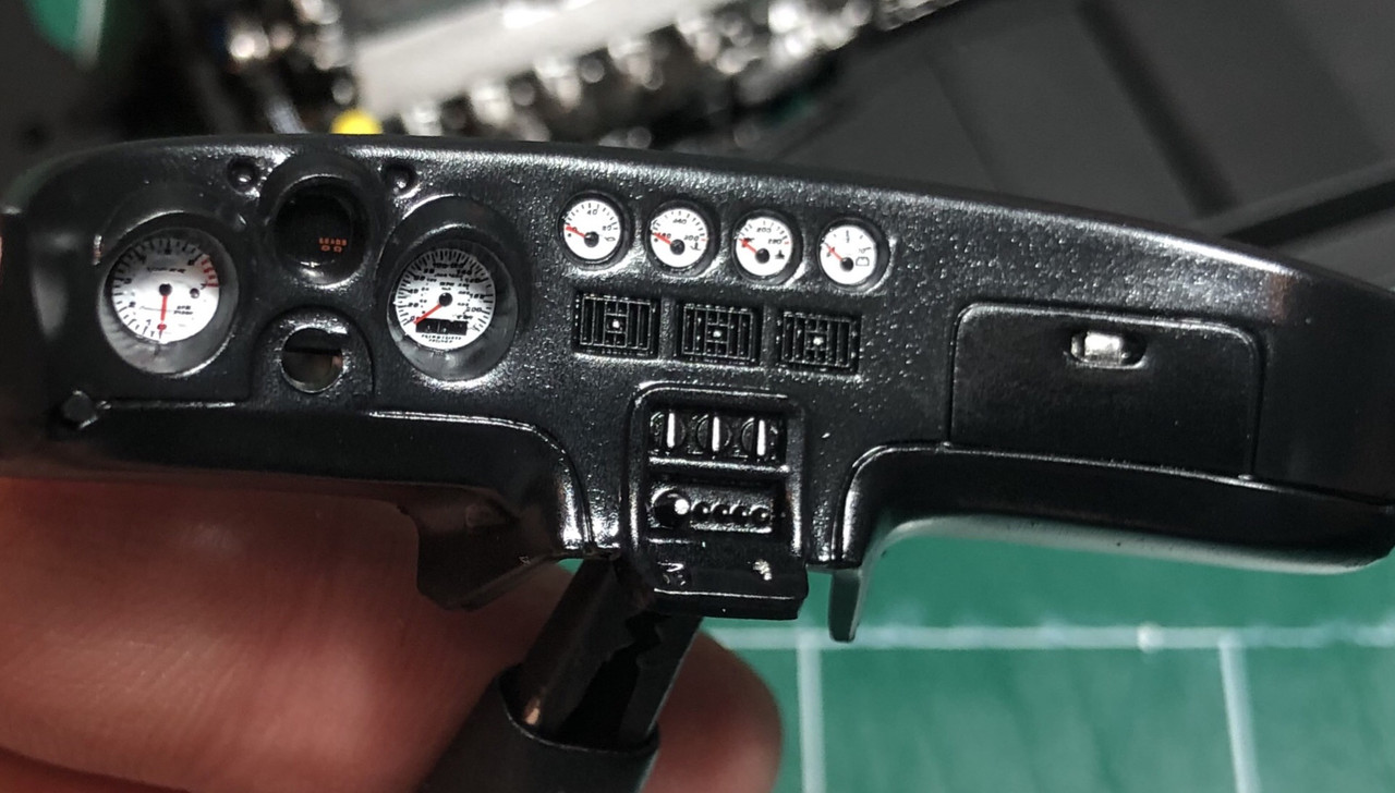

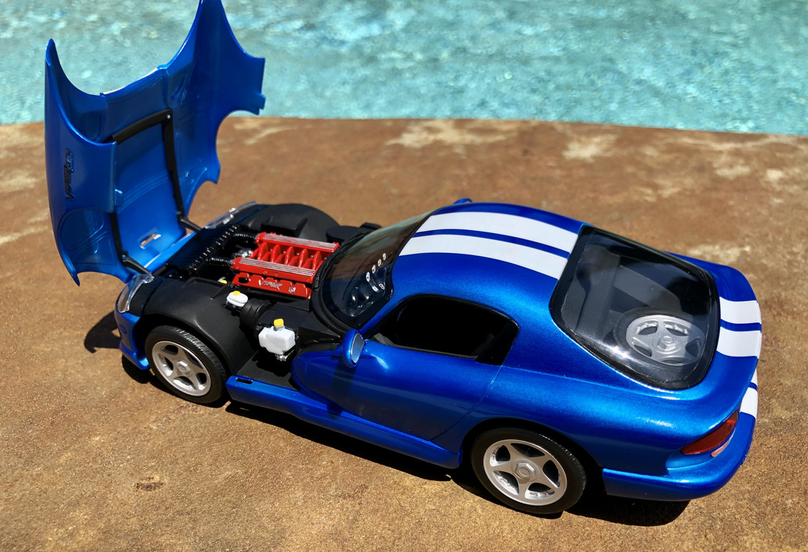

Here’s a Viper I did a while back. The engine was painted without the use of any type of clearcoat. The dash was painted and I gave it a shot of satin for a subtle sheen. The body of course received a few coats of gloss. So the only clearcoat applied was to the body, dash, and seats. No clearcoat was applied to any of the chassis components either. Typically when it comes to aircraft, the only time I ever apply any kind of clearcoat is a coat of gloss before I lay down the decals then a final coat of flat.
