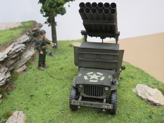

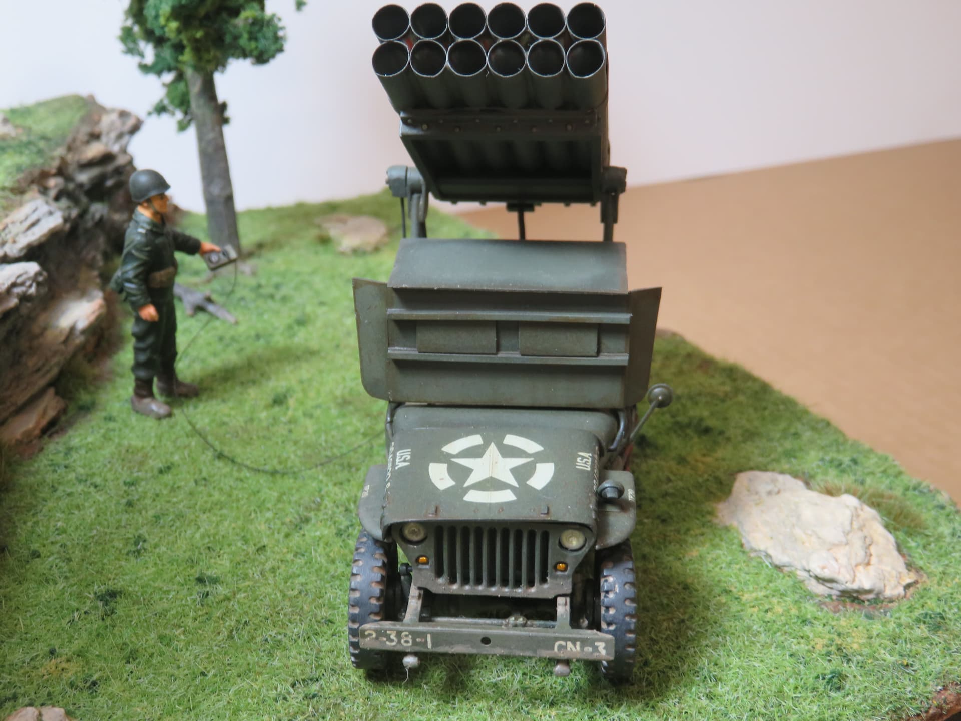

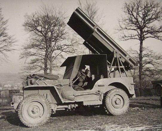

A jeep-mounted rocket launcher of the 2nd Infantry Division, 38th Infantry Regiment Cannon Company, fires a salvo toward Hill 192 to clear the approach to Saint-Lô. A jeep of the 2nd Infantry Division, 2nd Cavalry Troop, Reconnaissance Company, equipped with a 0.30 calibre machine gun provides protection to the rocket launcher.
Construction of the rocket launcher equipped jeep started in the late 1970s using the Tamiya U.S. Jeep 1/4 Ton 4X4 Truck Willys MB, Military Miniature Series No. 15 (1972). Construction stopped for university, career, marriage and family. Retirement allowed construction to be resumed some 38 years later. I added 52 pieces of photo-etch and 137 scratchbuilt parts, primarily for the rocket launcher. It took about 30 hours to complete the build and 19 hours to paint, decal and weather. In total about 49 hours.

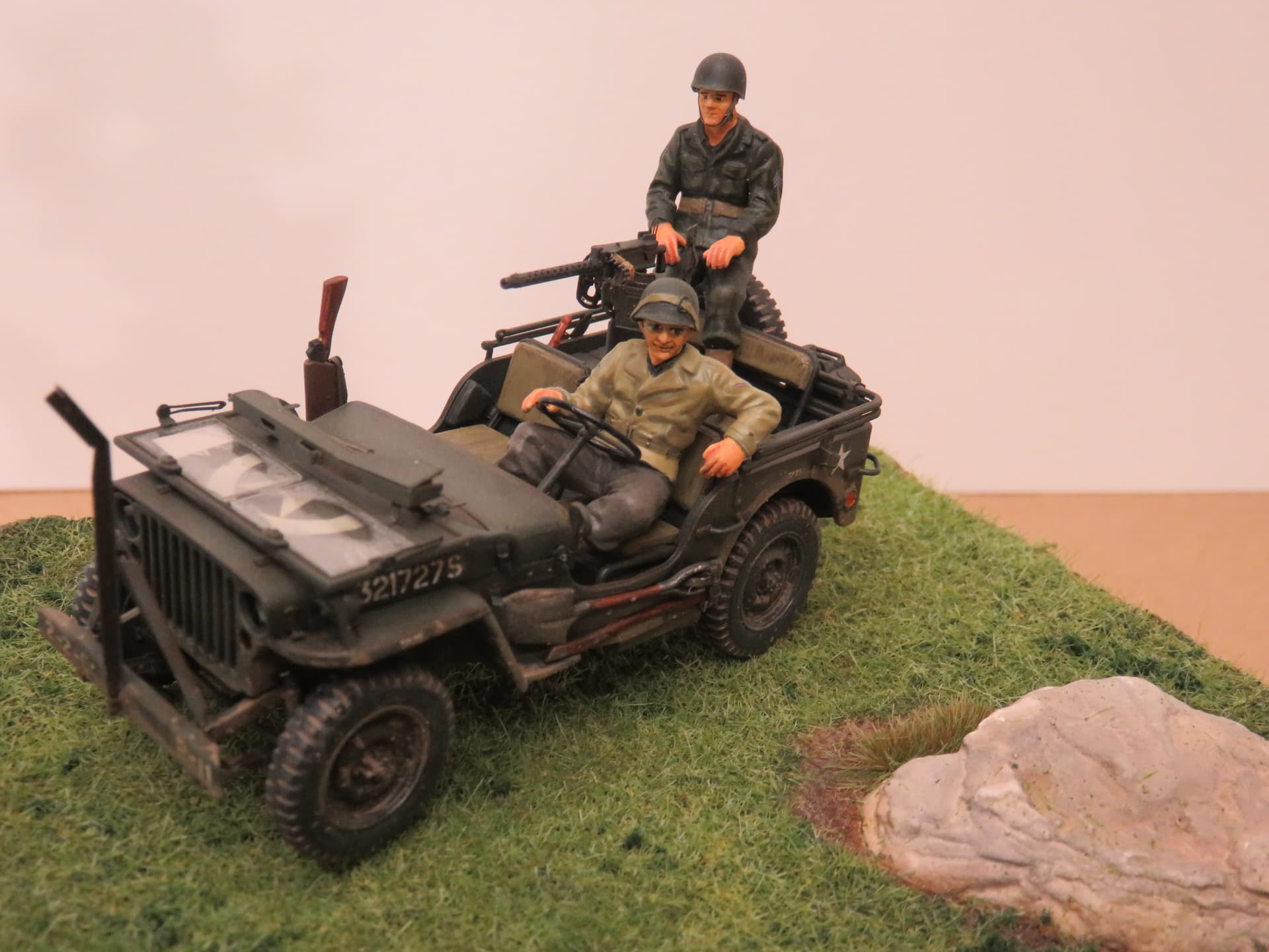

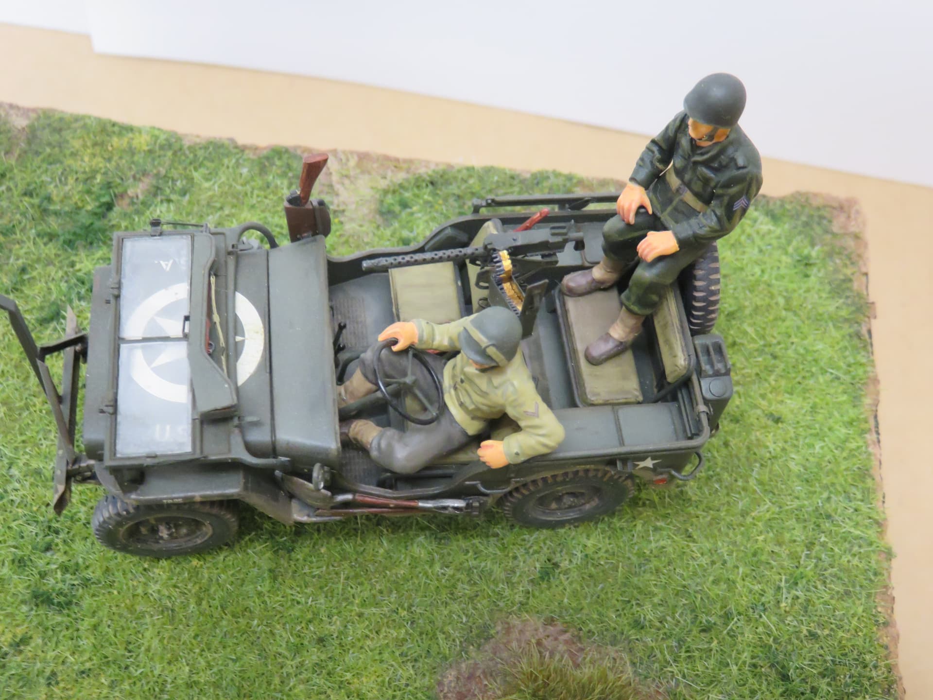

The second jeep is the Tamiya Jeep Willys MB 1/4-ton 4X4 Truck, Military Miniature Series No. 219 (1997) which is a marked difference in level of detail from the original kit. The driver is from the kit, while the machine gunner in the back is modified from the 1972 Tamiya Jeep kit. This jeep took about 49 hours to complete including 29 hours for construction, 20 hours for painting, decals and weathering.

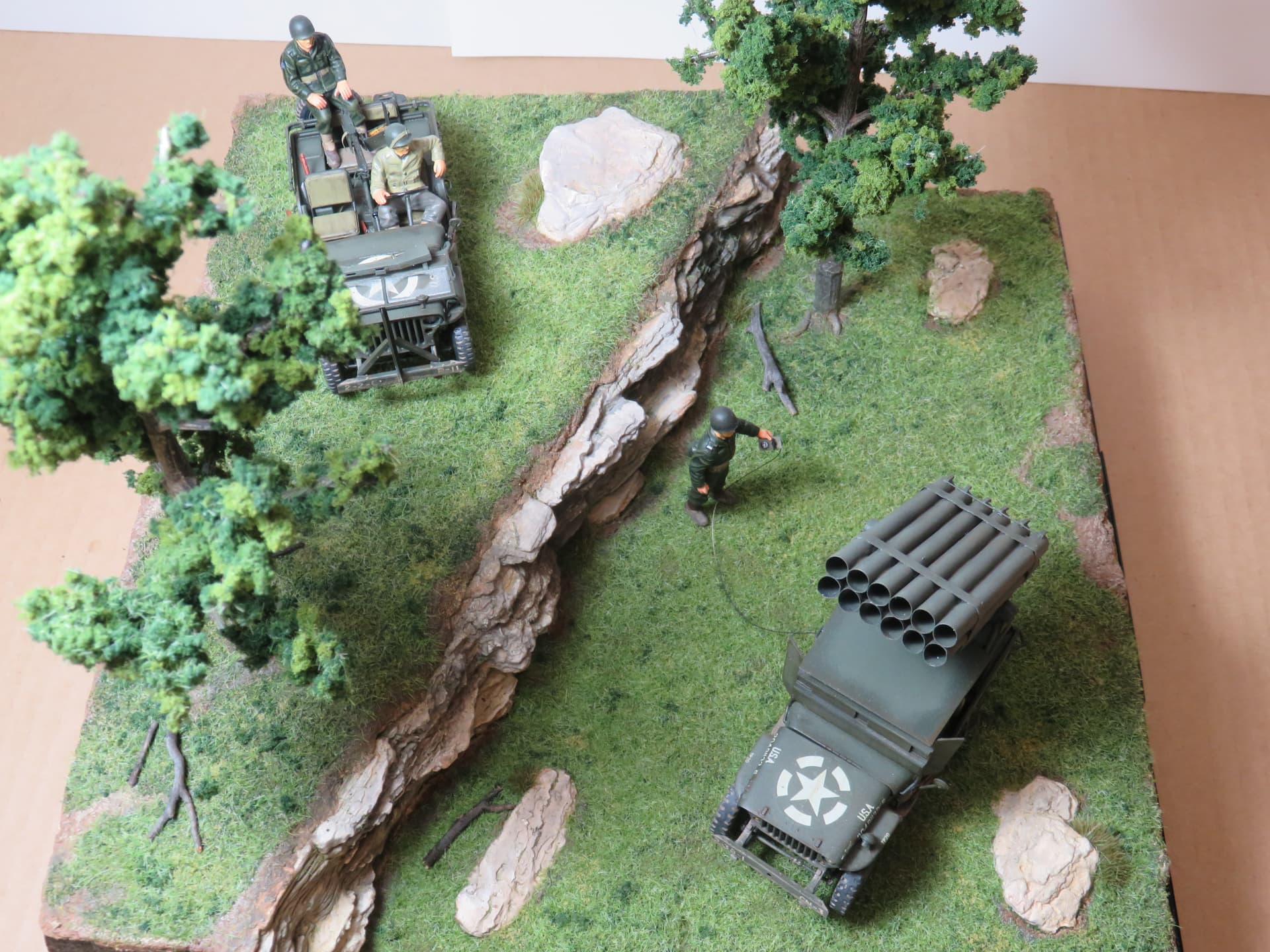

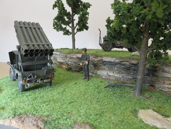

The terrain is built on insulation foam glued to a plywood base. Fastmache mixed with Liquitex Basics Acrylic Burnt Umber provided the ground work. Woodland Scenics Shelf Rocks, Surface Rocks and Tree Armatures were embedded in the Fastmache while it was still wet. Once the ground work was dry it received a further wash of Liquitex Basics Acrylic Burnt Umber, followed by a wash Liquitex Basics Acrylic Raw Umber and drybrushing with Tamiya XF-52 Flat Earth, Tamiya XF-78 Wooden Deck Tan and Tamiya XF-81 Dark Green 2 (RAF). The Woodland Scenics Shelf Rock received highlights and shadows using Tamiya XF-57 Buff, Abteilung 502 ABT006 Burnt Umber, Abteilung 502 ABT007 Raw Umber and Abteilung 502 ABT110 Black. The base for the grass is Woodland Scenics Blended Turf Green Blend T1349. Over this base, a blend of Woodland Scenics Fine Turf Yellow Grass T43, Fine Turf Burnt Grass T44, Coarse Turf Dark Green T65 and Vallejo Mixed Green Wild Tufts were added. Finally, a blend of Woodland Scenics 2mm Light Green and 4mm Medium Green Static Grass was applied using a Static King applicator.
The trees are Woodland Scenics 7” armatures were twisted and pruned to shape. After priming with Tremclad Rust Paint Flat Grey Primer the trunks and branches received a washes of 502 Abteilung ABT005 Smoke and 502 Abteilung ABT080 Brown Wash. This was followed by successive drybrushes of 502 Abteilung ABT 092 Ocher, 502 Abteilung ABT245 Sand Brown, 502 Abteilung ABT035 Buff and 502 Abteilung ABT094 Green Grass. Once painting foliage was added using a mix of Woodland Scenics Bushes (Light Green FC145, Medium Green FC146, Dark Green FC147). Once planted, tree roots were added with Milliput epoxy putty which were then painted to match the trunk. Dead branches were added at the base of trees using Woodland Scenics Deadfall Branches.

Congratulations on finishing after 38 years. I know I’ve got a couple of those not finished yet. The work on the rocket jeep looks pretty sharp. It’s always hard to build something like that with limited references. Good job.
Beautiful work. You did a great job in the project but the historical aspect is off. The US Army wasn’t fielding this sort of rocket artillery until late 1944/early 1945, long after the breakout from Normandy.
Agreed. I did not research the history of the jeep rocket launcher before completing the diorama. Given that they are the result of field modifications it makes sense that the need for a jeep mounted rocket system was the result of experience up to the Normandy Breakout and probably given the experience of facing the German Nebelwerfer during the Normandy campaign.

Interesting subject. I wasn’t aware of this - though I suppose everything was done with a Jeep. Must have been a wild ride if you were to sit inside the cab during launching!
I found the picture in the old Ballantine’s Illustrated History of WW2 Weapons Book on the Jeep. I did not do a lot of research on how the rocket launcher jeep came to be, but I did find somewhere that it was standard practice to not sit in the vehicle during launch. I would imagine that on occasion the outcome of launch might be unpredictable. Thanks for looking in!
These rocket launchers were also mounted on Sherman tanks as the T34 “Calliope” and on the back of 2 1/2 ton trucks as the T27 series. I do believe that western Allied forces first encountered the Nebelwerfer in the final phases of the North Africa campaign in Tunisia. then later on more so in Italy, quite some time before Normandy.
