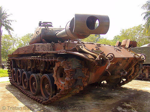

Even with a lengthy exposure, you may have over done the weathering. It appears the photo below is an ARVN tank at Cu Chi, VietNam. The photo in this linkappears to have been taken in 2005, 30 years after the fall of Saigon.

Here’s the front of that tank:
Note that in your picture, the exhausts have been pulled, so the engine may be gone as well. The tail lights are also gone. In the second picture, you’ll note there are no gerry cans or straps for them in the holders. In the picture I posted of the same tank, the headlights have been removed, the fender brace on the right side of the picture is damaged, Of interest on that site is the person identifying the tank does not know thge front from the rear of the vehicle.
