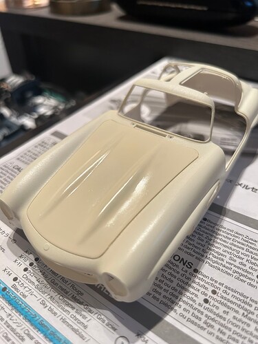

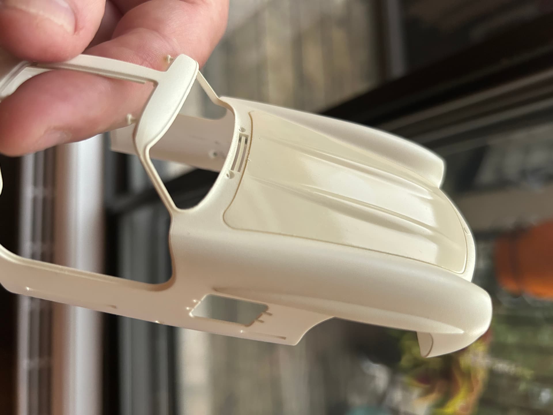

I just painted my body shell, and yet, using the same primer and the same number of coats of TS-7, look at the difference: a beautiful glossy finish on the hood versus a matte, slightly grainy finish on the body shell! Note that I used a different can of paint (but still Tamiya TS-7)… Does anyone have any idea what happened?
Hey @grosplante welcome to the forum! I can’t explain why there is such a difference, but you have several options to try and address the problem. You could try lightly wet sanding the grainy paint finish with a very fine grit finishing sandpaper 2000 grit or even higher. that may even them out. A gloss sealer can be applied as well. I have also used floor wax to seal and shine finishes. You could also strip off the paint and respray with one can for the entire car.
It looks like a great subject though. That is a very cool car. Good luck with this one. Let’s see what some our forum colleagues think.
Hello! Different can of paint is most obvious here - they probably sat on the shelf for a different spans of time, right? But then there are other factors - like how good the paints were mixed before painting. Then you can also have a difference in ambient temperature - affecting both propellant gas pressure and paint flow and atomization. Really lots of factors here.

Thanks for taking the time to reply and for all the suggestions! I really appreciate it.
I think I’ll try lightly wet sanding the grainy finish with 2000+ grit first and see how it turns out. I’d really rather avoid stripping the whole thing and starting over if I can. :sweat_smile:
And yes, it’s a pretty cool car! I’m enjoying the build so far, despite this little paint mystery.
Thanks again for your help!

Thanks Paweł! You may very well be right about the different cans. I hadn’t really considered how much the age of the paint, temperature, or even how well it was mixed could affect the finish.
There are apparently a lot more variables involved than I thought! I’ll definitely keep those things in mind for the next coat.
Thanks again for taking the time to explain it, and good luck with your projects too!
