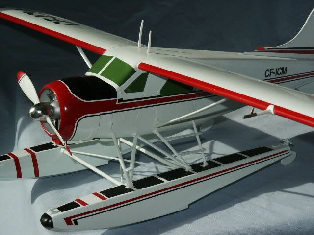

I built this kit awhile back. I added some of my own details like the water rudders, pitot tube and flap controls. I didn’t feel like cutting out the windows and doing all of the interior work. I’ll post a couple of pictures of my build.
gbritnell

Very fine work. Thank you for the pics. They are very helpfull. And they show me, that I will need a lot of time for an exellent model.
