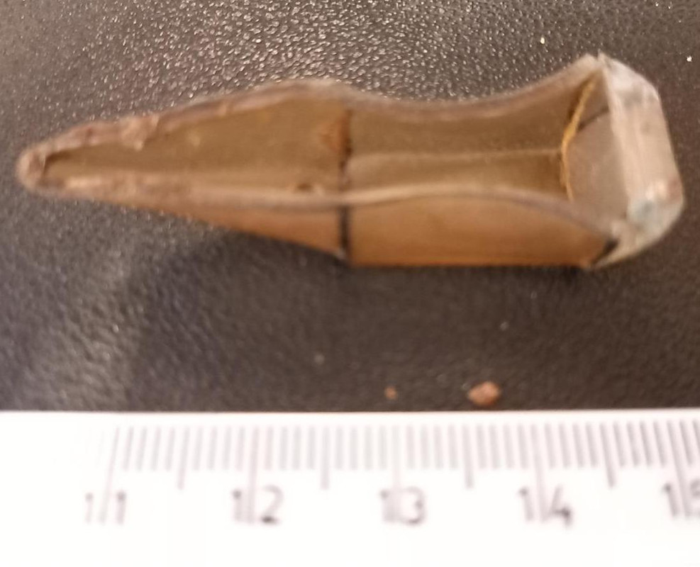

I’ve started dismantling the first of the models that I inherited - a Hawker Typhoon Mk.1B. It’s a real mess, although some of the features are fascinating. It’s very roughly 1/40th scale. The canopy has yellowed a lot over the last 75 years or so, which I suppose isn’t a massive surprise, but it has deformed a lot as the picture shows - this is a surprise. Any suggestions on how to remove the yellowing and massage it back into shape?
I think a replacement canopy is in order.I think Falcon makes one.
What kit is it from? You can find replacement canopy through aftermarket companies or kit manufacturer.

Another possibility would be to carve a new one based on what you have there, and smash mold a new one.

Phil, it sounds like an odd scale so I doubt there’s a Falcon etc. canopy available.

Smash mold perhaps.

I think maybe at one time it sat too long in the sunlight? I’d recommend making a new one, too. What you need is the positive form here - that is, like GMorrison and Philo wrote - shape of the canopy made of wood or plaster of paris, slightly smaller than the intended canopy by the thickness of the material. Then you heat plastic sheet and “wrap” or “pull” it around that form - and you have a canopy, ooking like a vacu part, ready to be cut out and installed. My tip is to cover the form with liquid soap for release agent.

Or stored too close to the furnace-room in a brother-in-law’s house?

If the model is as old as I think it is, it may have been of the type that had acetate clear parts and powdered glue.

Thank you all for the replies. It’s definitely not a flying model, just static display. It could well have seen too much sunlight in the past - it was used as a toy by my cousins for some years before it was rescued, so the whole thing is pretty badly damaged and it’s going to be a long haul to get it anywhere near presentable.
If anyone can point me at a guide on how to do this smash moulding, that would really help. Is that likely to have been a technique that would have been used with the materials that were available 75 years ago?

I think you may be right. If ,that’s that’s the case The Acetate can be dropped in Very hot water and very carefully almost brought back to shape. Enough to make a new master!
