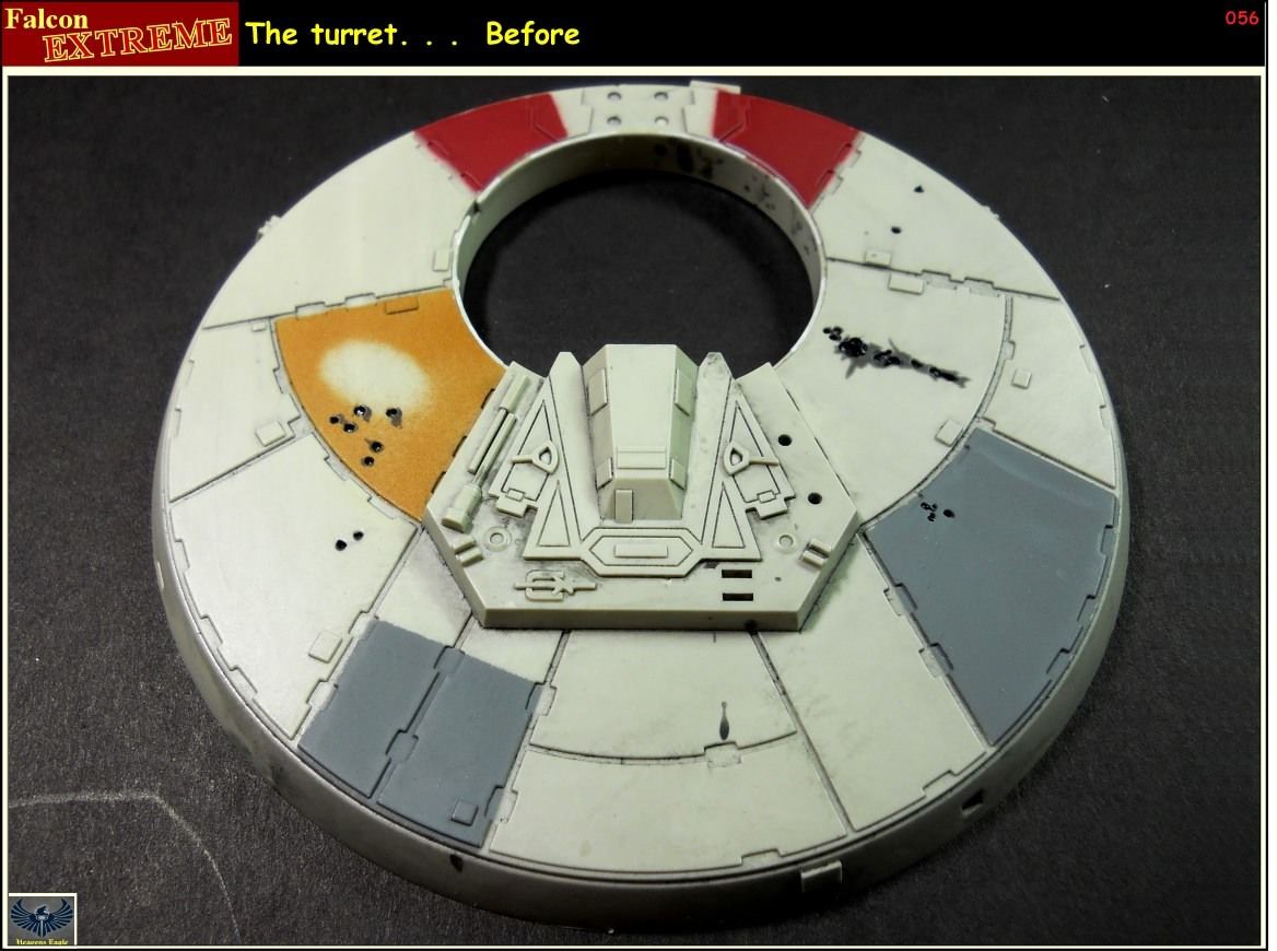

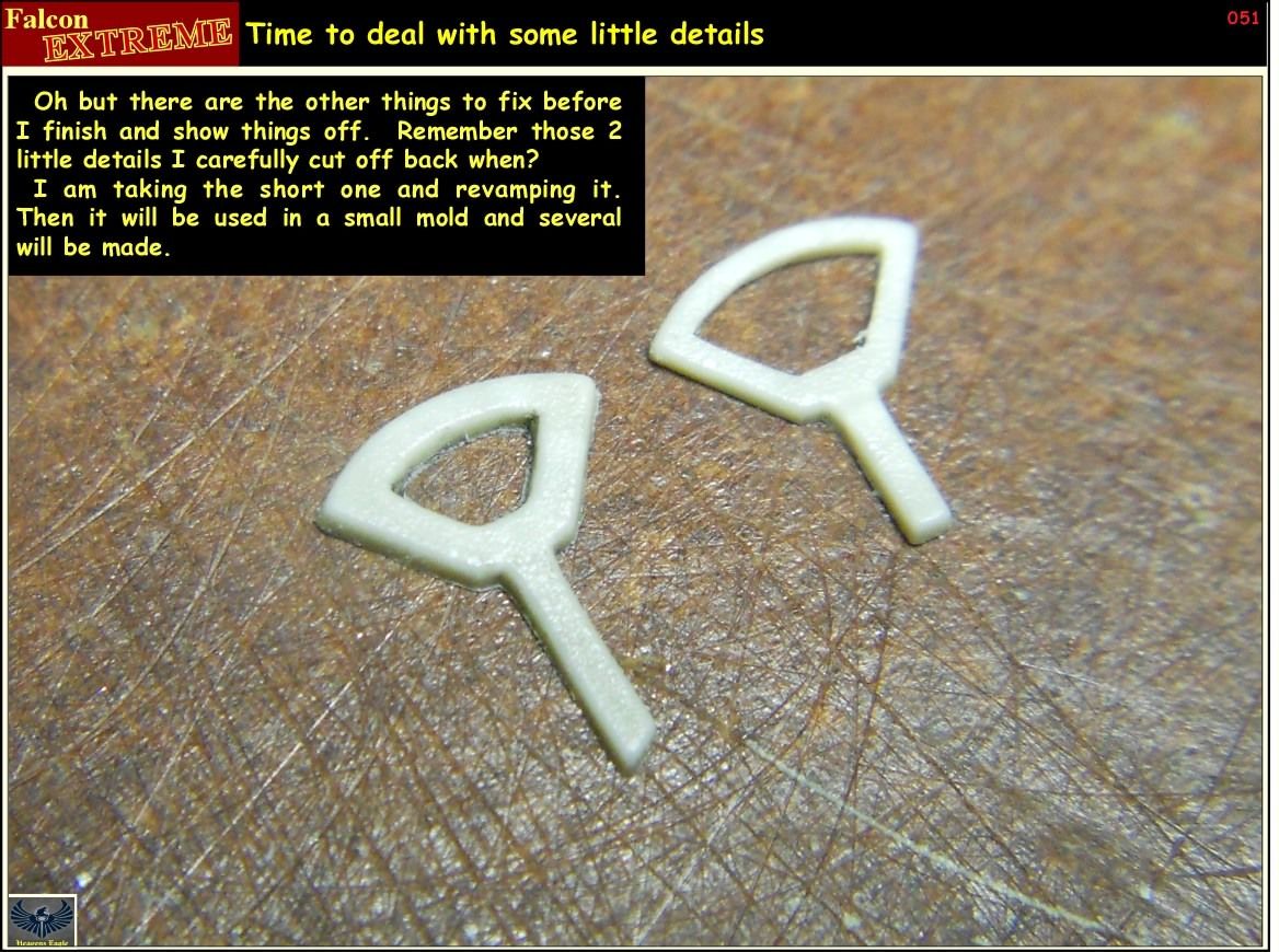

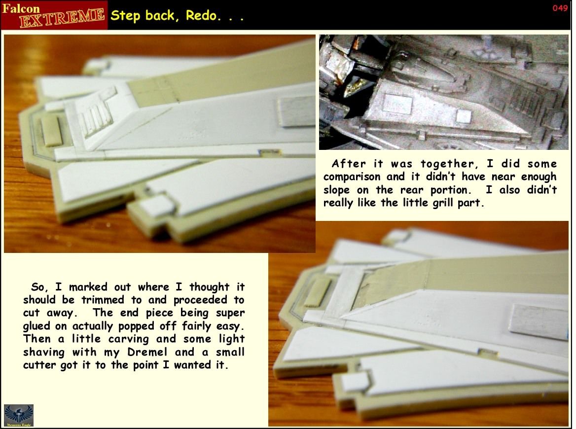

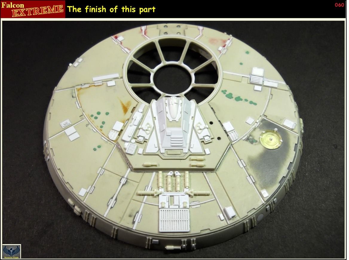

Time to post some more modeling goodness. Or in other words, show how far off the deep end I am sliding on this build. [:|]
On with some more EXtreme Falcon!
To be continued…
Here is the rest leading up to the finish of the top side turret TP-3.
Till next time sports fans! Same bat time, same bat channel!
