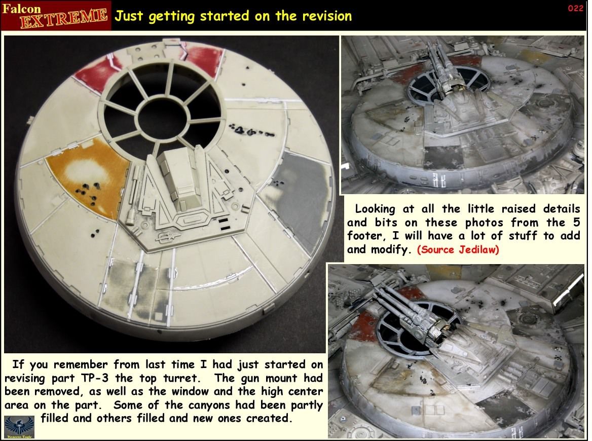

There is the start. I like to do a small start with some basics. I have more that will be posted in the next few minutes. The amazing stuff will be a little while yet. I just finished a massive rework of the top turret to make it appear much more like that on the 5f. Normally I won’t post a photo of stuff that far down the road but in this case I suspect all of you would love a teaser. (and I can’t resist)

Here is the first installment of my EXtreme Falcon modificatins. Part TP-3 is going to get a thorough revamp by the end of this session. There will be several more installments on this modification session. Please let me know what you think. While I know this is supposed to be “The 32 inch scale replica” , it is just too clunky and blah compared to the detail found on the 5 footer (5F from here on)

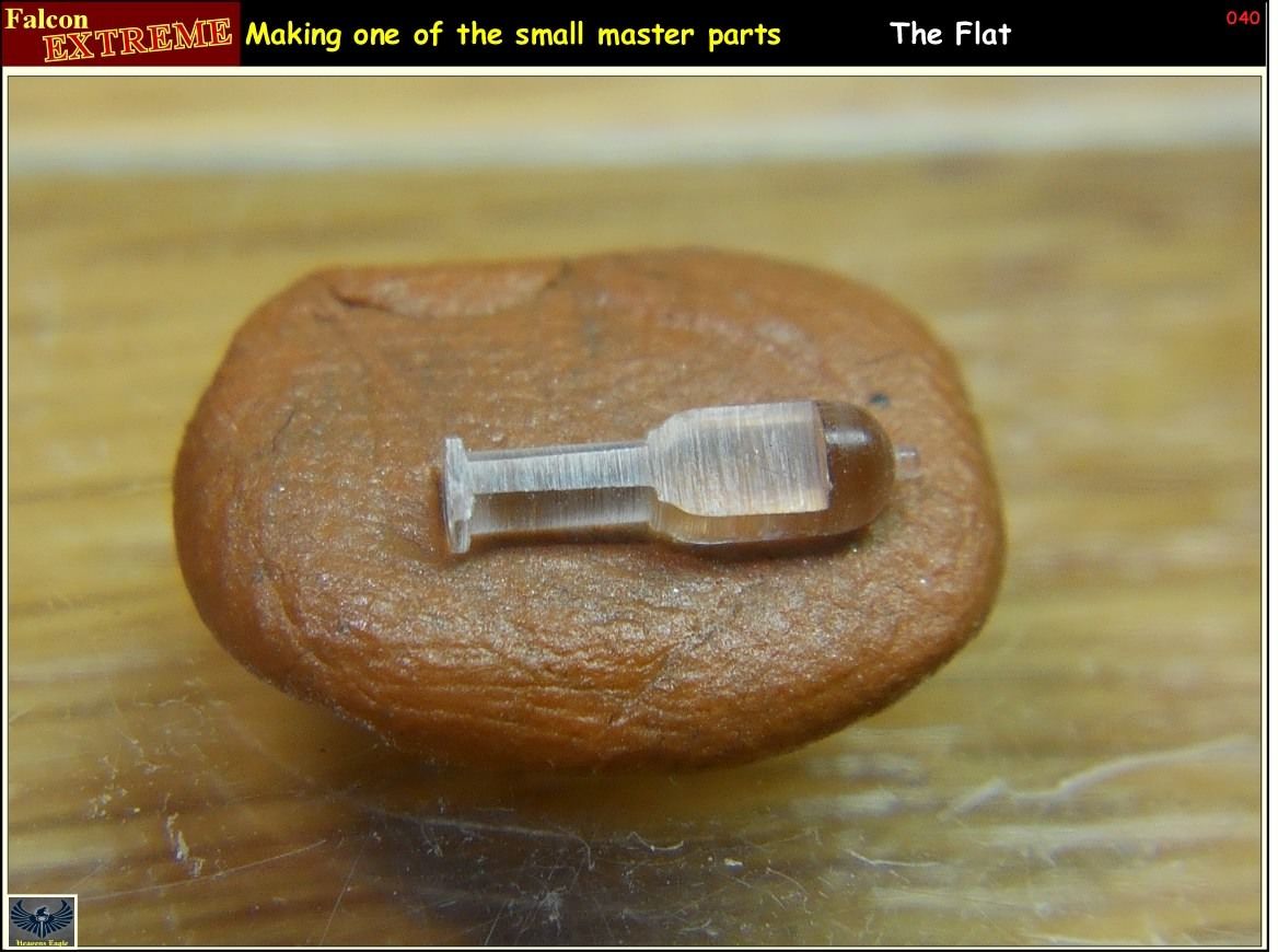

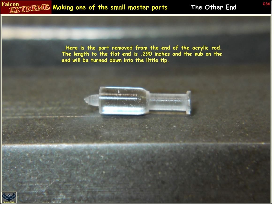

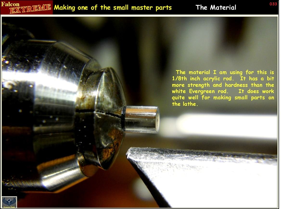

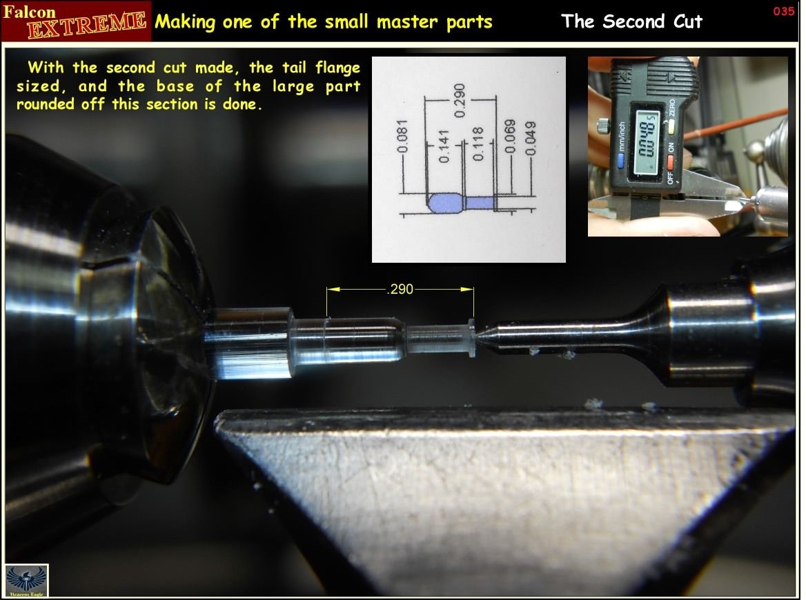

OK then, Here is part 1 of the next EXtreme installment. Using a rather old Dremel drill press, I set it up and use it as a cheap milling machine. Can’t do that with the newer designs. Who ever said that new was better!
Here ends part 1, stay tuned for part 2.

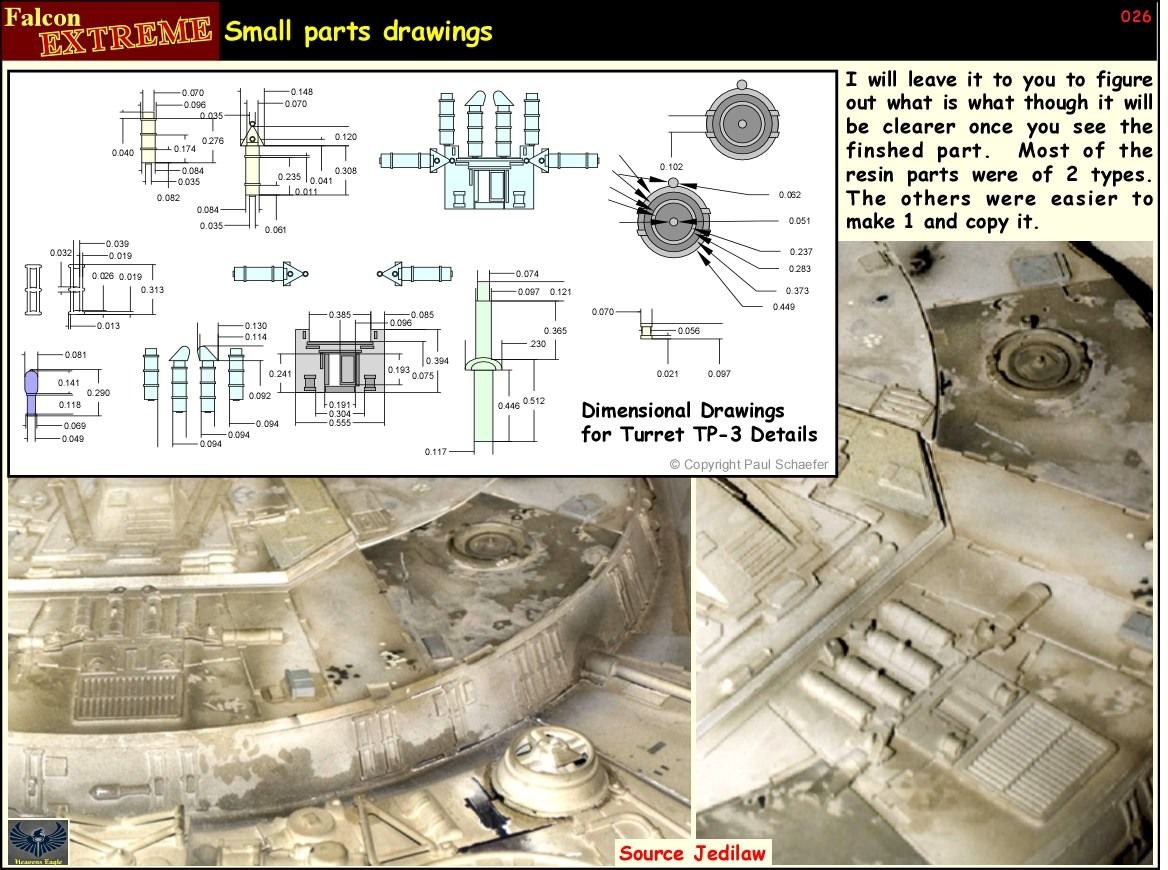

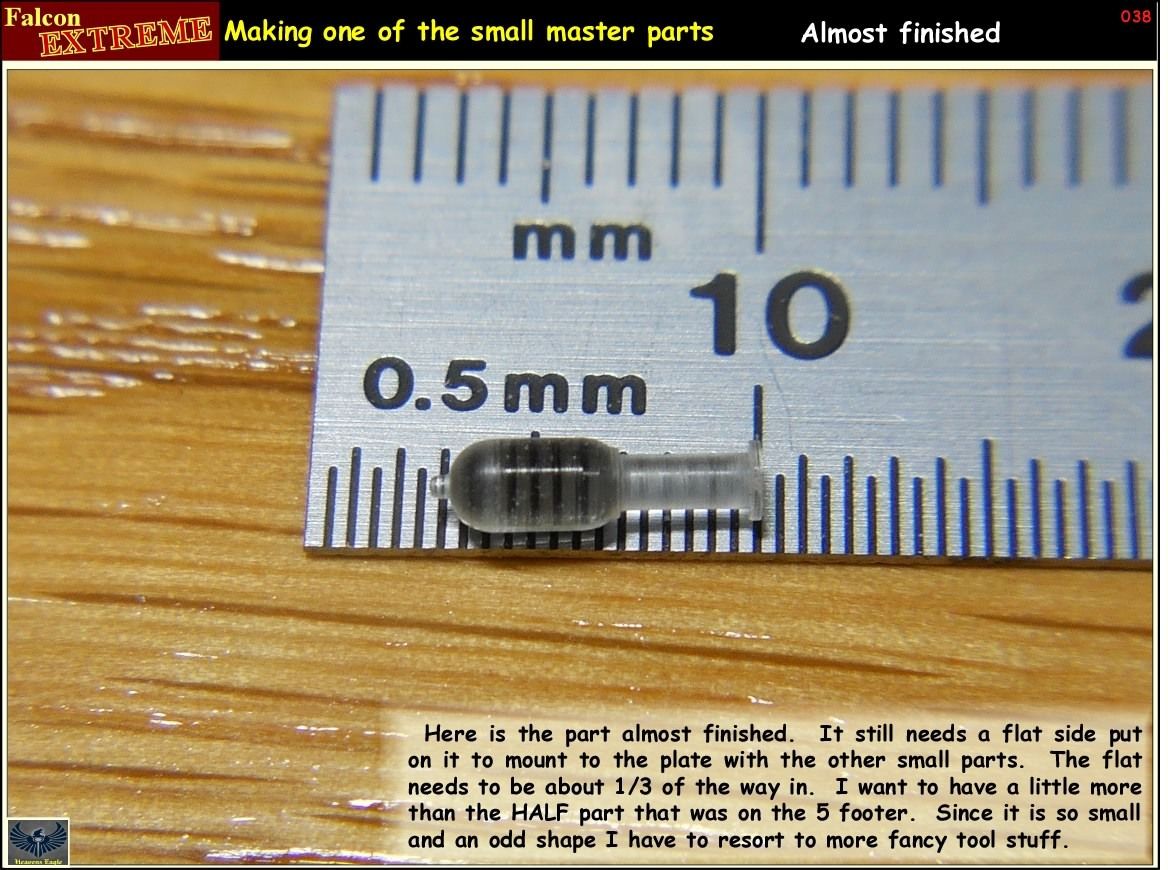

Here is the next installment on the EXtreme part of the build. In this I am still changing the part TP-3 to something resembling the part on the 5 footer.

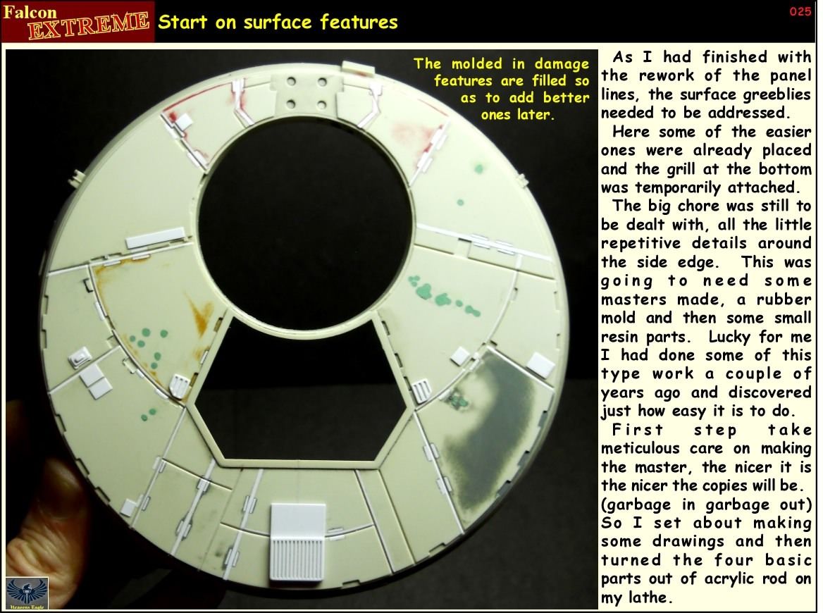

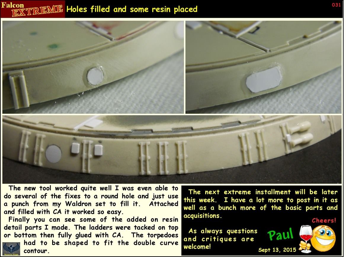

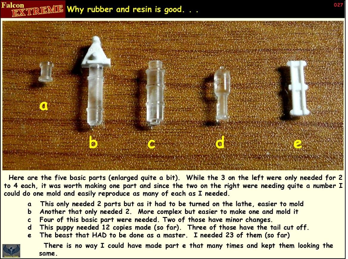

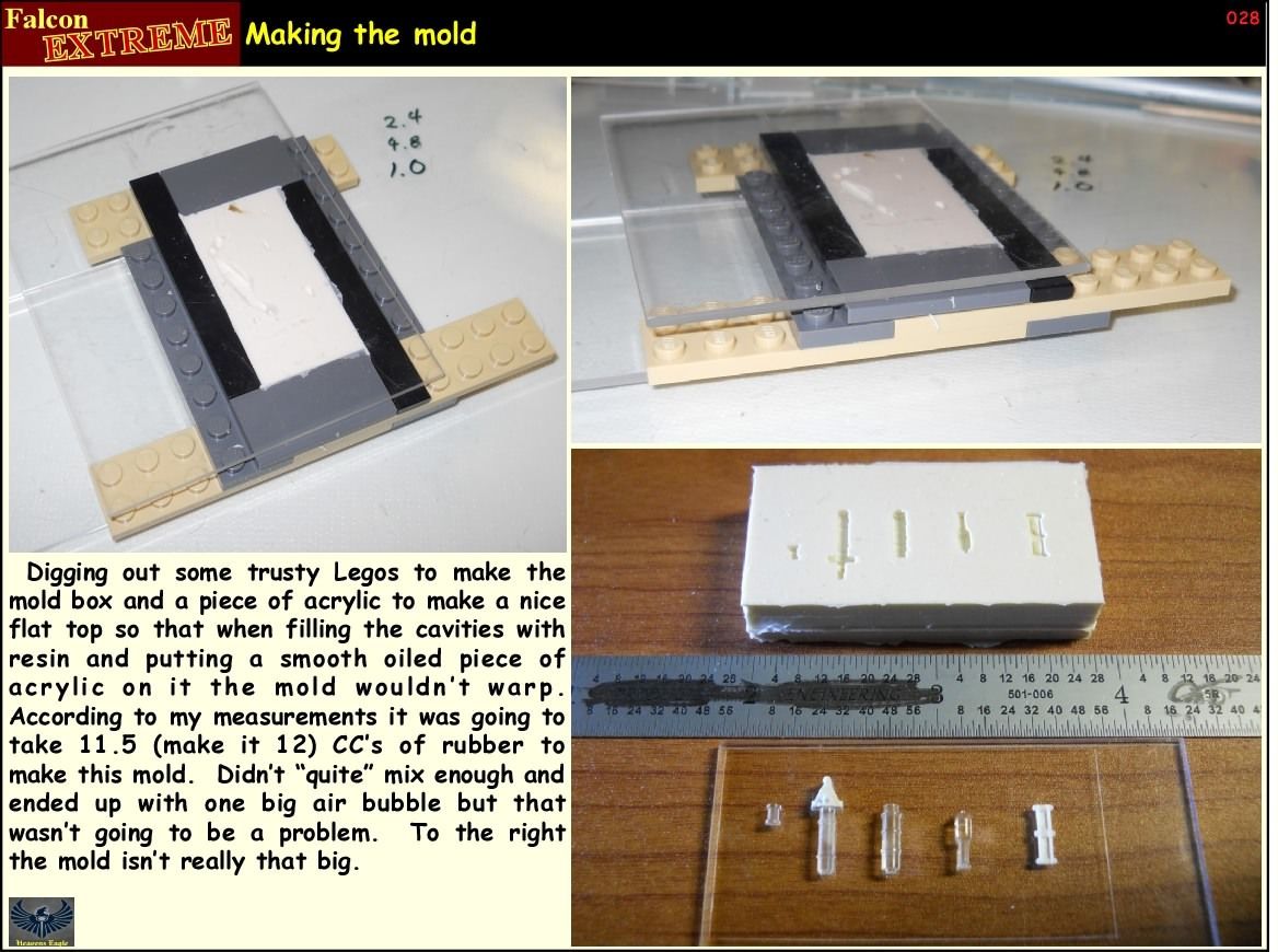

In this post, I am making masters for 5 parts that there are multiple copies all over part TP-3 (the turret) and some surface rework of the part to change it to something a lot more interesting.

Here is another update: [:D]
There is plenty more to come, I am still playing catch up on where I am on the build.
