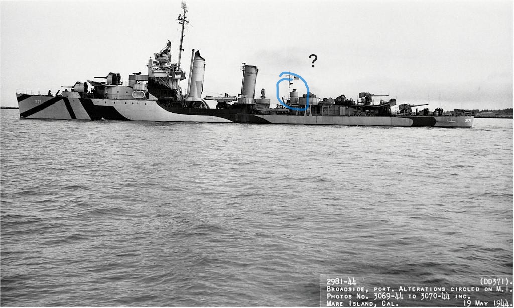

I recently started working on an Iron Shipwright’s USS Conyngham. My father served on this ship throughout the entirety of WWII.
From my research I believe there is an error in the instructions. Just forward of the 40mm at the forward end of the aft deck house are two round elevated platforms. The instruction call for 20mm oerlikon cannons. I don’t think that is correct. The specifications for the 1943 refit say there are 5 20mm gun. A line drawing I found for the USN records show all the 20s in other locations. But it does not say what these platforms are.
Any help would be greatly apprecated.

Tis, that circled raised platform is for the MK 51 director. what time period are you doing the model in?

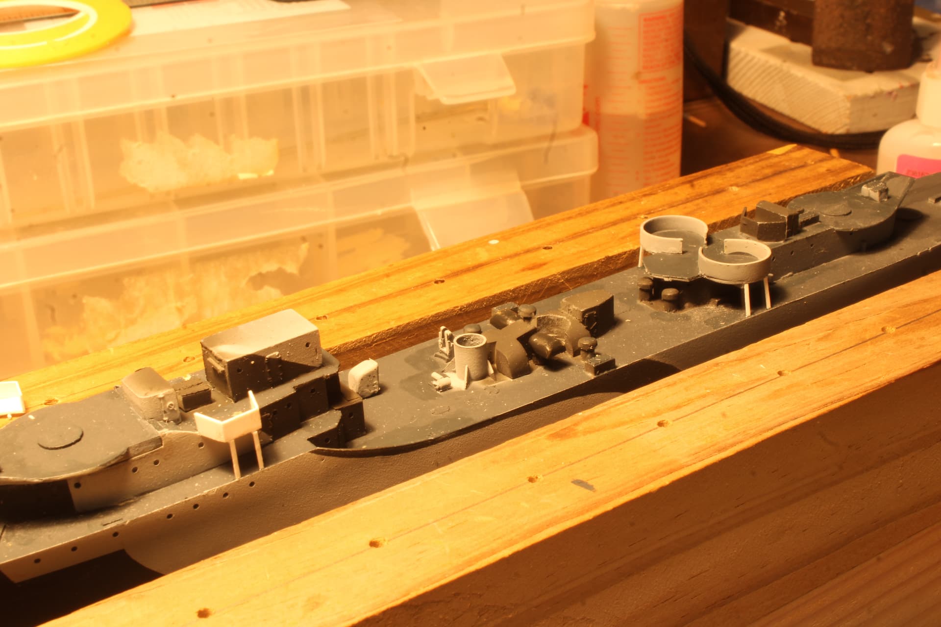

I’m working on it as it would have appeared after it’s 1943 refit. Thanks for the information, I suspected it was something like that based on its proximity to the 40mms.
does it come with 2 of those directors as shown in this picture?
No it does not. The platforms also look a bit oversized. That should be easy enough to fix though.

I have downloaded the files. Thank you. I believe they are going to be very helpful. The ship has two. The kit did not come with any directors, however it appears they are available on line.
