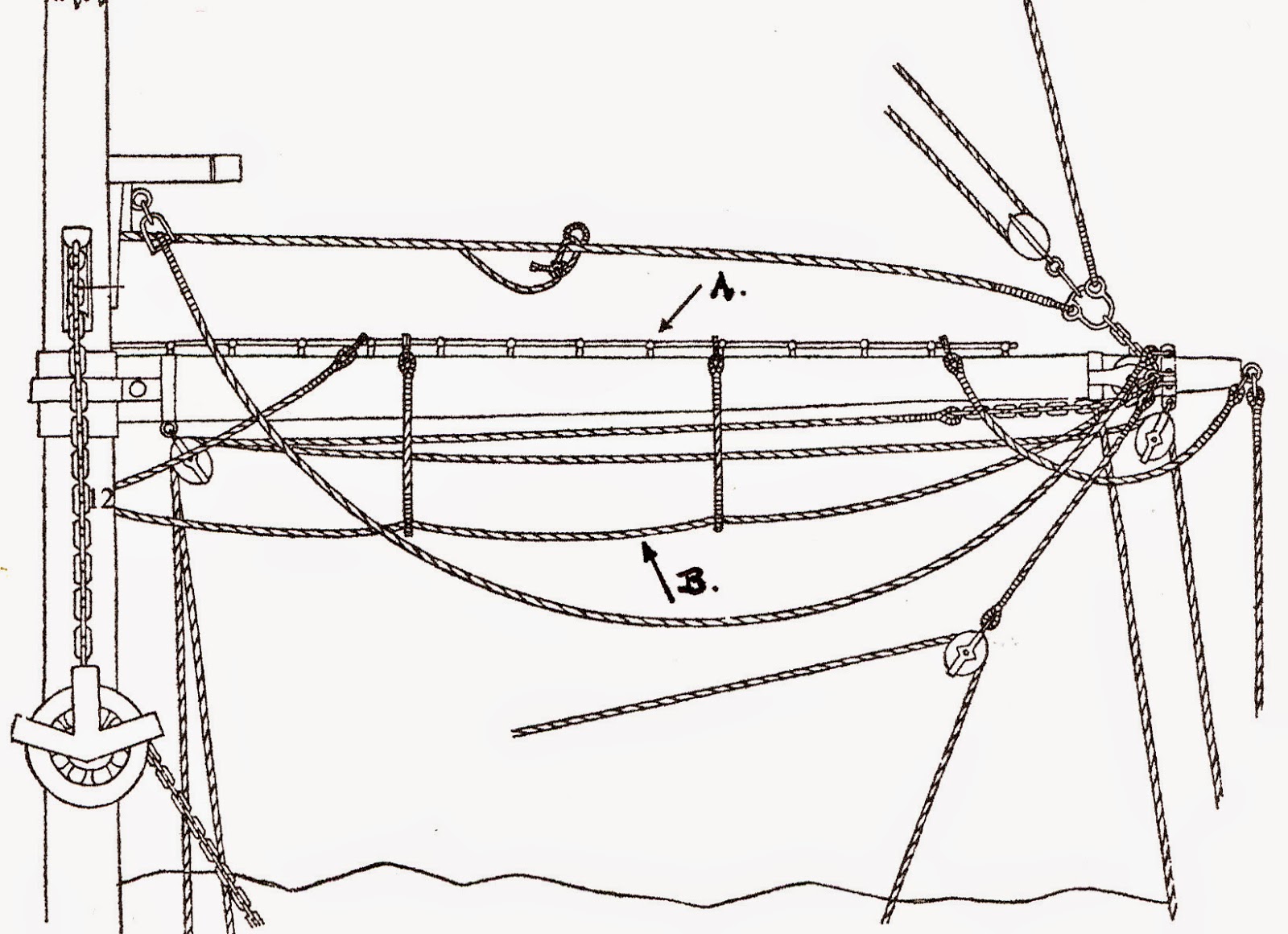

There’s not really an engineered attachment point on the model spars.
Cutty Sark used metal jackstays (a pair, in fact, on on top center, the other forward about 45 degrees).
Along the tops of the yards. These are metal rods run through iron eyebolts.
Revell modeled these as lumps and ribs, and not exactly crisply.
The vacuform would need a lot of roll on the edge to meet the moulded jackstays.
At scale, the jackstays would be abour 0.10 mm diameter, and stood up above the yard about the same amount. So, a person could be forgiven for simply using extra-fast, to glue the vacuform to the front of each yard at about the 3 o’clock position.
Now, this would have been easier before mounting the yards to the mast, then putting them on one at a time, with all the riggeing wanted per yard.
A person, to my thinking, could be forgiven for skipping the staysails entire. As the fussiness of needing tiny (0.1mm) holes in the vacuform at about 5-8mm spacing is not easy in the nearly 1mm thick vacuform.
