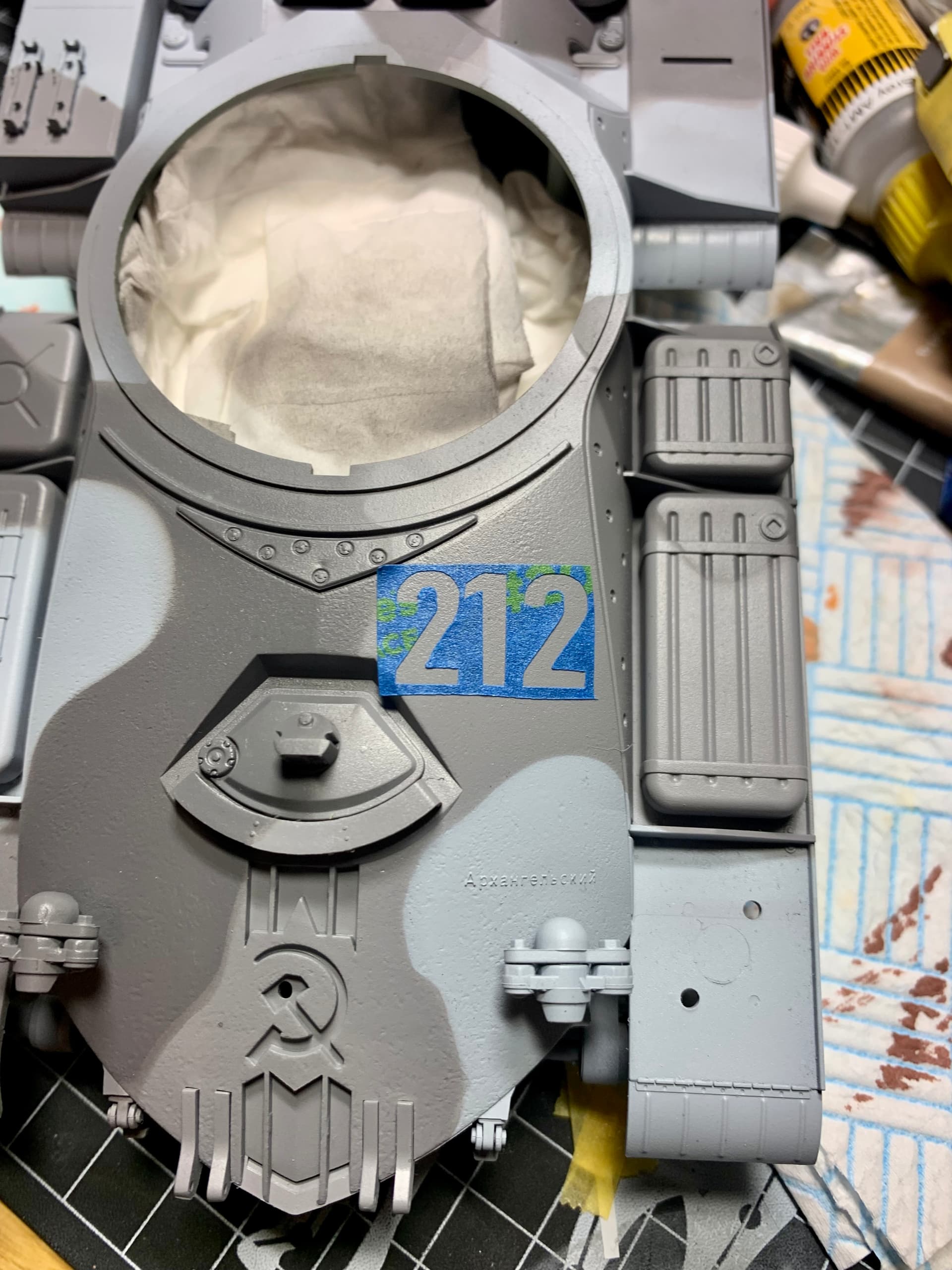

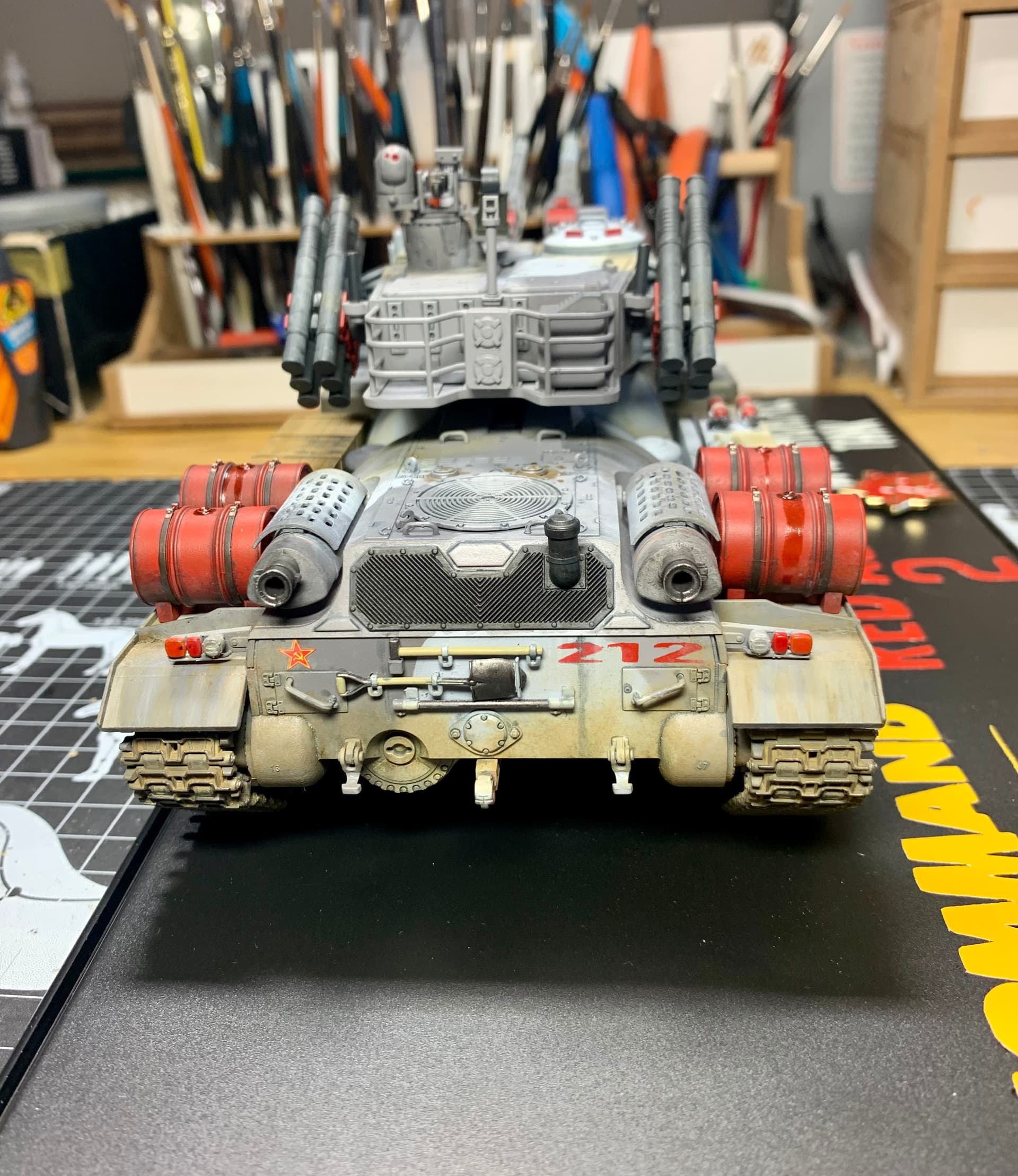

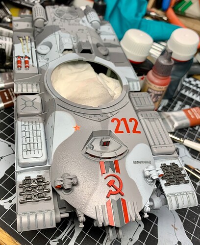

I have the small Cricut Joy- I have used it for some masks instead of decals and also to print larger masks for some stuff on bases.
The ‘212’ numbers on this piece were done using the Cricut.
As were the three badges on the base here.
The software is ok- the basic stuff is free with the Cricut app- you can upgrade it to a subscription and get various things but I find the basic stuff is all I need. Takes a bit of trial and error to get used to it but it is fairly simple. I tend to use Scotch blue tape varieties as they respond best to complex shapes and curves.
