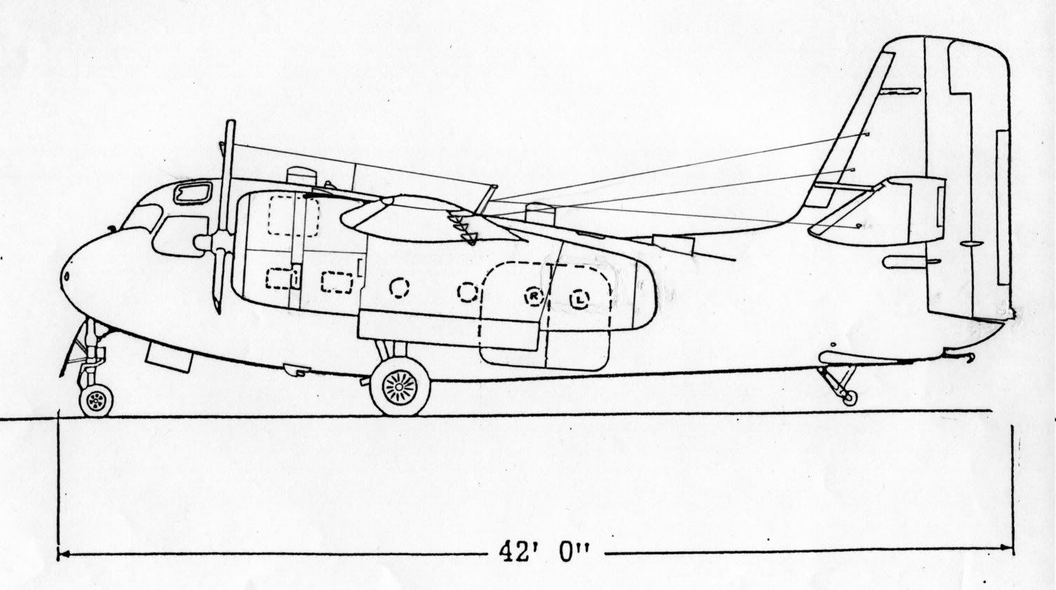

OK - the horizontal tail was from the S2F-2 and had a span of 26’ 9 5/8". Here is a profile that shows the depth of the belly:
Wasn’t the fuselage wider also?
You’re right. The lower portion of the forward fuselage is a little bit wider so there isn’t a “crease” going aft from the bottom of the side cockpit windows and it isn’t quite as slab sided under the wing as the S2F. The more oval shape appears to extend past the cabin door.
If you look closely, you’ll also note that the C-1’s side cockpit windows also don’t extend upward as far as the S2F’s. It appears that this may have been changed to allow for a slightly bigger overhead hatch.
Thank’s for the profile drawing Tailspinturtle ; I think I’ll still go ahead with the conversion . Enlarging the fuselage might be beyond my modeling skills ; but adding some extra window’s and cargo doors I can do , I suppose it won’t be a very accurate version of a C-1 Trader , but the kit only cost $5.00 ,and I bought two of them , so i’ll have some fun with one of the kits .
