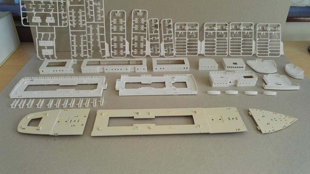

A few pictures of what is in the box:
And the instruction book, which is almost entirely in Chinese but has very clear diagrams referring to numbered parts.

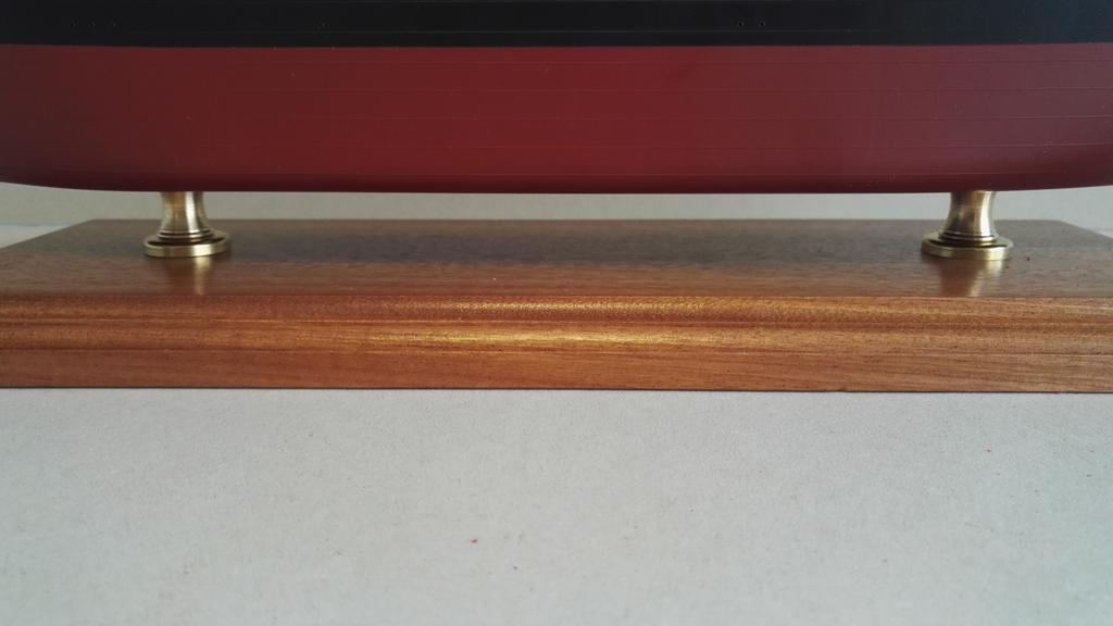

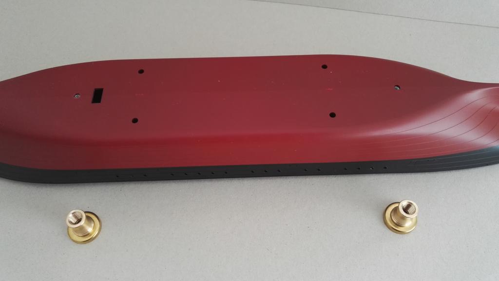

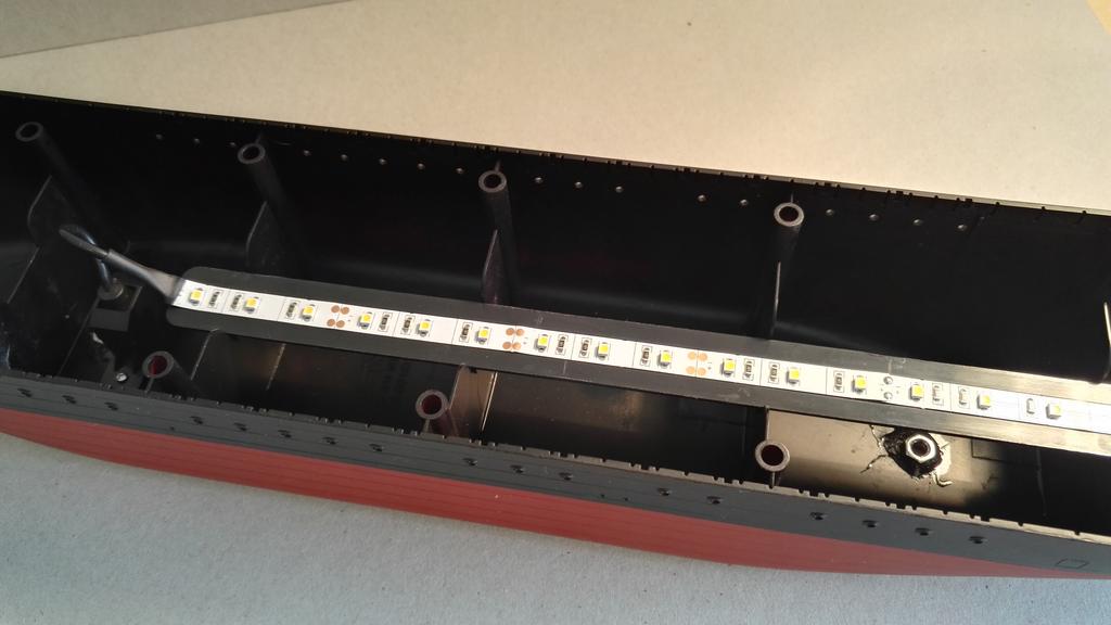

I thought that this model wood look good on a wooden base rather than on the plastic stand provided, so I did some measurements and ordered a nice looking base plus some brass lamp fittings. I drilled two holes in the bottom of the hull and glued nuts in place with CA glue and araldite. I won’t mount the model just yet to avoid any possible mishaps with the base.
The rectangular hole in the hull is for the USB connector on the LED strip. I blanked the holes for the original stand to stop the light from leaking out.

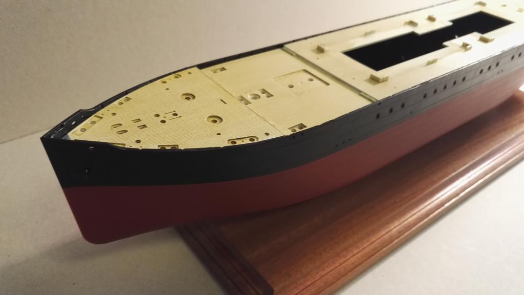

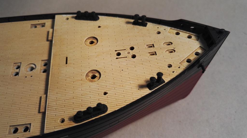

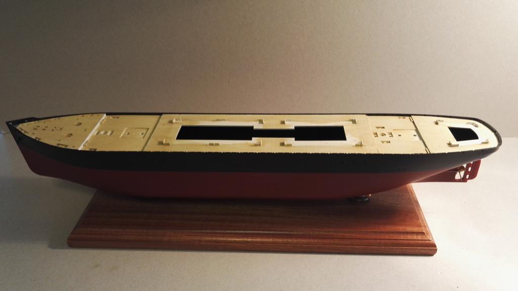

I don’t have an airbrush so I resorted to rattle cans for the basic colours: Tamiya NATO Black for the upper hull and deck fittings (a very dark grey shade that looks better than pure black imo), Tamiya Dull Red for the lower hull, and a DIY chain Satin White rattle can for the superstructure, railings and ladders, life boats and other small details. I want to spray the masts, booms and air shafts deep yellow and have ordered a can of Tamiya Chrome Yellow for this.

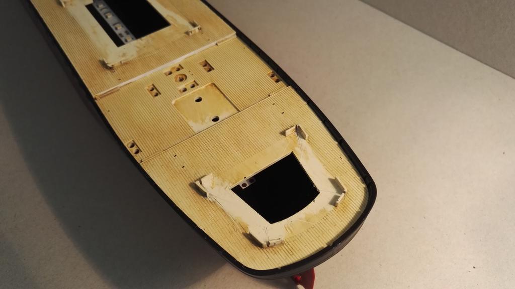

The decks have recessed imitation planking, there are paper stickers provided with a kind of wood colour but these look rather bland. Instead I rattle-can sprayed the decks with a Cream colour and after drying went over them with a mix of cream, light and dark brown oil paint, wiping most it off almost immediately after applying. This brings out the planking and gives a more lively representation of a wooden deck.
When all this was dry I inserted the hull glazing (all portholes are glazed) and the LED strip.

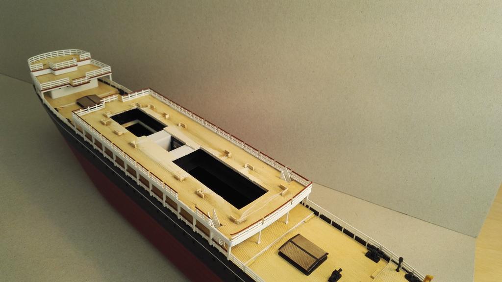

Then I glued the main deck which comes in three parts.
This is as far as I got. Because the kit is meant to snap together the tolerances are very tight. I dry fitted the first bits of the superstructure and struggled to get them off again! The fit is so tight that I am worried about breaking something, or not being able to push everything home, so today I filed out all the location slots to provide a bit more play.

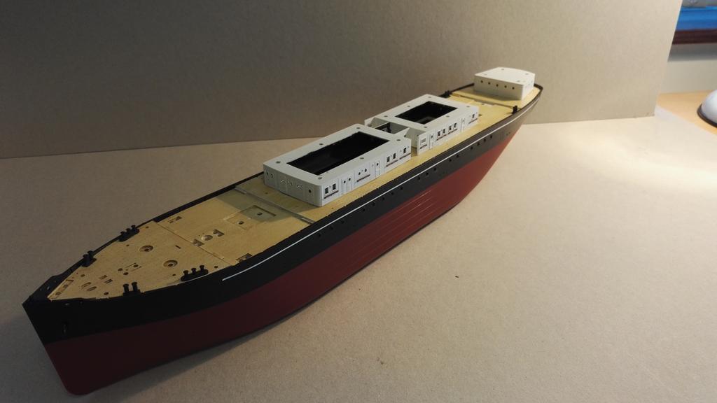

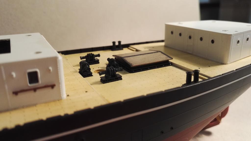

A little bit more progress, the first level of the superstructure is installed, and I’m working on the deck fittings.

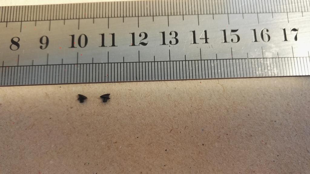

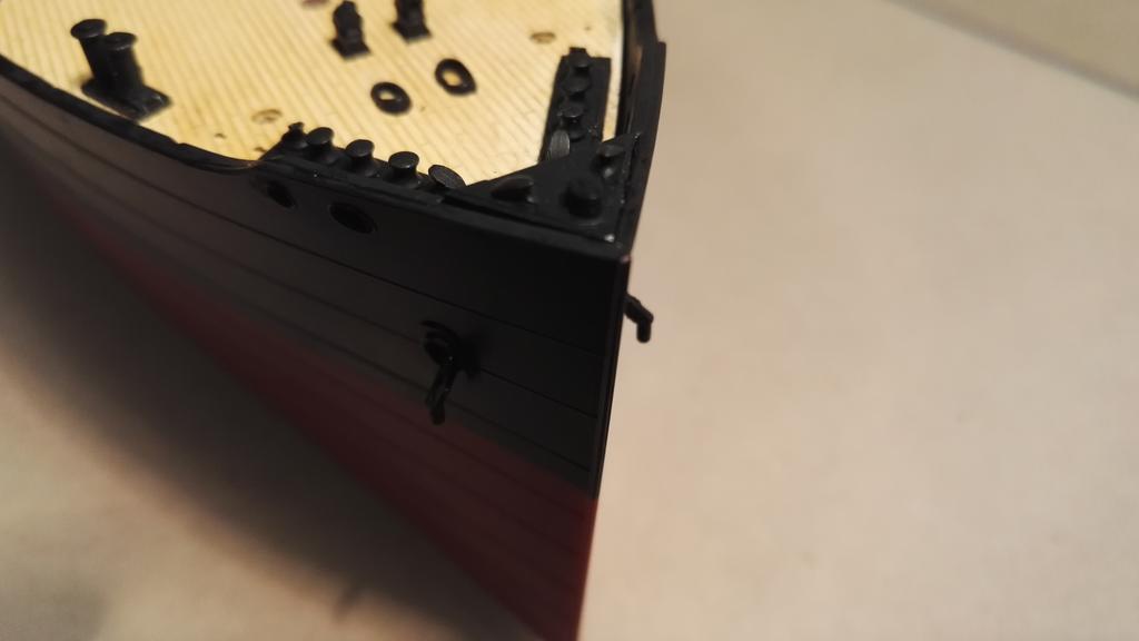

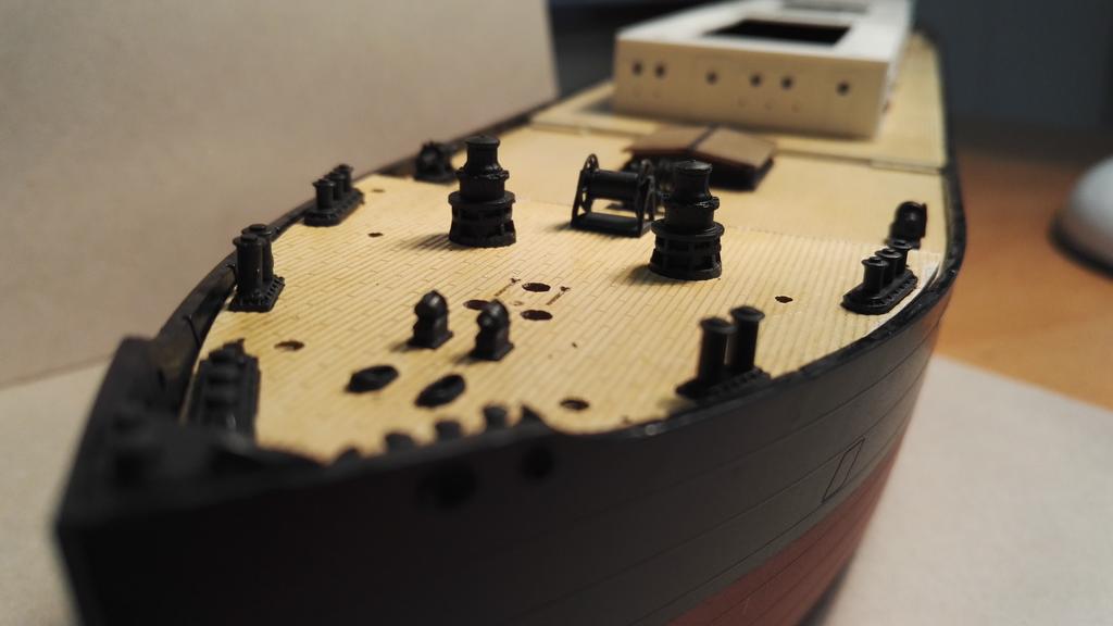

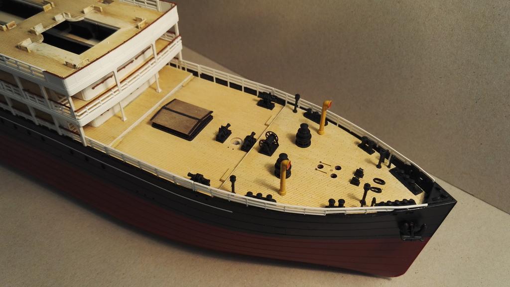

I have now come to a (literally) small problem. Right on the prow of the ship are some bitts. I managed to get one on, the round one you can just make out right at the front in the following picture:
Next are two very small items, I think they are cable guides of some sort. These are utterly tiny:
(The ruler divisions are mm’s).
Installation should be like this:
This has me stumped. The problem I’m having is that I’m struggling to pick up these pieces and insert them into their slots (the small elliptical slots immediately behind and just to the side of the round item, you can just make out the starboard one in the picture). Fingers are obviously out. I tried tweezers, of various types, but the moment you try to squeeze it in, the part pops out and flies off. I was lucky to find them on the floor - twice…
So, that doesn’t work either. I also have a self-closing type of tweezers that at least grips them reasonably well, but not quite tight enough so that I can exert any pressure to drive them home. Anybody have any ideas on how to pick them up and drive them home? What would be the best tool for this?
For now I will leave them off, until I have a solid idea on how to proceed. Faffing about just risks losing them forever to the carpet monster.
The situation is not helped by the extremely tight fit of most of the parts (because the kit is supposed to be snap-together). When assembling and placing the other bitts I have opened up all location slots with broaches and needle files, otherwise I have to put so much pressure on the parts that I fear something will snap. It makes for slow going but then, there is no hurry.
Try a toothpick with a bit of bluetac on the end. If you don’t have that maybe a small piece of chewing gum lol.
Thanks, I might try that. I could cut off the locating pip so I don’t have to force it in, pick it up the way you describe and glue it with a tiny drop of CA.

On those I would definitely enlarge the mounting holes !
these are a handy tool for that kind of thing jurs . you can look them up on u-tube .
www.umpretail.com/products/ultimate-photo-etch-placer
Thanks for all the tips, guys. Those photo-etch placers certainly look worth having.
In the meantime I did manage to get the little b*****s on. I held them down on the cutting mat with my nail, then trimmed the tab a little, picked them up ever so carefully between my nails and pushed them home, with a touch of CA.

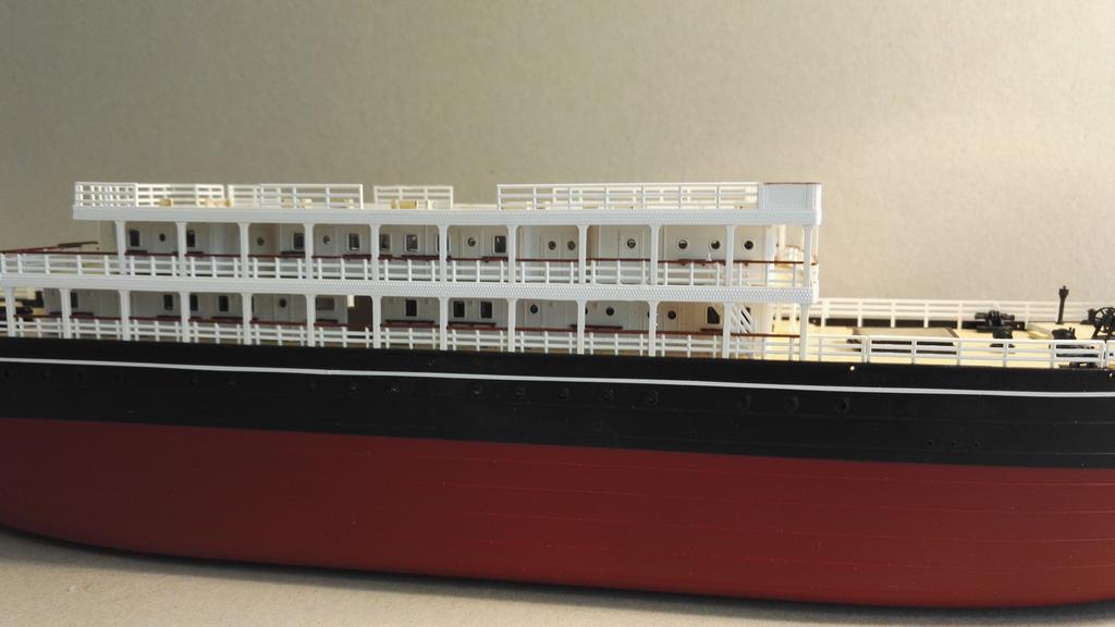

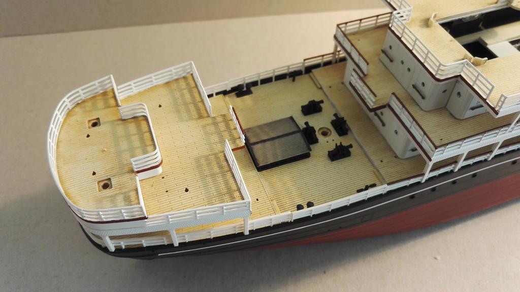

Made some more progress on this ship. First came the main deck railings, they come in a number of smaller segments and fit into slots to the side of the deck:
Then the decks. I was a bit apprehensive about these, the 30-odd supports need to be slotted in at the same time as lowering the deck into its location holes.
I need not have worried, it all came together very nicely. I had filed down all of the locating tabs a little before fitting, without them becoming too lose. Everything lined up and fell in place beautifully.
Unfortunately two of the fragile railing segments came loose, but they can be fitted with a bit of glue later.
The second deck likewise fitted quite easily.
She is beginning to look like a real steamer.

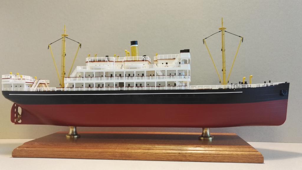

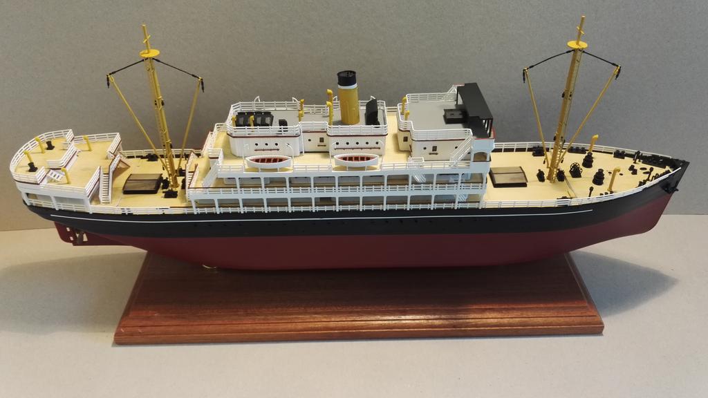

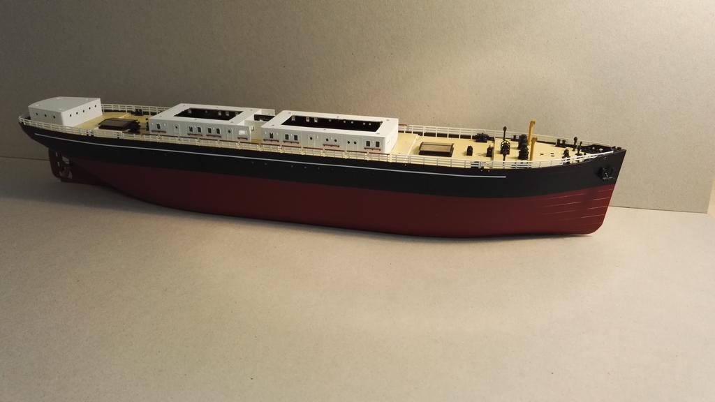

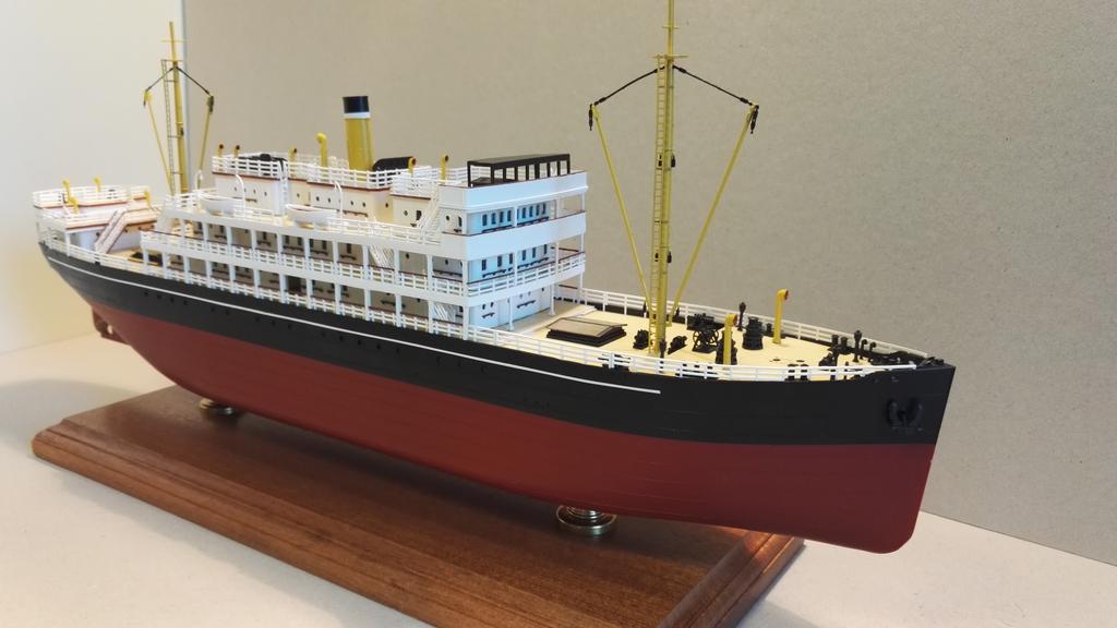

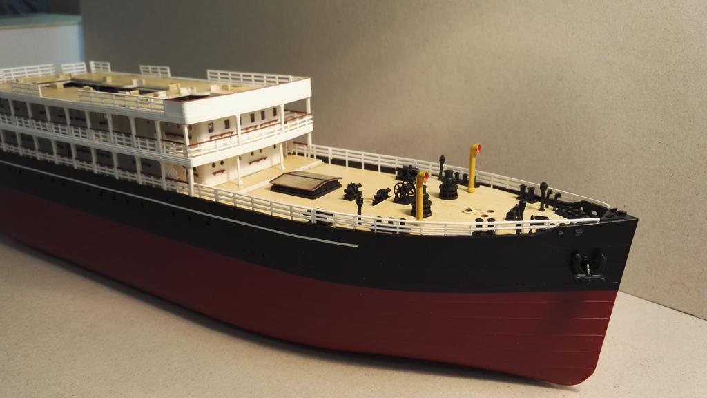

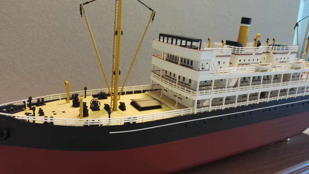

Finished most of the plastic parts this weekend with the exception of the anchor winch (waiting on Meng to send me the missing chain). Still to do are the rigging of the davits, masts and cargo booms (I’m not too sure of those, actually), and give her a name. Since this is most likely a free-lance ship I am not wedded to the Chinese name in the kit and will go for something a bit more personal to me. I need to experiment with making my own decals for this.
She does look a bit stubby but that is mainly because the height of the superstructure I think. Her length is 21", width is 3 1/2 " and main deck to keel height is 2 1/2".
Looking great! Very clean, tidy work.
Are you planning to weather it?
That stack really does look minuscule for the size of the ship … but I, for one, would not change it if I were building her. To me it would represent just one interesting facet of that vessel - if, of course, it was a real vessel.
