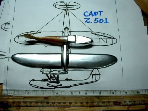

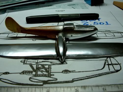

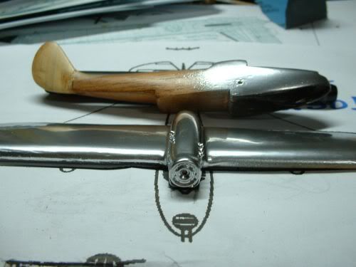

Hi all…
The little Cant is advancing and I will finish the wing and engine completely before
I glue it to the “wing struts” for once glued I don´t want to touch it. This will be a “rescue”
plane which were either white with red crosses or bare metal with bright red stripes on top
of the wings.
The model is a solid wood (Mahogany), very small, winspan is only 8"
