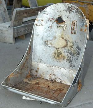

Michael - Here’s your seat:
The seat shown here is from Brewster 239 BW-372. In Finnish service, there was a spade-shaped piece of armor protecting the head, and a leather seat back which probably covered seat-back armor. This may help:

The picture of the seat really helps me. Is it from the plane that was recovered some years ago in russia and now in a musemum in the states? I just got a very good book on the brewster today. It has scale drawings of all the models and a ton of pictures.

Not to be too off topic here, but I feel kinda bad for the pilot that sat in that seat. That’s a big, nasty hole there.

RadMax wrote: but I feel kinda bad for the pilot that sat in that seat. That’s a big, nasty hole there.
Don’t feel bad for the pilot! He lived to a ripe old age, passing away in 1999. The story is at: http://www.sci.fi/~fta/BW-372-2.htm
The seat armor in the second photo I posted was in front of the seatback (the pilot’s back was against the armor, which explains the padding), so the round that put a hole in the seat was stopped by the armor.
Yes, the seat is from BW-372, the Brewster 239 recovered from the lake in Russia
