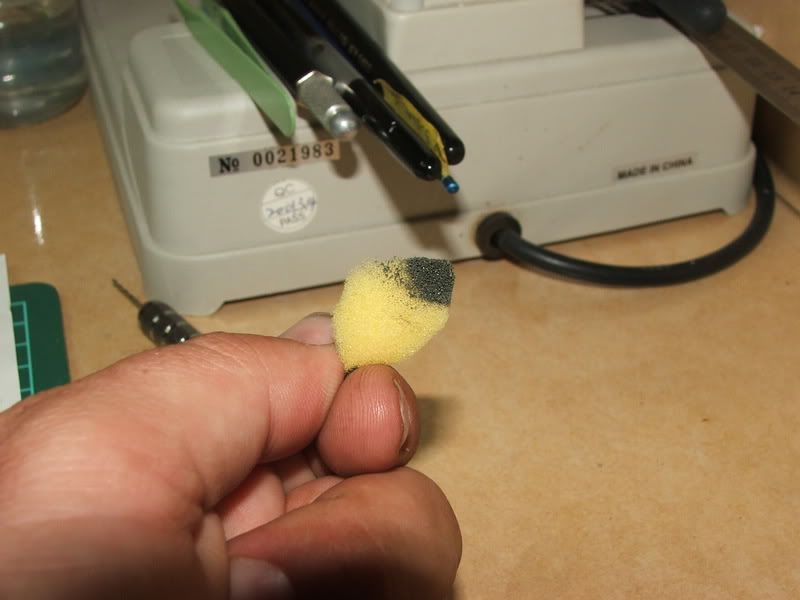

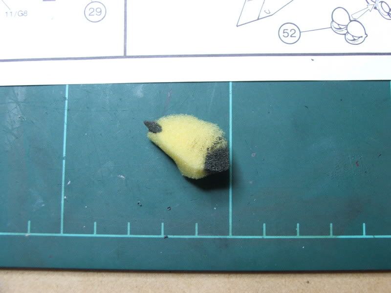

The mottle was applied with a synthetic sponge which I cut from a Meguiars polishing pad.
The fella at the local auto store thought I was weird when I walked in and bought 7 different sponges to test out, none of which gave me the scale I wanted (there went $32 bucks I coulda spent elsewhere [:(])
So I went into the shed and tried the polishing pad.
It’s a round pad about 90 millimetres across, and has Meguiars moulded into it on one side.
Turned out to be a winner!!
Application was simple, just used straight acrylic paint, dabbed the sponge in it and blotted it onto some post-its till it was nearly dry, kinda tacky actually, and went to town on the fuselage.
I found it better to let the paint dry on the sponge and just keep adding more paint, then blotting till tacky, then applying as this gave a more ‘refined’ look as the paint built up on itself.
It took 2 or 3 dabs onto the model in one area to get a decent amount of coverage and to make the camo look ‘right’.

Thanks Tweety for the info. Not sure that the manufacrurers you quote are available here in the UK but it seems, from your phot`s, that a very fine celled foam is required. In fact it looks vaguely like upholstrey foam although that may be to firm still now we know and yes please do do another and let us see the results.
