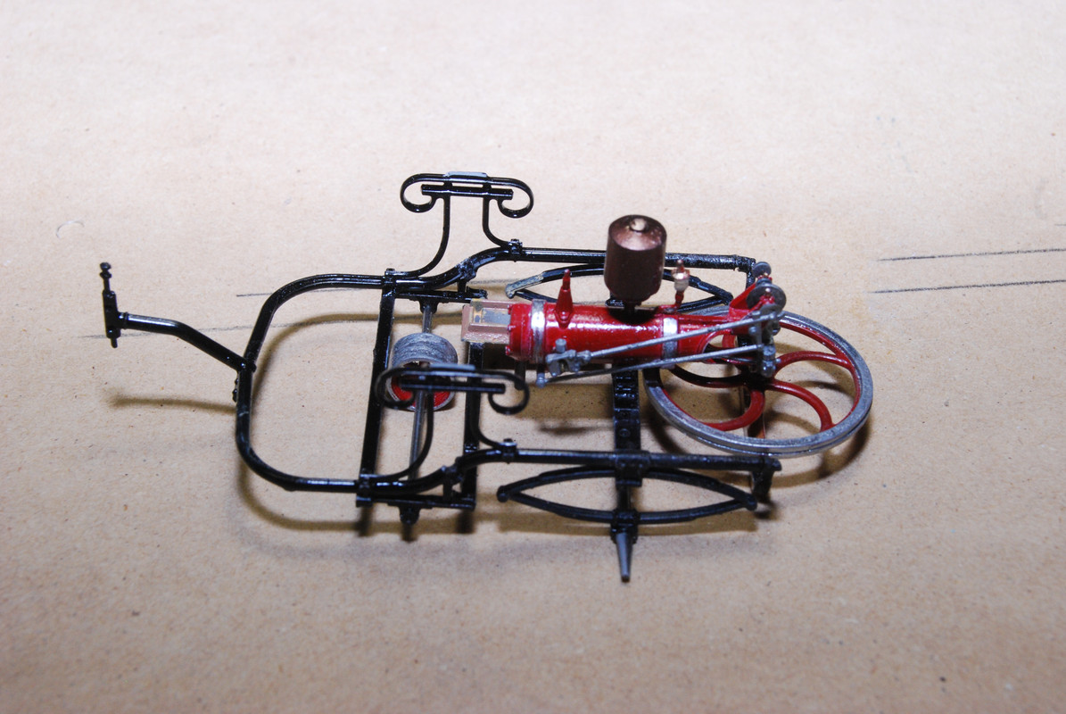

Frame is now complete. Here is the frame, and a few other parts I am still working on.
On the right hand side of the picture, from top to bottom are the countershaft pully, The engine block, the flywheel and the countershaft and mount. As soon as I get anothere coat of paint on the pully I will mount it on the countershaft and mount that on the frame. Still have a lot of work yet on the engine.

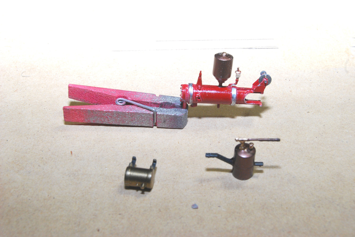

Finally got the Alclad Copper for a couple of the tanks. The cooling reservoir for the engine needed to be sanded very carefully, so I decided to cut it away until it was coppered, so I cut it off the cylinder and drilled a hole in the bottom for a brass rod, and drilled the cylinder to match. Also I did not like the cast oil reservoir- it needs to be transparent. I cut it at the bottom, cut the cap/filler off and replaced the reservoir with a section of 1/16 clear acrylic rod.
Now I mounted the engine in the frame, along with the flywheel, crankshaft and pushrod linkage.
