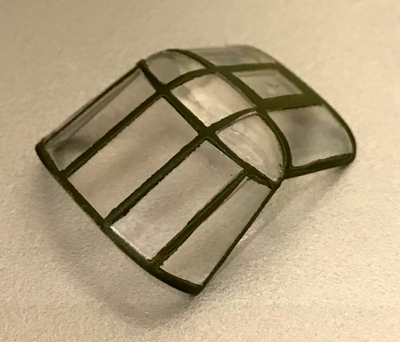

Finally, real progress with aircraft canopies! As mentioned above, I took the advice of a previous poster at a YouTube video, for and googled “scale model canopy painting” or some such combination of words, and found this “How To Do Canopy Masking - T K Tutorials #1”: https://www.youtube.com/watch?v=Kk4hl0Fsq-M.
What great advice (for me, anyway)! And here is the result (the canopy of the Italeri 1/72 UH-34 D Sea Horse helicopter:
The technique involves using Tamiya masking tape stuck to the canopy and then tracing the canopy frame with a pencil, trimming the tape with scissors at the outer edges of the traced lines, re-applying the cut pieces of masking tape to the canopy, then painting it. (I tried a pencil, but the lines weren’t very easy to make or see, so I used a small-tipped Faber-Castell PITT artist pen instead.)
From other suggestions from the FineScale discussions, I’ve learned that the best way to avoid “bleeding” of paint under masking tape is not to paint the frame lines with a brush, but to spray them with several light coats of paint. In this case I used Tamiya Olive Drab 2 paint, the same paint I’m using the helicopter. I did get a minuscule amount of bleeding which I didn’t actually notice until I saw the enlarged photo of the canopy. But from a “normal” viewing distance, the canopy almost looks professional! Or at least a heck of a lot better than my three previous efforts on other models. A bit of work with a sharpened toothpick will probably remove some of the slight “overspray”.
