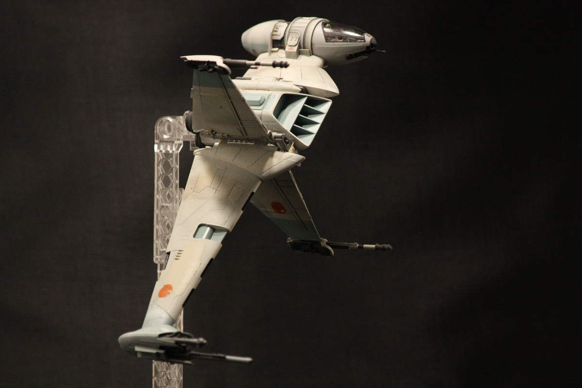

This kit is simple. It is technically a snap-together kit, but I did use a bit of liquid cement in a few places to ensure some surfaces stayed together. Paint is a mix of AK Interactive Real Colors, MIG, PollyScale, Tamiya, and Vallejo. First round of paint was AK dunklegrau sprayed as a mist coat prime, then did a pre-shade of the various panel lines. Once that dried, I mixed up PollyScale light gull gray with Vallejo white 1:1 and put that down on all the exterior surfaces. I let that sit overnight, then came back with a mixture of AK barley grey, Vallejo white, and Tamiya clear 1:2:1. Following that, I masked off a few random panels, mixed up an equal ratio of Tamiya deck tan, Vallejo white, and Tamiya clear, and sprayed those panels.
Bandai provides decals and stickers for all the markings, including the blue stripes and panels, but I opted to paint the blue. That was a mix of AK light blue, Tamiya medium blue, and Vallejo white 6:1:1. The final painting was a mist coat of AK barley grey, Vallejo white, and Tamiya clear 6:1:3. Note that this painting direction was one I found online of another modeler who had done this kit, so I didn’t come up with all of this. I also cut circle masks and painted the hinomarus, for lack of a better word, with MIG Pigments orange paint; I used some liquid masking agent to effect the chipped look of these markings.
I weathered with AK Interactive streaking grime applied directly with a fine-tipped brush, then feathered in with white spirits, and followed with some ground up charcoal pastels.

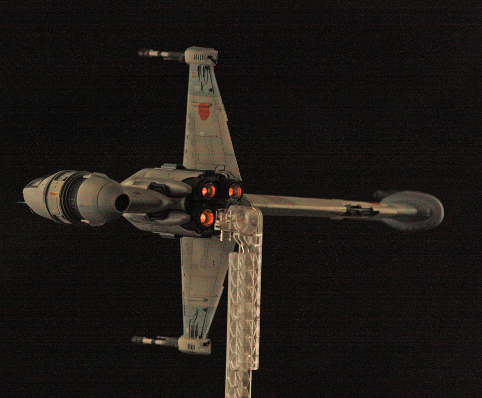

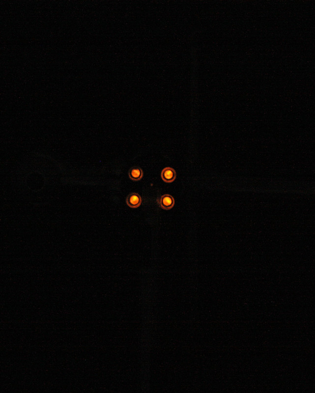

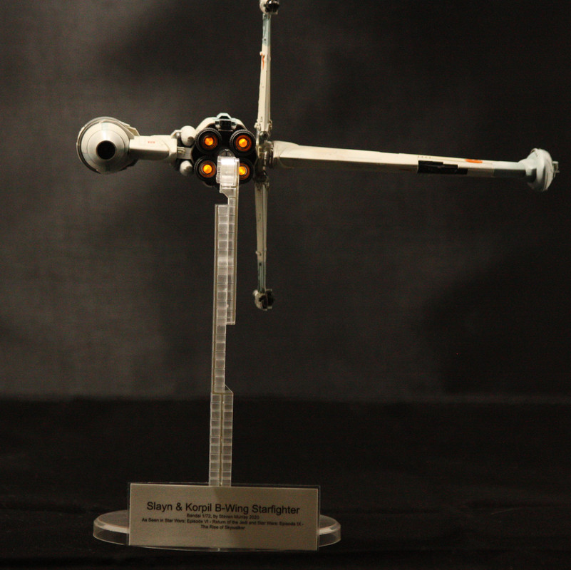

Finally, with the engine nozzles, I painted the interior chrome silver in the hope that it would reflect the engine lights, which I think it does to a certain extent.

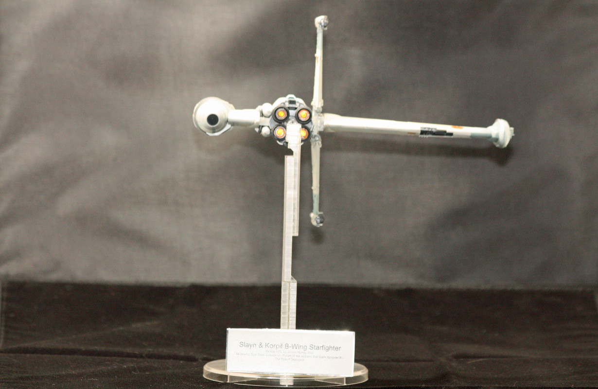

And then this one photo of the placard I made for this build. I recently did this for all the builds I have displayed around my house so that my wife can know what each model actually represents.
