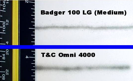

As to painting, they are both great. I’m reluctant to include this photo because of the circumstances under which it was taken, but I will. Just read the paragraph underneath it and understand that both brushes are capable of better work than this.
This photo was taken the day I received my Badger 100. I had been spraying some large areas of an A-10 with Dark Ghost Gray from my Omni 4000. The paint was not thinned for painting thin lines, it was thinned for painting large areas. I also didn’t try to “Optimize” the paint for the Badger 100, I just dumped it straight from the cup of the 4000 into the cup of the 100. What I was trying to determine was a side-by-side comparison of the line width of the Omni 4000 and the Badger 100 with a medium tip (the “Fine” tip will do a little better if the paint will flow properly). Had I really tried to get fine lines out of either one of them I could have done better than what the photo reflects, but I wasn’t really trying at that time.
Thanks Scott-I’ve checked you website many times for info. This picture helps. Now I have to weigh ease of maintanence and the fact that the 100LG is more fragile than the 4000. Looks like either one will be an improvement over my Passache H, which is good for most of my current needs.
