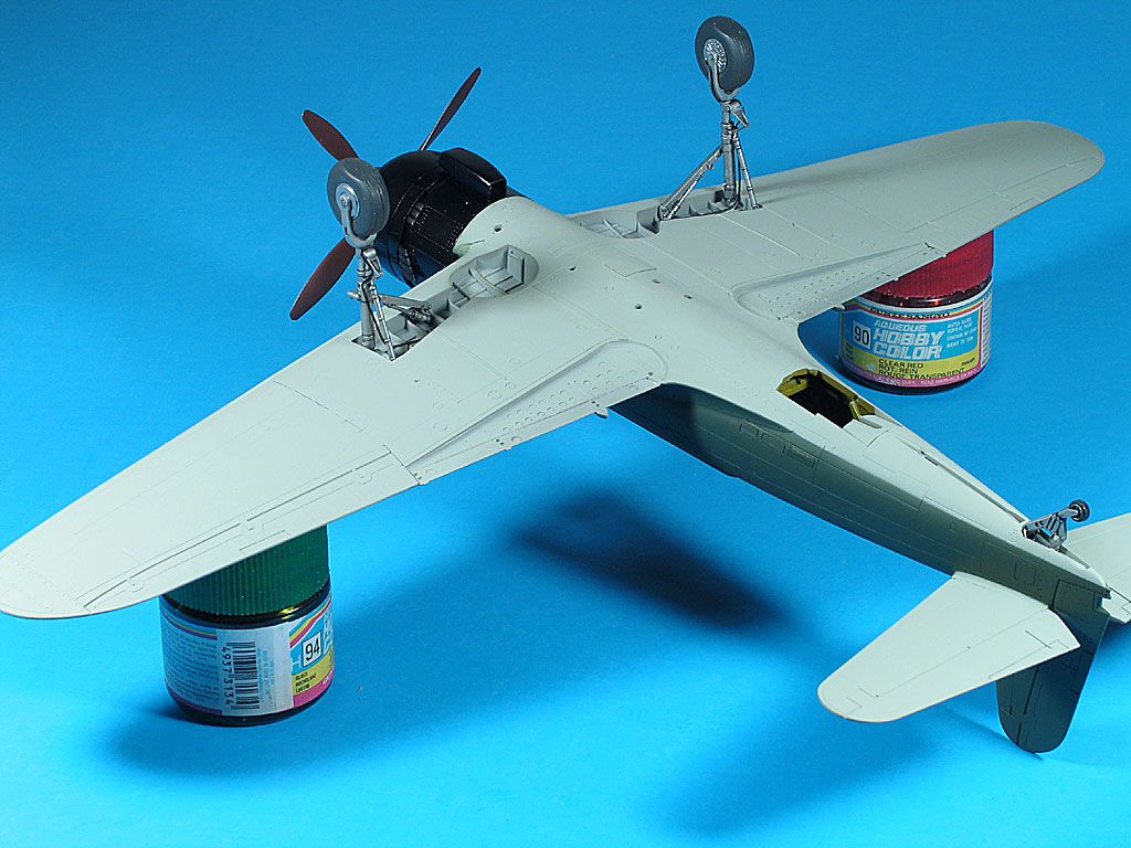

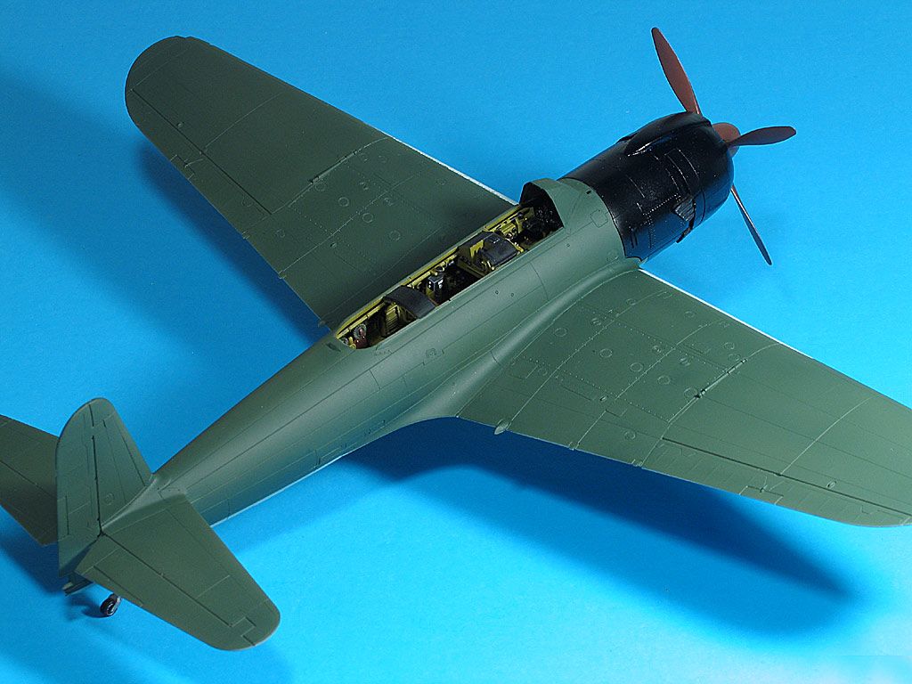

Here are some progress pics of a 1/48 Nakajima B6N Tenzan (codename “Jill”) that I’m building on comission, using Eduard’s photoetch detail set and Squadron’s vac canopy.
I got the airframe painted today, using Aeromaster Warbird acrylics (which are no longer made). I used Nakajima Navy Green and Nakajima Navy Gray. The prop is Red-Brown Primer.
The metallics are Alcad. The wheels are just painted, they haven’t been washed or drybrushed yet. The guns have Eduard PE sights, and the torpedo has PE fins and props. The frame for the ventral gun turret are also PE. There are also PE items on the main gear and tailwheel.
I tried something different on the cowling. I painted it flat black, then glossed it with Future. I then oversprayed it with a mix of clear blue and Future for the cowl blue-black color. It’s more effective “in person” than it is in the pics.
The leading edge ID bands have been painted white in preparation for the yellow. I’ll have that done Sunday.
The wheel wells, along with the interiors of the gear doors and flaps, will be done last using my own “Aotake.” I paint them with a reflective metallic, then overcoat with a mix of clear blue and Future. It looks better to me than the out-of-bottle colors available. Some touchup with NN Gray is needed at the nose (a bit of the green ran). That’s one of the things I dislike about all acrylics except Gunze. The paint dries on the tip, then all of a sudden you get this “blast” of paint when the tip unclogs itself. Grrr ! [}:)] I don’t like acrylics (except Gunze) !

Those tires need some air…
