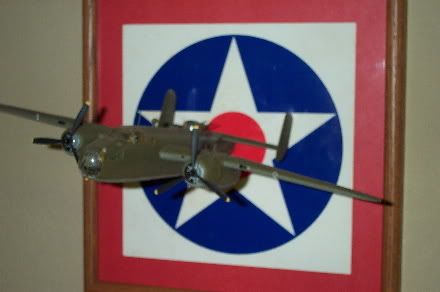

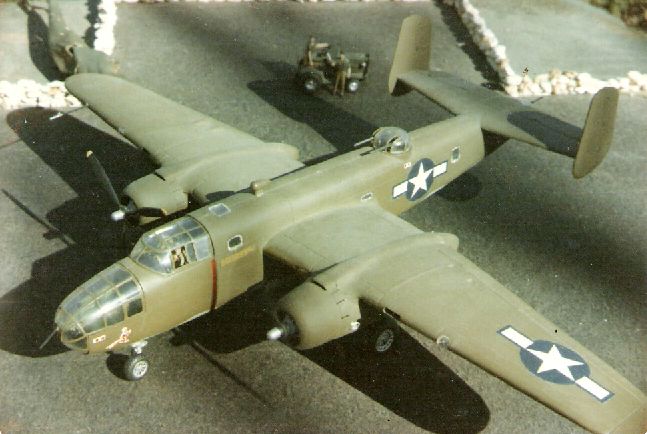

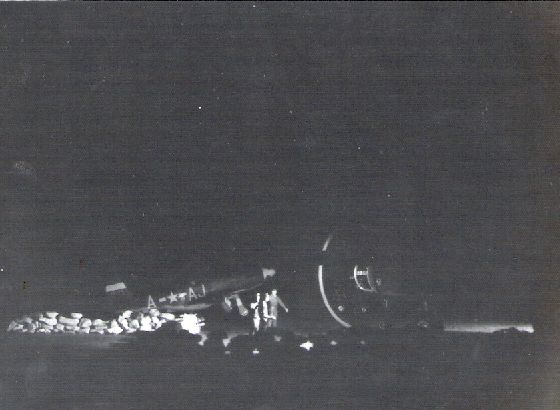

Here are a few pictures of an old 1/48th Revell B-25B I built over 30 years ago and then “refurbished” it into a gear up “wall hanger”. I motorized the props and had working landing lights. I put a battery pack and micro switch in the back of the frame so the motors and lights would still work. I’ve got another Monogram B-25J on the “assembly” line for a motorized ground diorama along with a B-26C Invader as a “wall hanger”. The Accurate Minature kits are great except for the funny looking engine cowls. Too bad they “missed” the outline on that one! I’ve opened my up a bit more but think you need to add a little more plastic filler to the back of the ring to get the curved lip effect better. I had another kit I opened the cowling up on so you could see the engine detail. You can see the open cowl in the night run up.

Oh, and Mel…great idea on your “refurb”!. Looks great.
