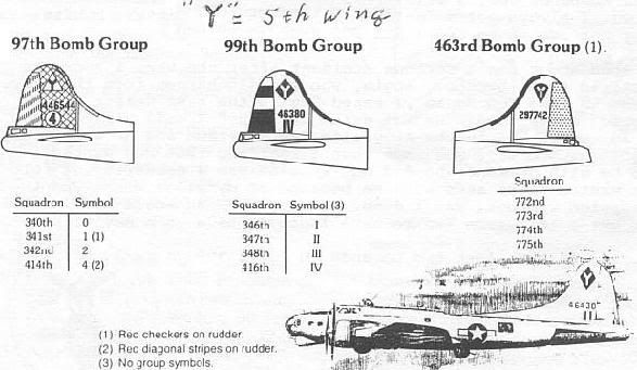

Hey, Ted!
I did some “google-ing” for you and i found something you may be interested in
You may have seen it before, but your granddad’s plane would be Diamond Y, IV. Hope this helps a bit. [:D]
