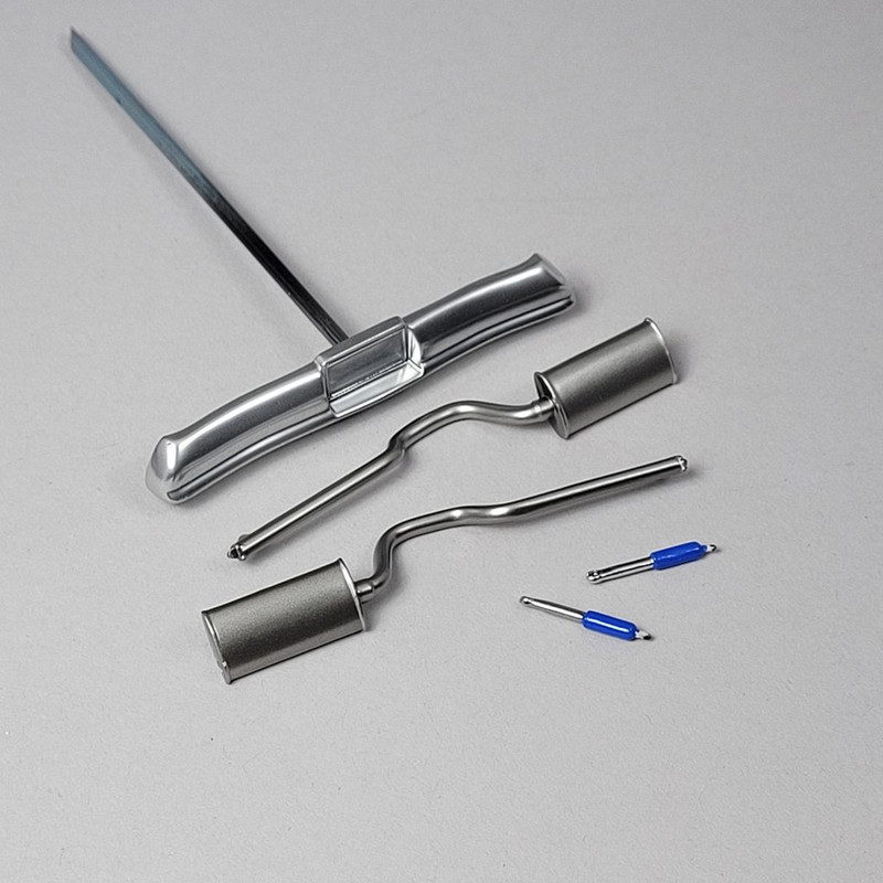

These bumpers and shocks were painted with AK Chrome and the pipes were painted with MRP Chrome
