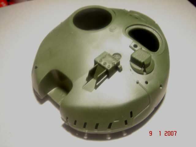

Well, I’m converting a Zvezda T-72A into an Iraqi T-72M1 Asad Babil… As I have the excellent M1A1 AIM from Dragon, I need something from the other band… Here are the pics:

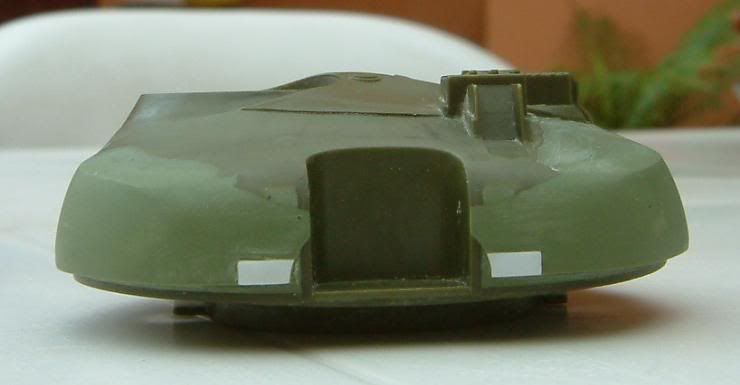

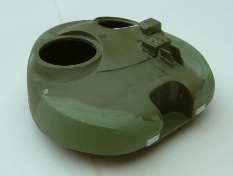

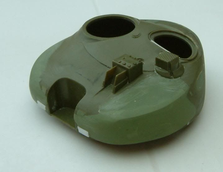

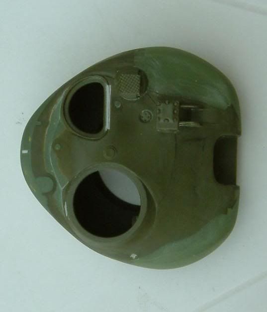

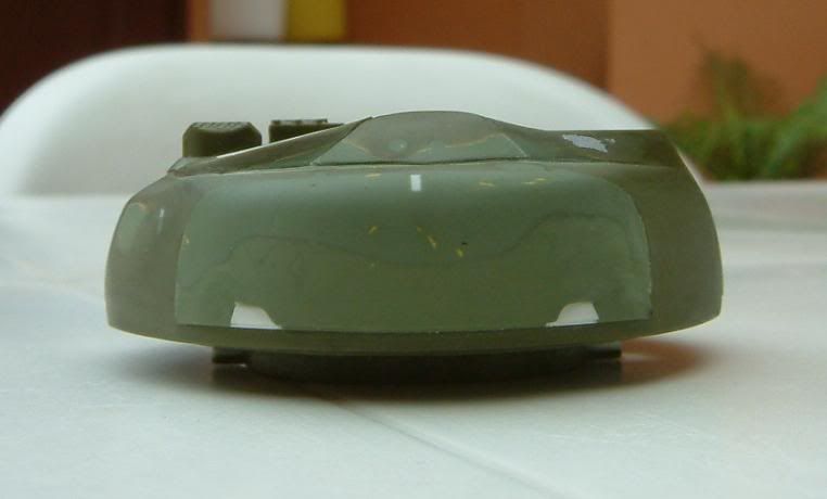

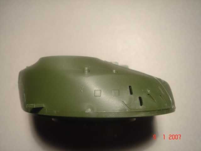

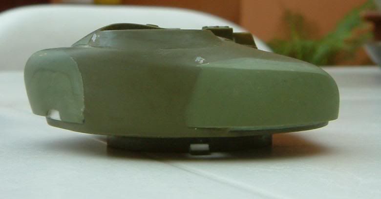

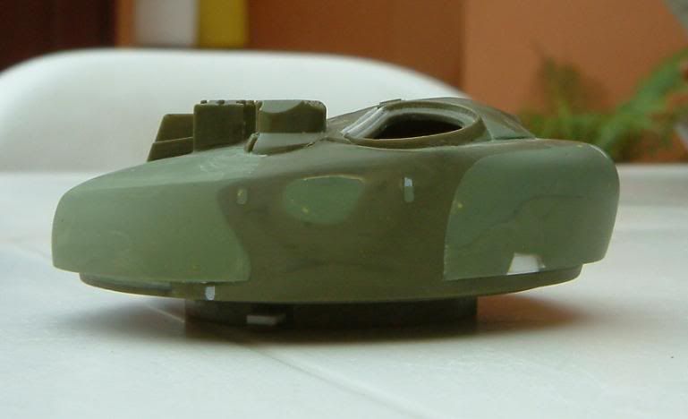

I’ve posted this earlier in a Spanish forum. That’s what I’ve done: a lot of epoxy putty and sanding was required for giving the turret the right shape, then the turret ring was lowered about 1 mm, using brand-new blades and some sanding. It’s not finished yet, I must give it the cast texture and some other minor details, but I want you to see this progress, as I’m using the original kit’s turret and I’m not using photo-etched sets or aftermarket items in my project, only some resin copies or spare parts from other kits. Comments and suggestions are welcome. Thanks for watching. Most regards.

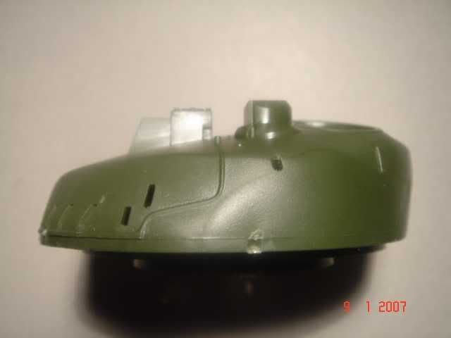

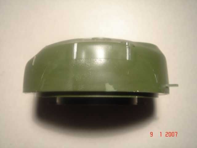

OK, OK… I think that’s the point… Well, here are the pics:

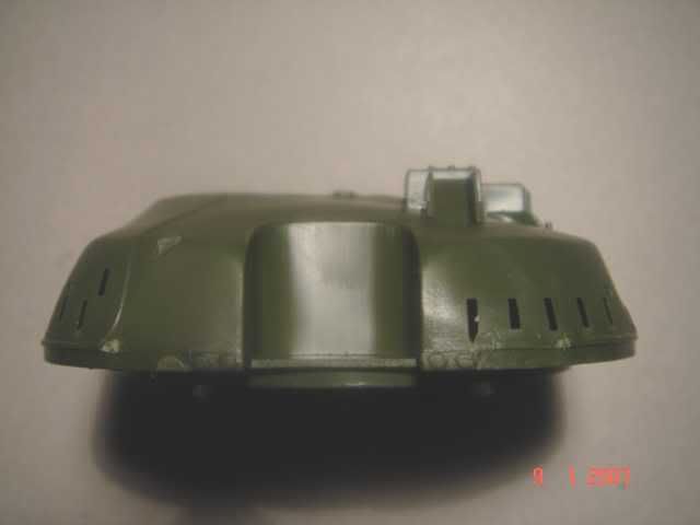

As you know, the top pic was taken fron the unmodified Zvezda turret, and the bottom pic was modified by me. Most regards.

Yeah, I’ve already read it, That’s why I sanded off about 3 mm from the turret front. First I applied the epoxy putty at the turret’s rear, and then sanded to shape. I added about 3 mm to the rear, matching to the plans I have, but at that time, I haven’t read the article, then I read it and it said that the hull roof is 3 mm short between the glacis and the turret front,. So, as I’ve added 3 mm to the rear, I removed these 3 mm from the front, now it match my plans perfectly. The next time I’ll post the finished turret. Most regards.
