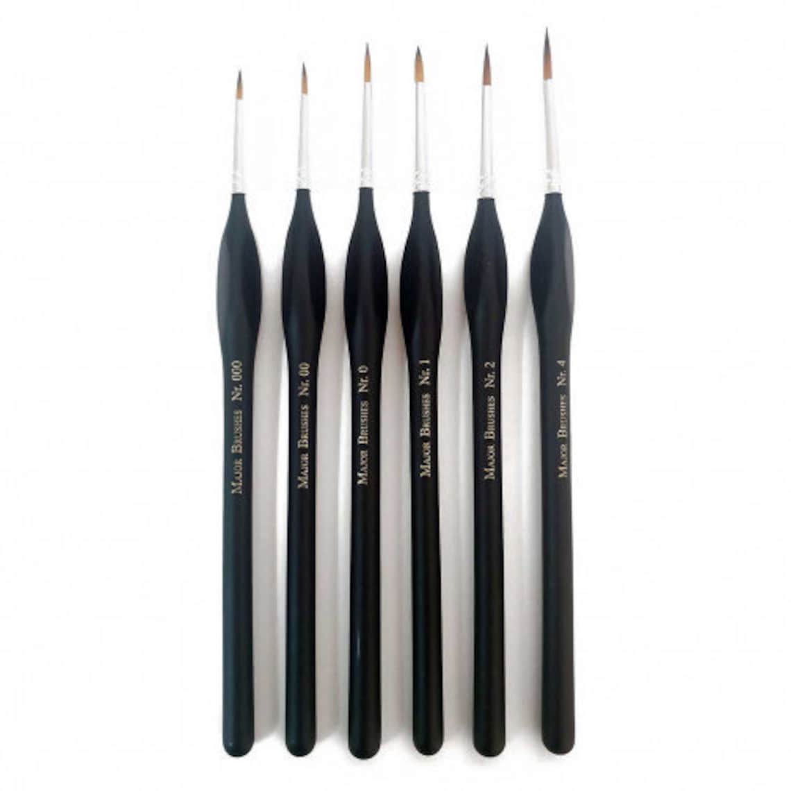

Search for Triangular Art Brush in the search engine of your choice.
You should find something like these from the online vendors of your choice, such as Major Brushes Triangular Grip Detail Paint Brush Set of 6.
Major Brushes Triangular Grip Detail Paint Brush Set of 6 image 0
