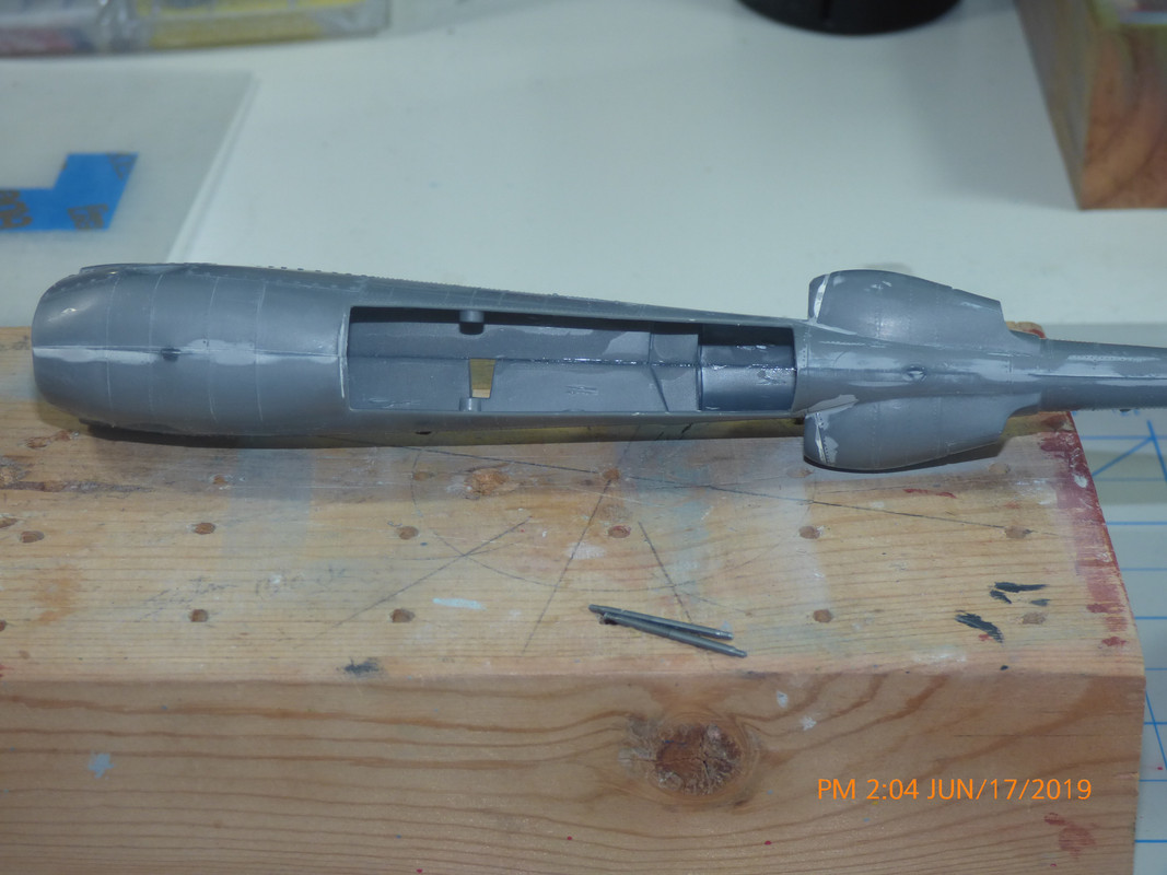

Novice question: I’m trying to build a 1/48 Revell P-38J - Droop Snoot variant. Just getting back into modeling as an adult, and find I’m in need of some basic jury rigging advice. This fighter will hang in flight above my basement workbench (need to avoid wifely ranting so won’t hang from dining room chandelier).
Anyway, I assembled the two engine nacelles with the landing struts trimmed to fit closed and without the tires. I find the main gear outer doors just won’t fit in a closed position. I’ve tried stuffing the space inside with a mix of paper towel and aluminum foil, looking to provide support for the doors in a closed position, but can’t get an apparently decent fit such that I’m prepared to apply glue.
Seems from a related post that the majority of you expert types build gear down. With this P-38 however, my trimming of the struts has foreclosed that option. I’m stuck with doors that fit like redneck dentures (don’t ask for clarification on that metaphor - it‘s 5am and what the heck am I doing up already anyway?).
I guess ill need to pick up some modeling putty whatever I do, but the fit is so off I just don’t know how to proceed. Any advice will be sincerely appreciated.
I’m building some 1/72 scale early jets and I’m posing them in flight, gear up, on display stands. The first thing I do is make sure the landing gear doors fit. This sometimes takes some sanding and shaping to get the doors to fit the space. Then I glue the landing gear doors in place, very early in the assembly process. For an F-84F and a T-33A I’m doing the nose gear doors when on before the fuselage halves were joined. Later some PPP and Bondo and sanding and shaping were needed. The gear doors on kits meant to be posed with the gear down seldom fit the space correctly when closed. In the case of your P-38, I would have attached the landing gear doors before closing up the booms, sanding and shaping and fitting before gluing. Since you have already closed up the booms, you may have to glue in one door at a time, holding the door with a pair of tweezers until the glue sets up a bit. And if I am closing up the landing gear doors, I just don’t use the landing gear struts and wheels. Good luck. I hope this helps some.

Have you tried holing each door in place while you tack the corners with liquid cement? Then take the tape off and cement the rest of the seam.
If there is a bottom inside the wheel wells, you can always knead together some two part putty (like green stuff brand). Place a wad at both ends and press your doors into place. Any excess will just squeeze into hollows, and depending on the brand, you have a good two hours to make adjustments. This assumes that your doors have been corrected to fit properly beforehand.

I have the same kit you’re dealing with on my workbench right now (mine will have the gear down,and I just epoxied half my supply of BB’s in the nose so that it will sit on the gear). The problem with gear doors on this kit is that there is nothing to glue the doors to in order to fix them in the up position. I recommend that you take some bits of styrene sheet and glue some attachmen points to the wheel well outlines in order for you to have something to glue to. Without attachment points, the doors kinda have to sit out in the open space.

I glue the doors together if they are two parts. I glue the center seam . Then place in the opening .If they are too small this allows me to use plastic strip to close up any holes .
I do NOT put the struts in in any case .Cutting them off will not produce any bracing as such and the strut stub isn’t needed . On single doors I remake them out of plastic thick enough to fit the hole without a hollow and sand to fit then re-scribe the edges .

I’m just returning to this hobby at 75 with models I bought at 25, and came up with a solution by using masking tape (Tamiya is good because they have different narrow sizes down to 1mm wide). I select a size not quite as wide as the bay door but somewhat longer than the exterior door surface. I then apply adhesive to the edges of the door, then lower the door into the bay and secure its position on the exterior of the fuselage/boom and let the adhesive dry. So far, its working!
