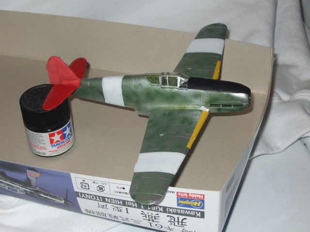

I have painted the cammo free-hand.Next up,I have to paint the black-out panel and the red tail and horizontal stabilizers. s.
I painted the black-out panel,tail and yellow wing roots today.I have yet to decide wether to paint the white home-defence bands.
The cammo look’s real good, I like it.
By the way…it’s an anti-glare panel, not a black-out panel.
Yes that’s right!Here is another view
She’s really lookin good!
I have decided to paint the home defence bands because they look very cool!
Some further progress:
Added some decals today.Wow!The white home-defence bands reallly make the Hinomarus “Pop”!
Did the other side today
That kit look’s real good man, how did you do the camoflouge?
Well I used my Paashe VL with a #3 tip.Here is the tony with the prop temporaily installed.
