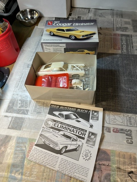

I went to my first model car show last month, the NNL North event in Inver Grove Heights, MN. Came home with some kits I’m going to attempt to build up. Each of them will have some unique challenges I’m very much looking forward to overcoming.
The 73 Cougar is going to be a pro-touring car. The 69 Cougar Eliminator was a $5 parts kit, missing window glass, tires and interior tub. I thought the GTX was a complete kit for $15, but turns out its missing the taillight lenses, door handles, and headlight glass. So that one will become a custom hot rod. I’ll improvise the missing parts and find what I can in my parts stash.
But first up will be the 69 Cougar, check it out… the prior owner grafted on a 69 Boss Mustang roof, soooo, I can’t - not build it up.
I picked up an interior tub and windshield (from a 71 Boss Mustang) on Ebay. I’ll fabricate a rear window :crossed_fingers: and find some tires and wheels in my parts stash.

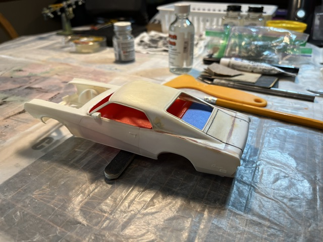

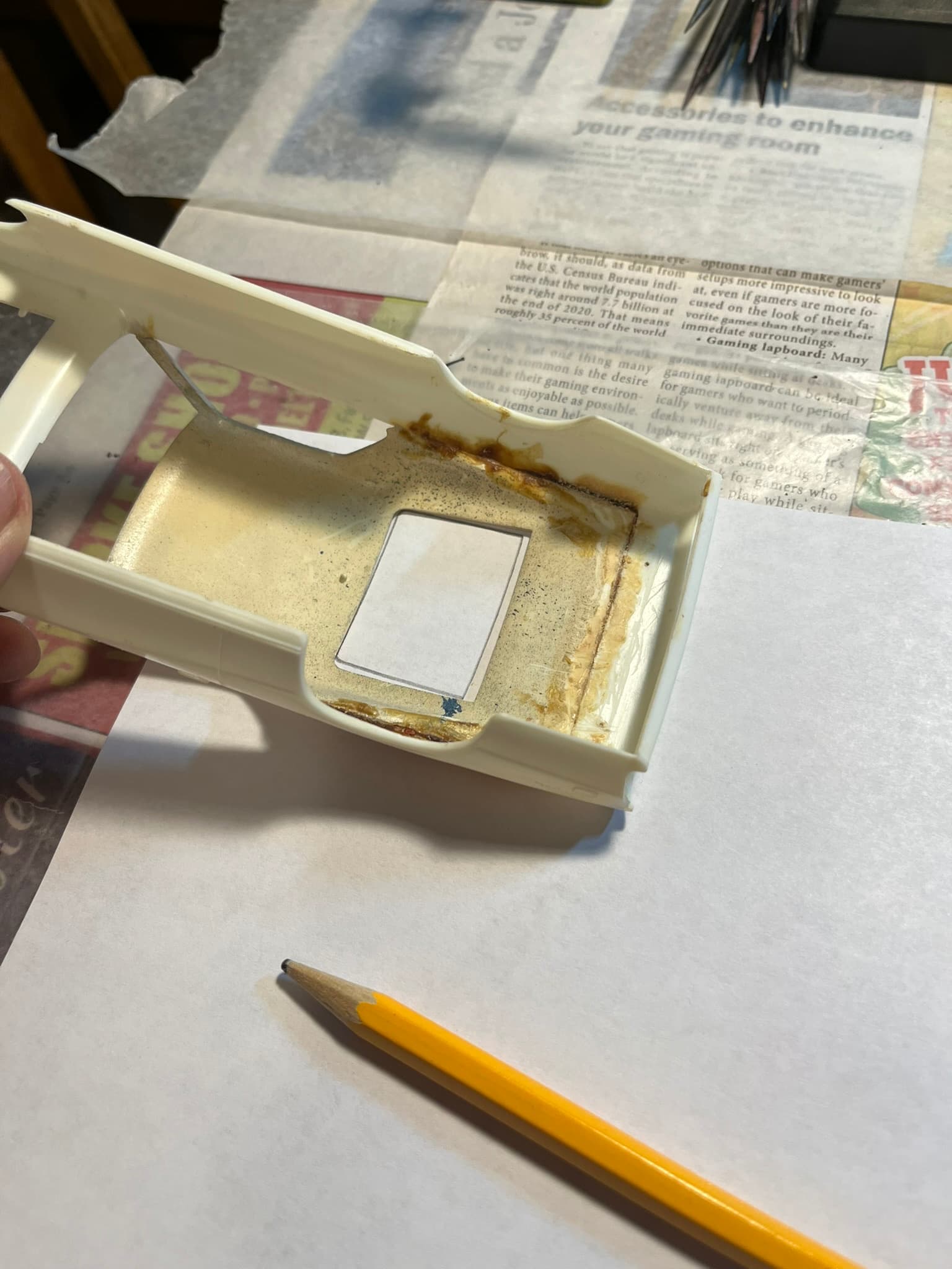

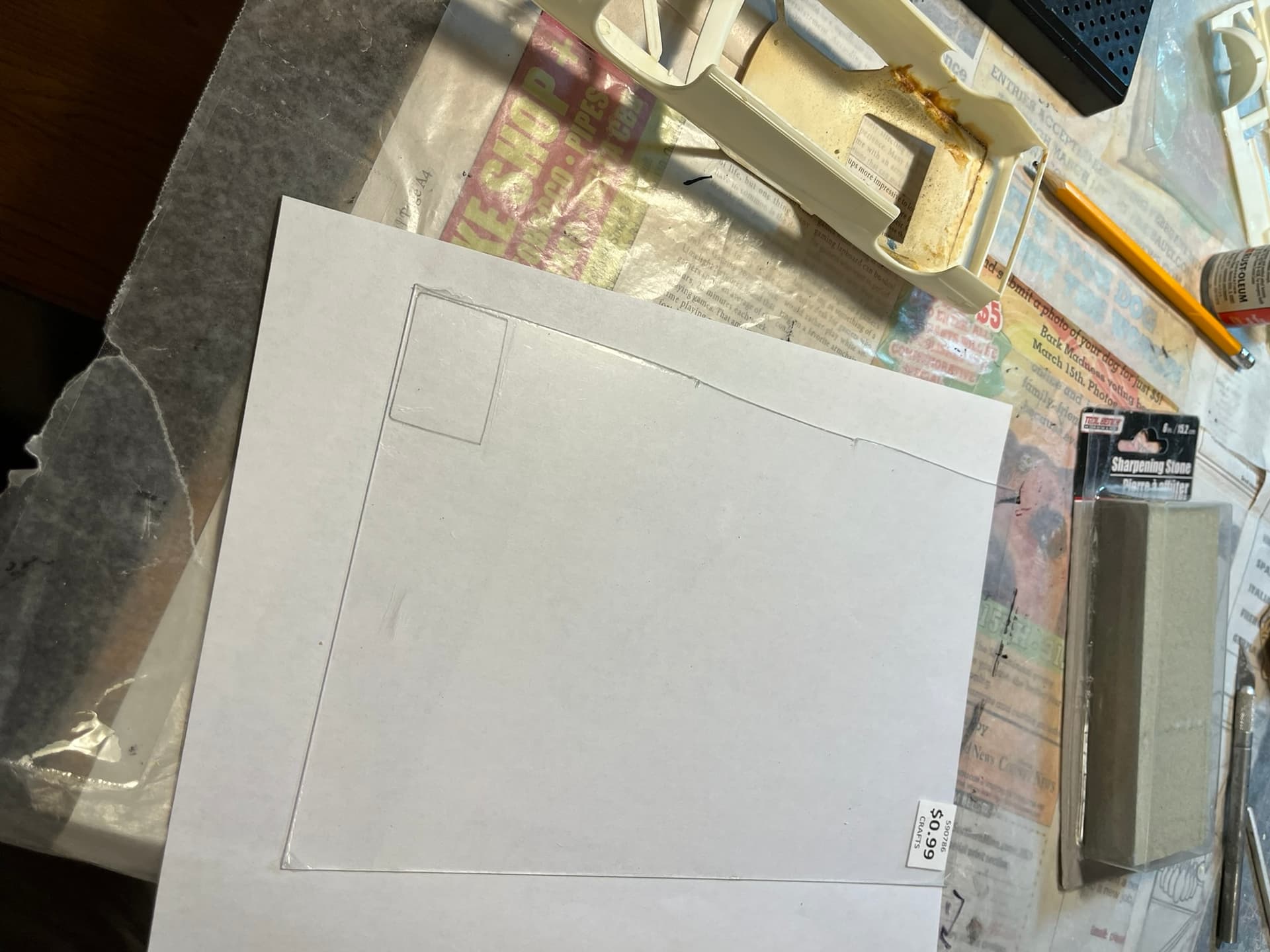

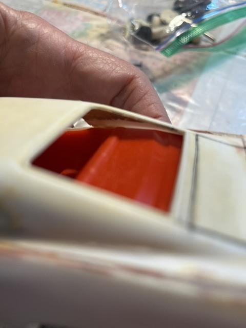

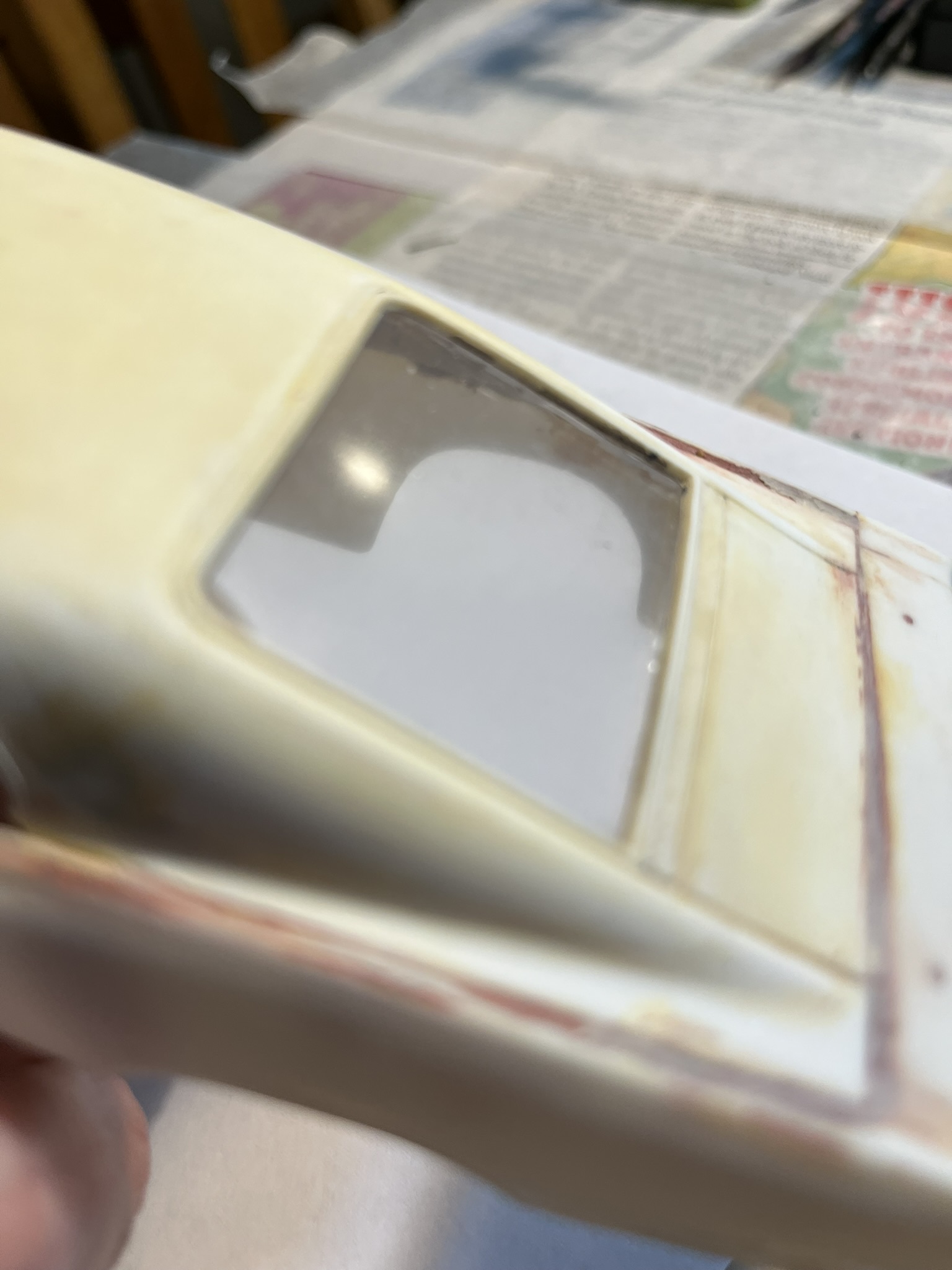

Progress report on this WIP: Got the rear window cut out of a piece of thin lexan ($0.99 at Hobby Lobby).

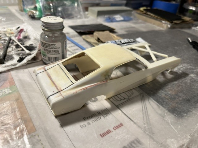

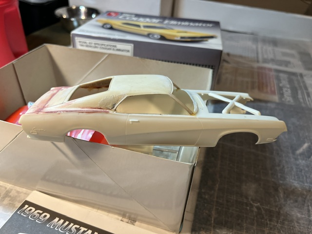

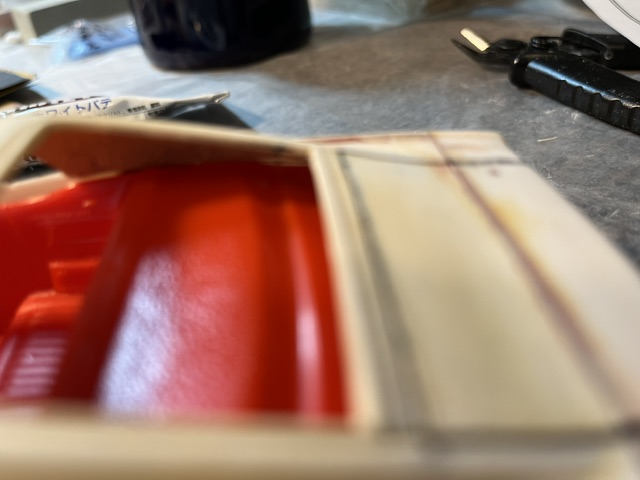

Did some body work. Sanded it down with 100 then 800 grit and a sanding stick. Puttied the roof seems and filled the Cougar’s trunk lines that will not be used with the new roof. Scribed the new custom trunk lid lines. Used some sprue glue on butt joints from the grafted roof to strengthen it a bit more (although it was pretty tight, one of the A pillars came loose). Its looking much better.

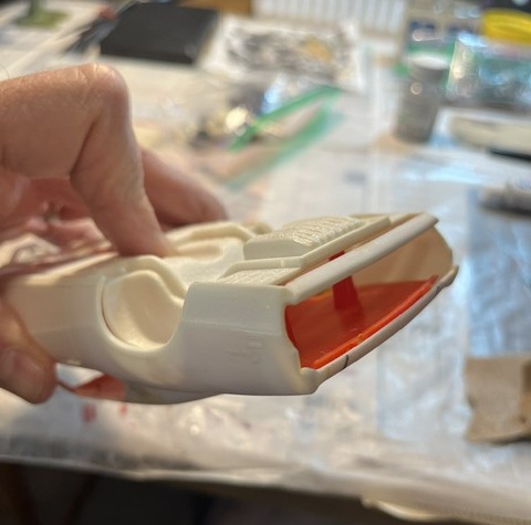

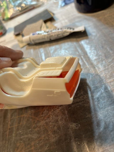

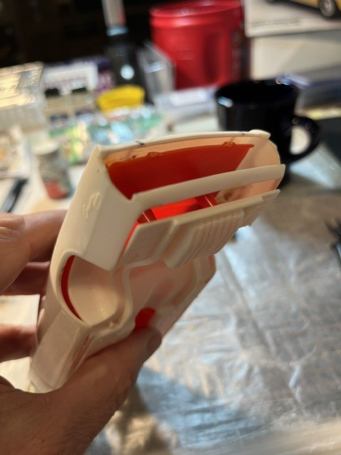

Started test fitting the interior tub, chassis and body. The chassis is hanging out below the rear fenders a bit. Looks like the C pillars of the fastback roof are contacting the upper back seat area in the tub. I will need to carefully correct that to make sit in there a little deeper. I plan to carefully sand/grind out the inside of the C pillar and see if that will be enough to fix it. I would rather not sand/grind out the rear seats and back shelf if I can avoid it. I’m finding it helpful the interior tub is molded in red, it helps me see where the contact points need to be addressed.
Any suggestions on the best approach to seating the tub deeper? :thinking:
Stay tuned…
More progress. I used a Dremel to grind down the inside of the C Pillars and ended up also grinding down the edges of the interior tub at the rear seat on both sides. I also used 100 grit sand paper to finish carefully. Looks like it seats much better now.
Next I will start some assembly before primer is applied. Then more sanding where needed. More primer, then with any luck paint.

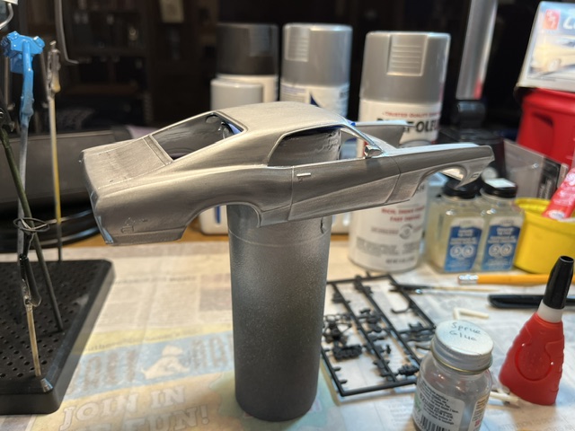

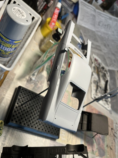

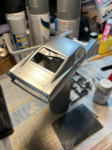

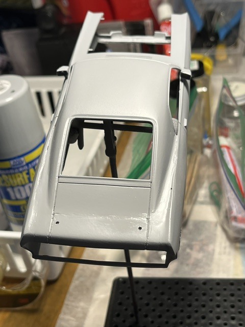

Primed the body with Mr. Surfacer 1000. Did some additional sanding and filling on the graft seems along with some sanding on the C pillars and rear fenders. Then re-sanded and primed the bare spots.
More sanding, and base coat of metallic aluminum with finish sanding after that.

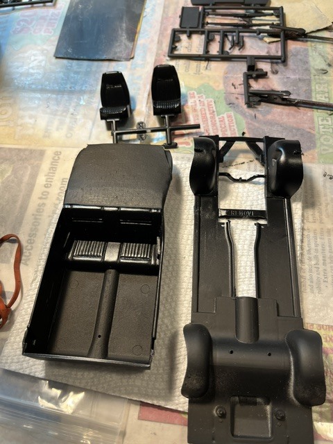

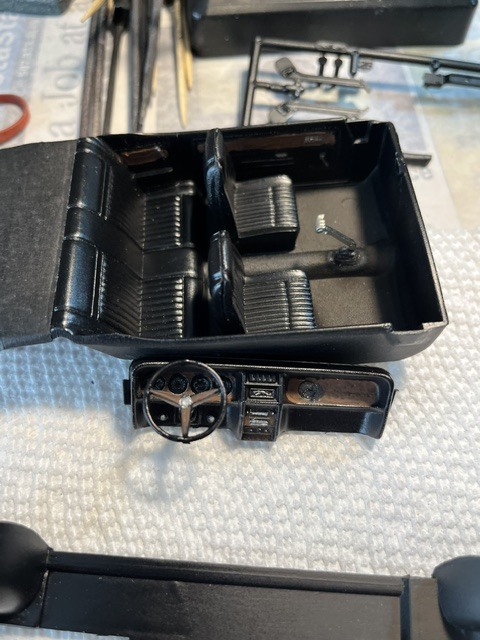

Painted the interior tub with flat black primer. Then masked the floor and rear shelf and sprayed it with Mod Podge matte clear coat. It gives the seats and dash a deeper color with the appropriate shine for a vinyl interior of the period.

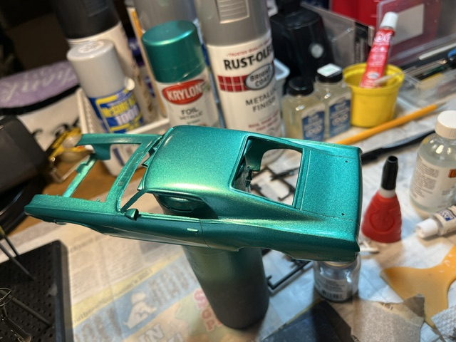

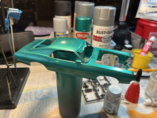

I’m planning to spray the body with Krylon Green Metallic Foil for a candy green finish color. The engine bay will be a satin black.
Got some color on it now… scratched the hood so that will need to be sanded and repainted, but the body is looking good to me. The color is just what I had in mind for this car.
Beautiful Teal color!
Thanks Rob. I like these Krylon foil metallics. Their blue foil is really nice as well.

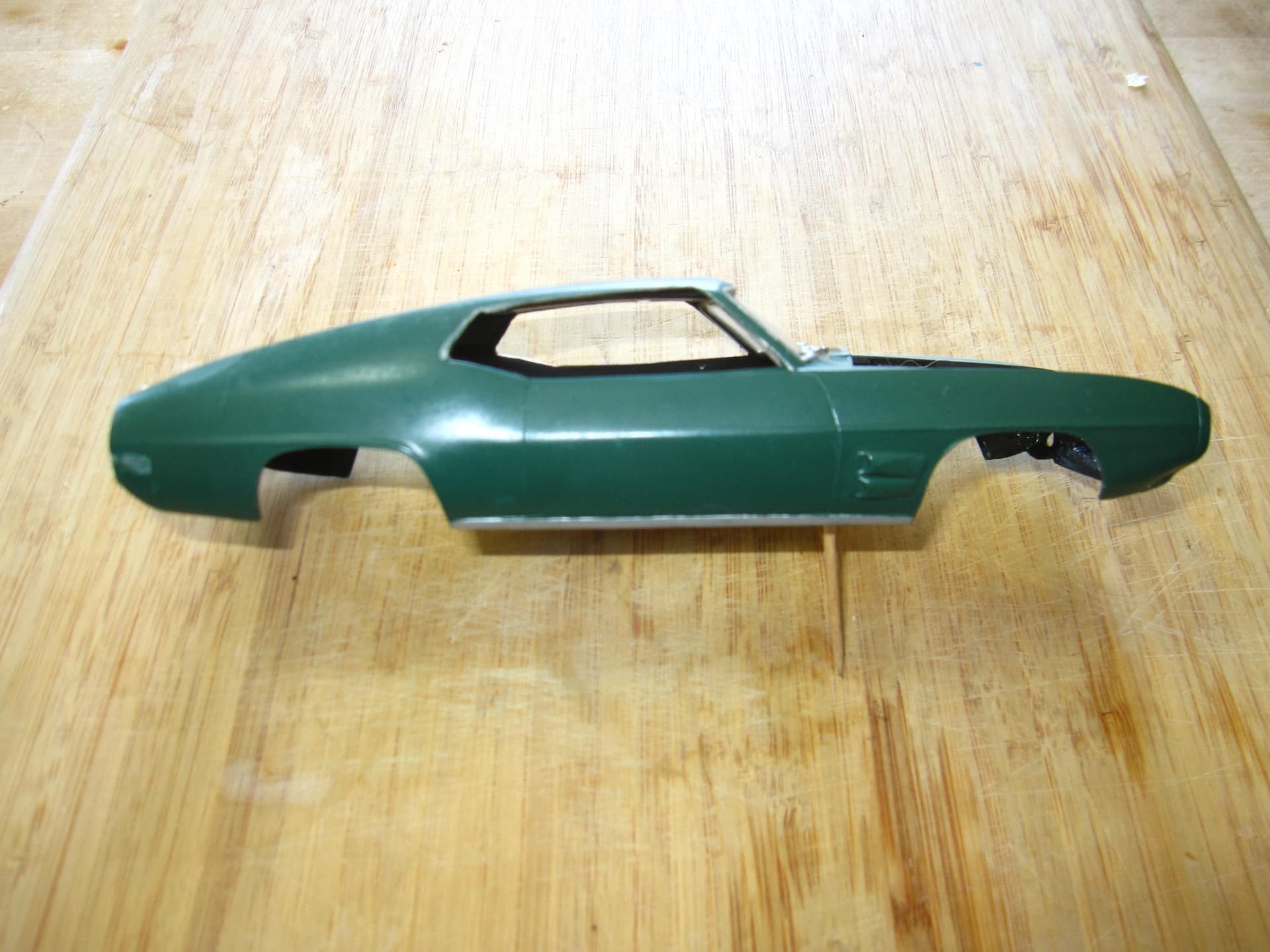

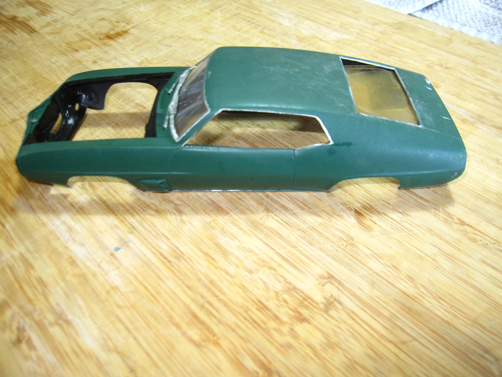

I like it. Long ago I grafted a '71 Mustang fastback roof onto a '69 Firebird. I’ll have to see if it is still in the parts box of old cars.
Color is similar to the Ford factory Gulfstream Aqua paint in '68 - '69. Pic from the internet.

I found the '69 Firebird fastback body in my box of bits but it is looking a bit old and worn. This was done 40 years ago or more. I like the Cougar shape better.
Wow, I really like that. Seamless graft there. I don’t think I can get the Cougar as smooth as this.

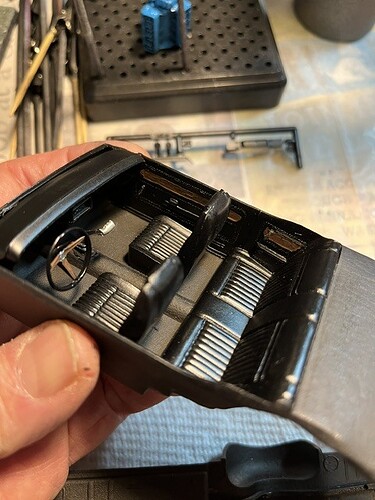

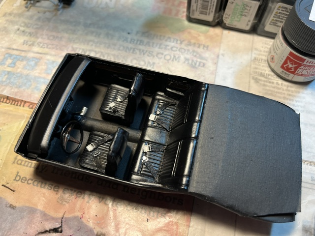

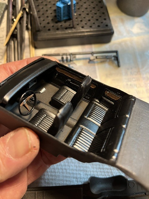

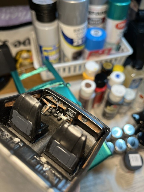

Here is where I am with the interior so far. Needs a little detailing still. I used brown craft paint for wood grain effect, chalk pencil for the gages, silver gel pen for chrome details so far. Used a dull coat on the chrome shift knob.
Next, I’ll add seat belts front and back. I have some fuzzy dice for the rear-view mirror, but not sure I can get them to work in this one.

I found the Firebird fastback interior and noted I had done the same as your Cougar, with a long flat shelf behind the seats. I had cut the front fenders off the '71 Mustang and with a modified hood fitted them to a '69 Mustang fastback body. That made the '71 roof available for the Firebird. I didn’t see the modified '69 Mustang in the pile so I expect it is long gone.
