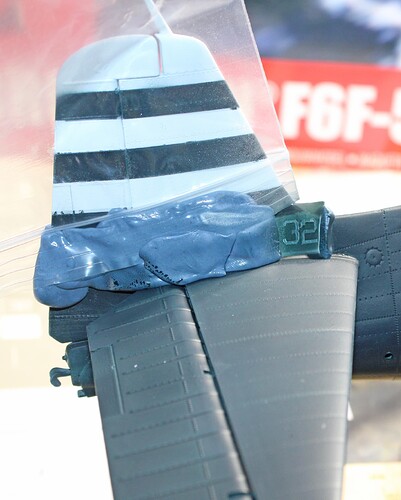

But today is a new day. After the painting I did manage to get in last night, I pulled back the masking to reveals that the entire left side of the rudder was perfectly striped, whereas only the uppermost stripe on the right side was acceptable. So I re-masked and got ready to spray some thinned white paint through my new, used-once Eclipse Takumi. And you might have guessed it, but it didn’t spray.
I watched a bunch of Youtube videos last night on cleaning these things. I didn’t really learn anything new, but one in particular stuck with me, so I opted to utilize what I saw in that one. In that one, they suggested using the Airbrush Cleaner that comes with the Iwata airbrushes but to soak the relevant parts in it for only 10 minutes. Then as @Toimi_Tom suggests, scrubbing everything when done. This I did for every Iwata that I own.
The results were no spray for my new -CS, the -CR, and the Takumi (seriously, used once! And it’s not like I didn’t clean it thoroughly last night). The -BH sprayed. Curiously, so did the old (bought in 2011) -CS. So I was able to get the white stripes re-painted.
Now we’re starting to see a Hellcat on my workbench.

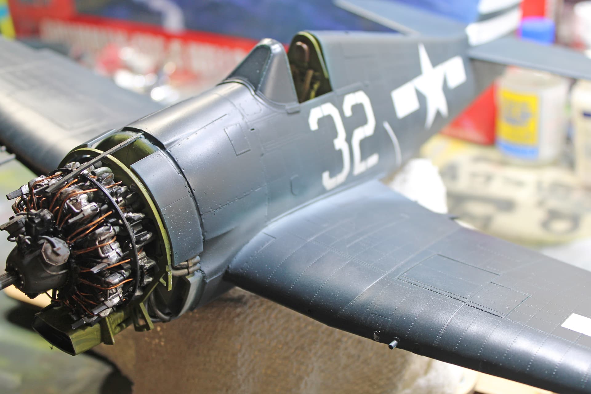

Today I completed some touch-up paint work with the Glossy Sea Blue, including adding the plane # to the rudder with the vinyl mask made for the kit. I also masked the prop tips and painted that big prop semi-gloss black, and I masked the wheels so that I could paint the tires tire black.
Finally, after a bit of time for all the paint to dry, I removed the vinyl masks to reveal all the markings. The masks performed well to a point, but there was some bleed under of blue onto white. Will touch that up maybe tomorrow. Then the smaller 32’s done in white (cowling ring and gear door panels) pulled blue paint so that I have white blobs around otherwise crisp numerals. I’m pondering how I’ll fix that. The mask set includes two full sheets of masks, so I still have 4 of those that I can use to redo the markings. Or I could simply try to hand paint some blue to tighten up the numerals, but I have doubts as to how that will turn out.
