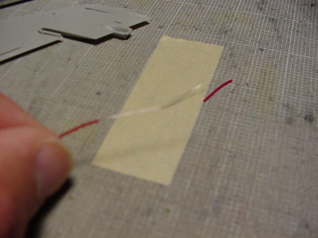

Next thing I did was to make an electrical wiring bundle to run along the length of the fuselage and along the bulkheads. I stripped the insulation from a length of steel wire that came from a small toy electrical motor, painted it white and installed it. (This type of wire is very thin and perfect for making such wire bundles/harnesses.) This also will have some damage applied to it later during construction.

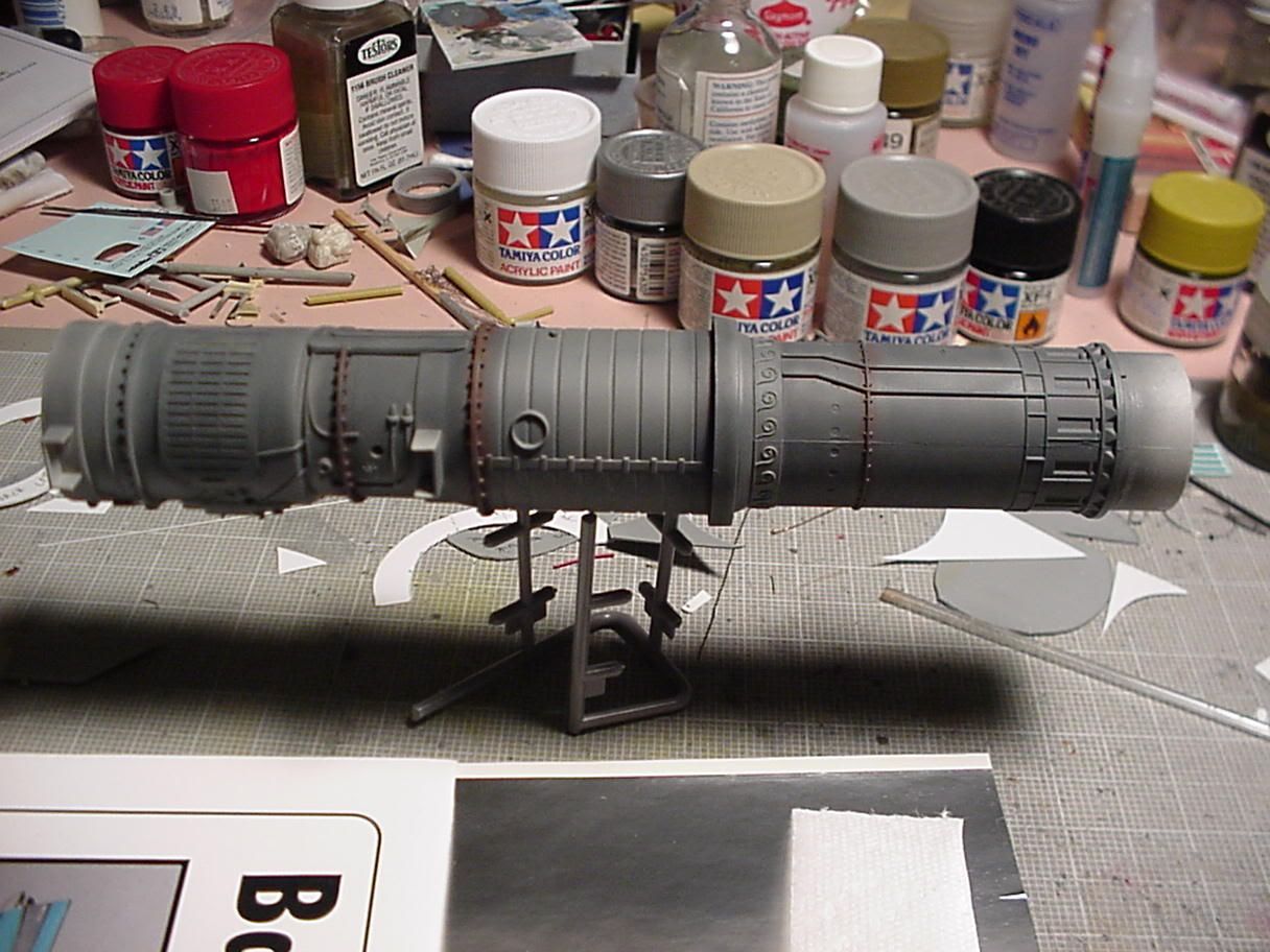

I assembled the engine according to the instructions and painted it with Tamiya acrylics.
http://i3.photobucket.com/albums/y78/Csaulet2001/assembledengine.jpg

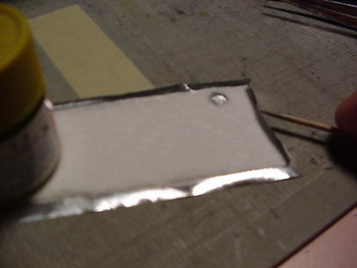

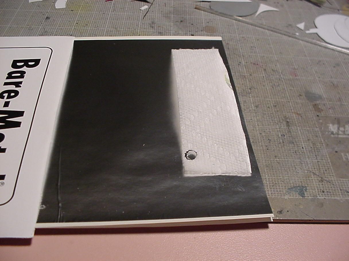

The colors used are dark gray, NATO brown, aluminum, and titanium. Then the engine was given a black wash, weathered by dry-brushing oils. The NATO brown seems to have a very good shade for simulating rust on the areas that have high operating temperatures. (Squadron F-105 in action had a great photo of this.) The engine has a thermal heat shroud that is wrapped around the afterburner pipe. I made the shroud by measuring the diameter of that area then cutting a piece of paper towel to size. I cut a piece of Bare Metal Foil slightly larger than the paper towel and folded over the edges to cover the paper towel edges. I wrapped the completed shroud around the pipe and used 5 minute epoxy to hold it in place. If you’ve ever seen such engine shrouds up close as I have, then you’d be able to see that there is a texture in the shroud. The paper towel simulates this quite well and the Bare Metal Foil is so thin that it shows it.

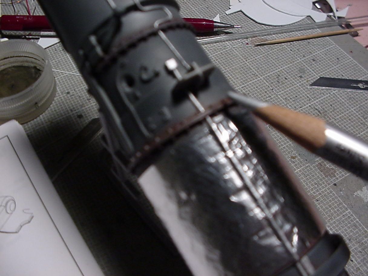

I also used a silver artist pencil to highlight the bare metal areas.
