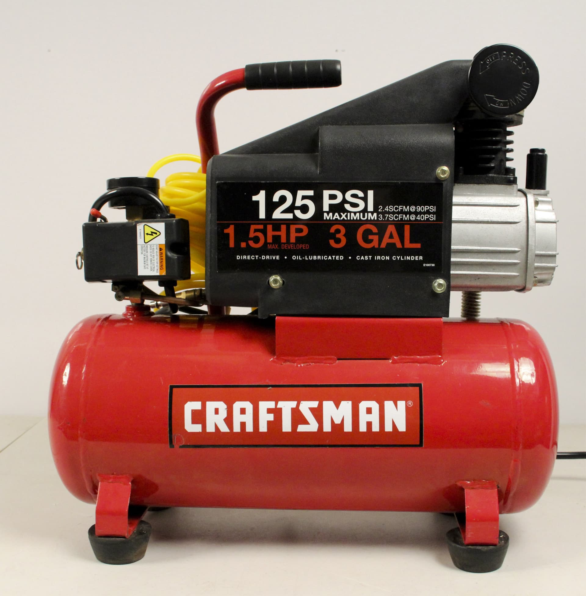

As far as a compressor goes, I got one that I use for my airbrush but also for tools in the garage. It’s a Craftsman 1.5 hp, 125 psi compressor with a horizontal tank:
If I had to get another one, I would get one just for airbrushing, probably one of the Iwata models that allows hookups for 2 brushes and is as quiet as a refrigerator compressor.
