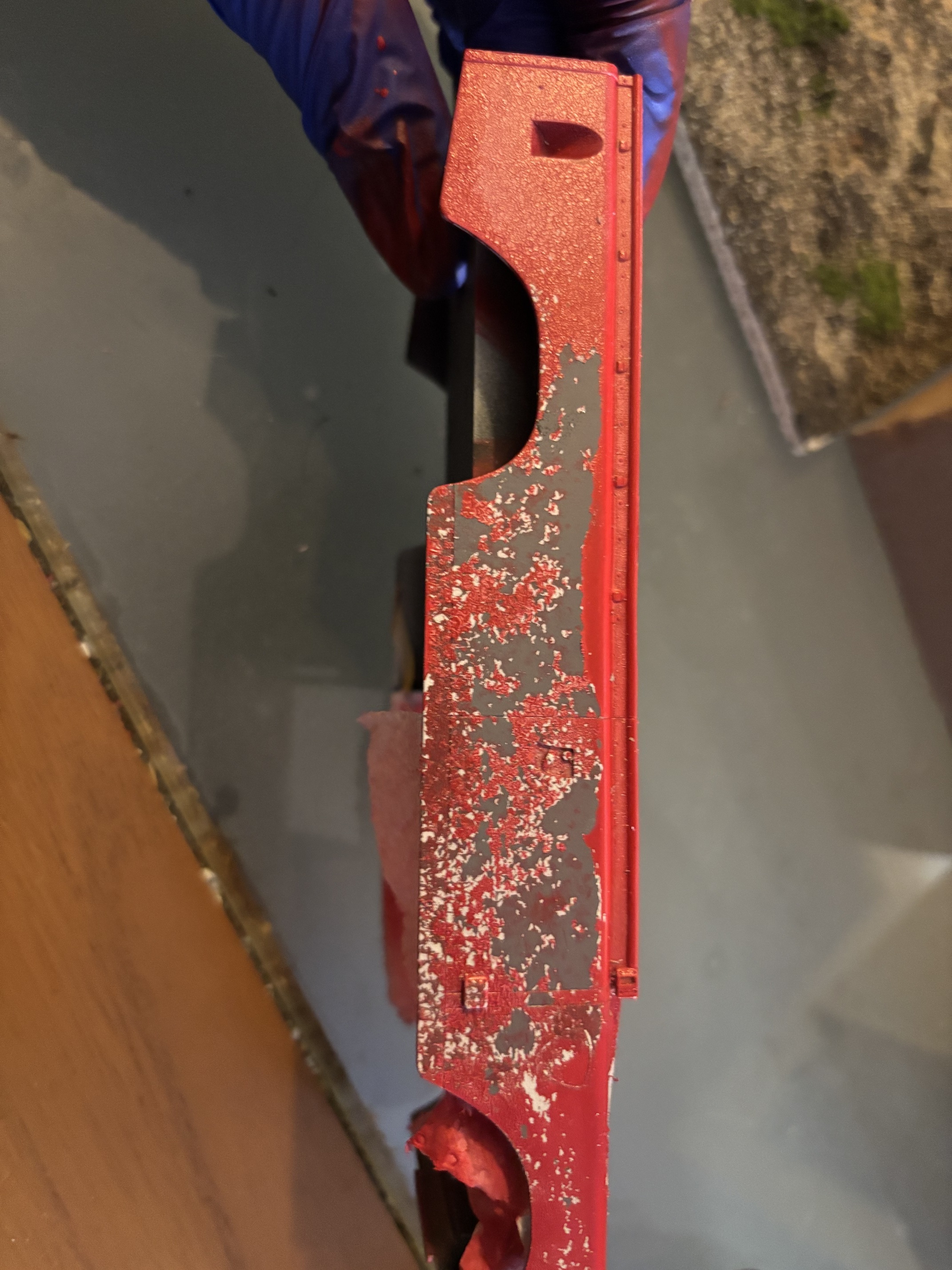

I have had an issue with my spray painting and need some advice?
I have found when I sprayed the top layer of humbrol acrylic gloss red over my base coat of plastikote enamel gloss white the acrylic had stripped the base coat and I’m unsure why?
How long did you let each coat dry?
Between 24-48 hours, painted on an acrylic humbrol coat but the spray version causes the same crinkle effect
I’m may be wrong, but I believe Humbrol paints are all enamels. Did you thin the Humbrol red with enamel thinner? That would eat the Plastikote enamel white.
Is the Plastikote enamel white intended to be a primer?
I’m still learning myself and don’t know what else to ask, but clearly something in the red is not compatible with the white.
Hope this helps. Sorry.
Cheers,
Mark
No humbrol have an acrylic and enamel range what I’m going to do is strip the paint and start again with acrylic on acrylic
Spraying acrylic over enamel is a big NO NO. Reason being that enamel paint takes ages to dry out properly although feeling dry to the touch as they leach out into the atmosphere for a long time after application. Acrylic is like spraying a watertight plastic coat over the enamel and the leaching out has to have somewhere to go and eventually bursts through the acrylic. The picture put up shows a classic case of this. But you can paint the other way around as when acrylics dry it is perfectly OK to use enamels on top.

I just learned something important, thank you.
