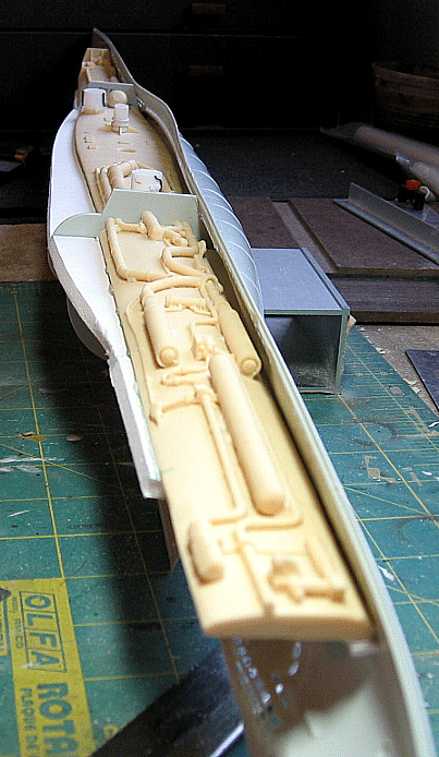

I’ve been toiling away at my Revell 1/72 U-Boat. Got really familiar with the grinding accessories on the ol’ Dremel clearing out every little hole in the hull- this really is a submarine with screen doors! I’m adding the Yankee Modelworks pressure hull. It’s a nice casting, but not without it’s flaws. Seen from above, the piping on the cnter and rear sections does not match up! It’s not quite the “drop-in fit” that’s advertised- I had to do a fair amount of guesswork to position it, and then lots of foamcore board to cover the gaps at the sides. Gobs of hot-glue stuck the filler in.

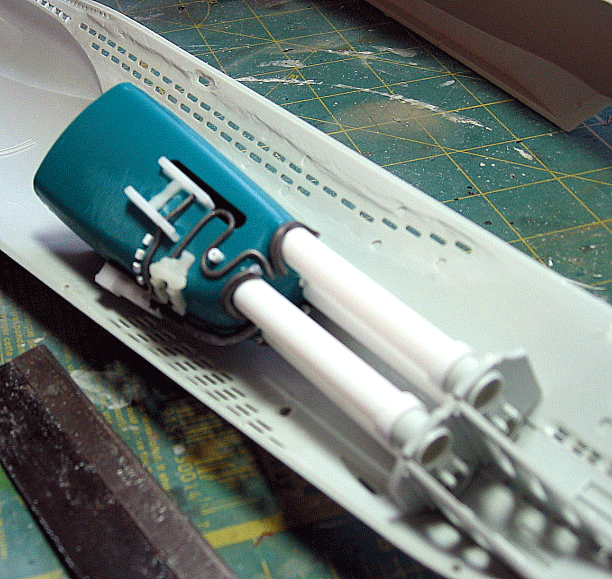

Because the torpedo tube areas are very open to venting I built up a forward lower hull from a bunch of, well, crap. Solder, the end of a long butane lighter and bits from its workings, as well as various bits of stock styrene tubing. Here’s a shot it in all it’s majesty…

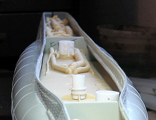

In the gloomy depths of the hull I’m hoping it will look convincing.

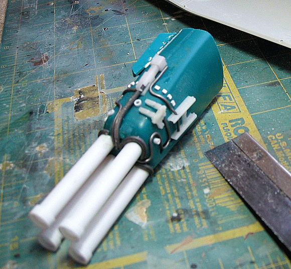

Here’s the aft tube, meticulously crafted from more detritus, including part of an allergy spray dispenser. How many of you, comrades, can’t throw odd bits away? Show of hands, please! :lol:

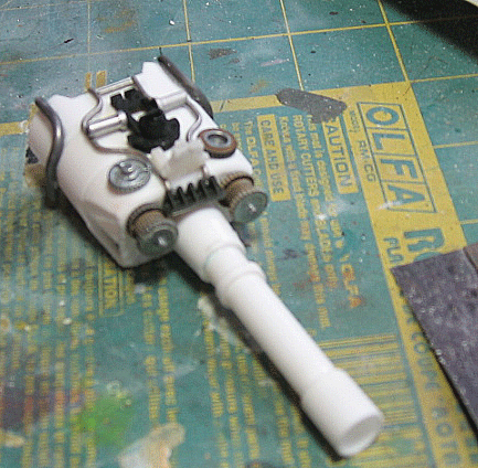

I extended the hatches and the 88mm gunmount up to the deck using the same true-to-scale dedication… still have to dope some structure in for the base of the fighting room in the conning tower. Time to cannibalize another old remote control!

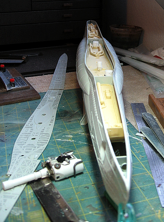

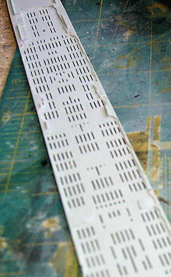

I set up an ersatz rounter with my Dremel locked low in it’s drill press to gring\d away at the underside of the deck- with pretty good results. Only a few tragedies to clean up, and the result is a see-through grillwork.
Here’s the whole thing temporarily clamped together and sitting in it’s cradle- quite dramatic in the failing light of Saturday afternoon, dontcha think? Tomorrow (hopefully) I’ll spray the “unseen” portions of the inside black, start noodling color on the torpedo tube sections, and glue this dawg together. Then it’ll be time to paint the pressure hull and get serious with the photoetch parts of the deck…

Looks fantastic. Don’t forget the air intake piping that extends up under the wintergarten deck or the sky periscope housing that extended into the pressure hull. It’s ashame we won’t see a lot of the detail of the the hull. It’s good that you used the kit’s deck, although the slots are out of scale, you’ll probably see the hull better through them versus the modelbrass. I’m not sure about the deck gun mount being extended like that though. I’m pretty sure that those slats fit right up against the deck. However, it’s really the kit’s fault due to the fact that its not a perfect cirlcle like the real pressure hull was. The kit is too flat. Keep up the great work and keep us posted, please. Take Care, Jess
I have to agree with Jess about the brass deck. Modelbrass’ deck is very nice; however, with all the flood vent openings I did in my boat, it’s still very difficult to see the Yankee Modelworks casting through the openings in the deck. I still prefer the brass to the kit original for the reason stated; it’s more scale like openings and thickness.
Yes, the Modelbrass is very nice. I definitely prefer it over all other decks, especially with Eduard’s stern and bow sections. Take Care, Jess

Great job! That is one hell of a task to clean out the deck slots. I have built several of these boats and have only drilled out the hull flood holes and that was a task by itself. It would be nice to add all the CMK inner compartment details, leaving one side of the hull with see thru sections, while leaving the opposite side solid. Unfortunately, each compartment section is coming out to over $30 and will add up at the end[:(]. Another thought would be to model one at waterline level with a bridge and a gun crew in action. A lot of the lower hull detail will be lost if modeled in this fashion. Please post more pictures as your build continues.[tup]

colagero: I think you’ll be able to see enough through the openings to be intrigued- I’m a U-Boat novice, and had no idea of how these things worked. The structure is fascinating, and the end result will hopefully get the point of a whole semi-hidden portion of the boat across. As for the gun mount- check the diagram in Squadron’s U-boats In Action, as well as others- it was definitely extended, although by a post and big, fat gussets. I may have to build up some big, fat gussets now, too!

Hi, Bilbirk- I opened all those drain and vent hulls in the hull along the deck line, at the lower front and rear areas, as well as a long slot above the saddle tank bulges- these had styrene dividers inserted at teach line if rivets. There are round holes and squaresh ones- seems like there are hundreds! I also routed the deck out from beneath, as it was slotted- (seems like millions of slots!) all these openings were necessary for the ship to dive and surface quickly. I opened 'em up because I’m some kind of nut. I may or may never enter this thing in a contest- we’ll see. I have seen some examples of the kit built right out of the box that look really great with all the little recesses left just as they are, just painted black. Simple!
