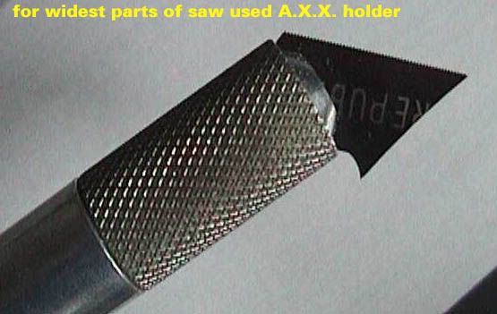

I prefer CA for this, because it is much easier to control. However, I don’t use a scribing tool over it. Scribing tools are more like an adz or hoe in terms of material removal, and when they hit something harder or softer than usual, they tend to chatter and chip. What I do is very lightly run a toothed No. 11 blade along the scribing guide. Sometimes I use this tool to do the whole line, sometimes I switch to a regular scriber.
To make the toothed blade, which is not the same as the fine No. 11 sawblades you can buy, you need a motor tool and a thin abrasive cut-off wheel. With the No. 11 blade chucked firmly into the handle, and eye and face protection firmly and properly chucked onto your head, cut the smallest notches you can into the edge of the blade, then run it over a fine sharpening stone to remove the burs.
The JCL micro-saw is supposed to be good for this, too. I have one, but haven’t tried it yet.
Ross you are the man. I just got my JCL saw and I never occurred to me to use that. Good point about the void too. So thanks to all that suggested the CA and good call on the saw.
I corresponded with a Czech modeler a while back and he made a small tool from a piece of the blade that I think will be ideal for this.
