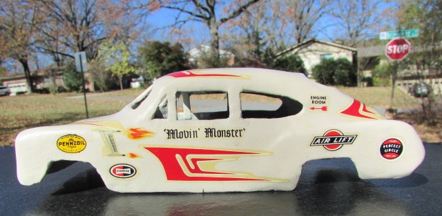

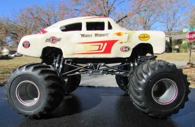

1951 Chevrolet Fleetline
(1) http://www.diecastaway.com/index.php?topic=69785.msg686105#msg686105

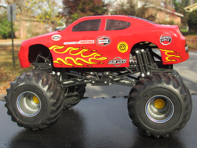

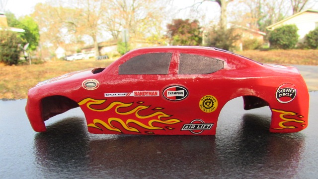

2006 Dodge Charger R/T
(2) http://cs.finescale.com/fsm/modeling_subjects/f/4/t/186944.aspx

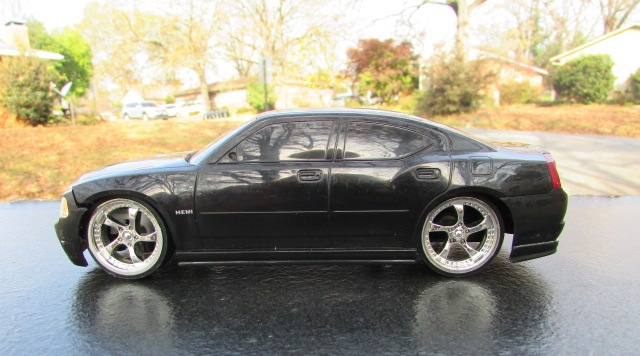

Mold = original scale plastic or diecast model you want to copy

On my first cast, the 1951 Chevrolet Fleetline, I used a non-stick cooking spray as a release agent. This turned out to be a huge mistake as the sticky “goo” got on both my hands, making for the application of tissue and toilet paper to the mold a real mess. The paper ended up quite wrinkled on the mold, and sticking to my fingers when trying to position it on the mold. One must also realize that oil and water do not mix, so applying water-based casting material and glue onto paper might not allow for it to adhere to the paper. The multiple dillemas here are that you want the paper to conform to the mold without a lot of shifting around; but you also don’t want the cast to stick to the mold when all the casting layers have been applied and the cast is to be finally removed from the mold. In addition, you want the casting material to stick strongly to the paper which, ideally, would be oil-free. The cast did come off the mold fairly easily; however, the initial layer of paper had saturated the cooking spray and did not accept any casting material, thus remaining dry, weak and flimsy. Also, since a few layers of tissue paper were used in the cast, moisture was permanently trapped between the inner and outer layers of paper, thus not allowing the cast to harden properly.
On my second cast, the 2006 Dodge Charger R/T, I used a section of roll kitchen towel. It was perforated some. I did not use any liquid release agent on this mold. After applying the paper to the mold and brushing the paper with a mixture of white glue and Elmer’s Wood Filler and letting this harden, I applied a second coat of the filler/glue mixture. After hardening, I sought to remove the cast from the mold. This required a careful peeling-type process, getting in between the mold and the cast by using a thin, flat, narrow piece of metal and using my fingers to gently pry and separate the cast. What I found was that the perforations had allowed casting material to seep through onto the mold, but the spaces in between the perforations did not, so the adhesion to the mold was rather weak and the cast came off fairly easily. This was aided by the fact that there were no undercuts on this particular body style.

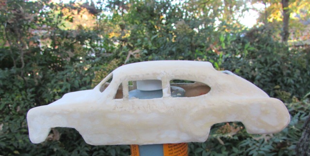

Additional layers of casting material are applied , sanded and formed to obtain a final smooth surface to the cast. Having the cast on the mold lends good support for filling, smoothing, inspecting, sanding and ease of handling when performing these various tasks. Corrections to imperfections in and on the surface and problems with body areas are also corrected here as well.
See how the surface needs to be filled and sanded smooth:
(https://postimages.org/][img]https://i.postimg.cc/HLqBLbxn/Tutorial-Guide-to-Paper-Models-019.jpg[/img][/url)]
(https://postimages.org/][img]https://i.postimg.cc/3NcyKF8b/Tutorial-Guide-to-Paper-Models-020.jpg[/img][/url)]
A major and extremely important consideration is how to treat the windows on the cast. Obviously the windshield should be cut out from the cast. It is debatable whether the other windows should be cut out also. What determines this is whether or not doing so would jeopardize the integrity of the cast as a whole. If the cast were to be jeopardized as such, a workable alternative to cutting out those spaces for the windows is using black decals or black paper pieces applied to those appropriate window areas. I spray painted a sealer on the back of black colored paper and applied these facsimiles using a Glue Stick as an adhesive to the cast.
What I found, in Case 1 -1951 Chevrolet Fleetline, was that by cutting out all the windows, this seriously weaken the support pillars of the roof as well as the roof itself. Consequently a substantial amount of reinforcement material went into beefing up the underside of the roof and scabbing on wood and metal pieces to the roof pillars. These structural problems could have stemmed directly from using tissue paper as the starting point of the cast as opposed to perforated paper which appears to make a much stronger shell. The point here is to carefully access how cut outs for windows will impact the structural integrity of the overall cast. You don’t want to get to this advanced stage of completion and fatally remove sections of the cast that would essentially “destroy” the cast. The window cut out situation is a point of no return. Give this extra attention and thought. There is no easy turning back after the cuts are made.
