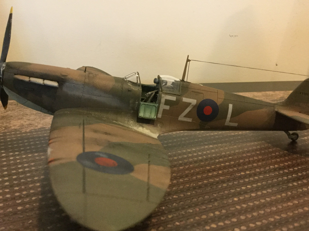

3rd ever model please critique
Sorry haven’t figured out the multiple pictures thing yet. So this is my 3rd build. The 1/48 Spitfire Mk1 from Tamiya. I used it as a weathering canvas. Please respond with tips and critique on areas that need improving.
Thanks for looking and sorry for multiple post and poor picture quality.
Crituque: the seam in fromt of the windscreen could use some more attention.
Comment: for your 3rd model…very well done, practice is the only way to improve so. Your on the right track[Y]
I really like the weathering and exhaust marking, but it almost too clean. Brit warbirds did not get a lot of prettying up, as they were extremely busy, especially during the early years / Battle of Britain. They landed, got fueled and reloaded, and then back to it.
All in all, a very nice job.
Overall, very nicely done! Especially for this being your third build. Looks like you have a good solid base of building skills.

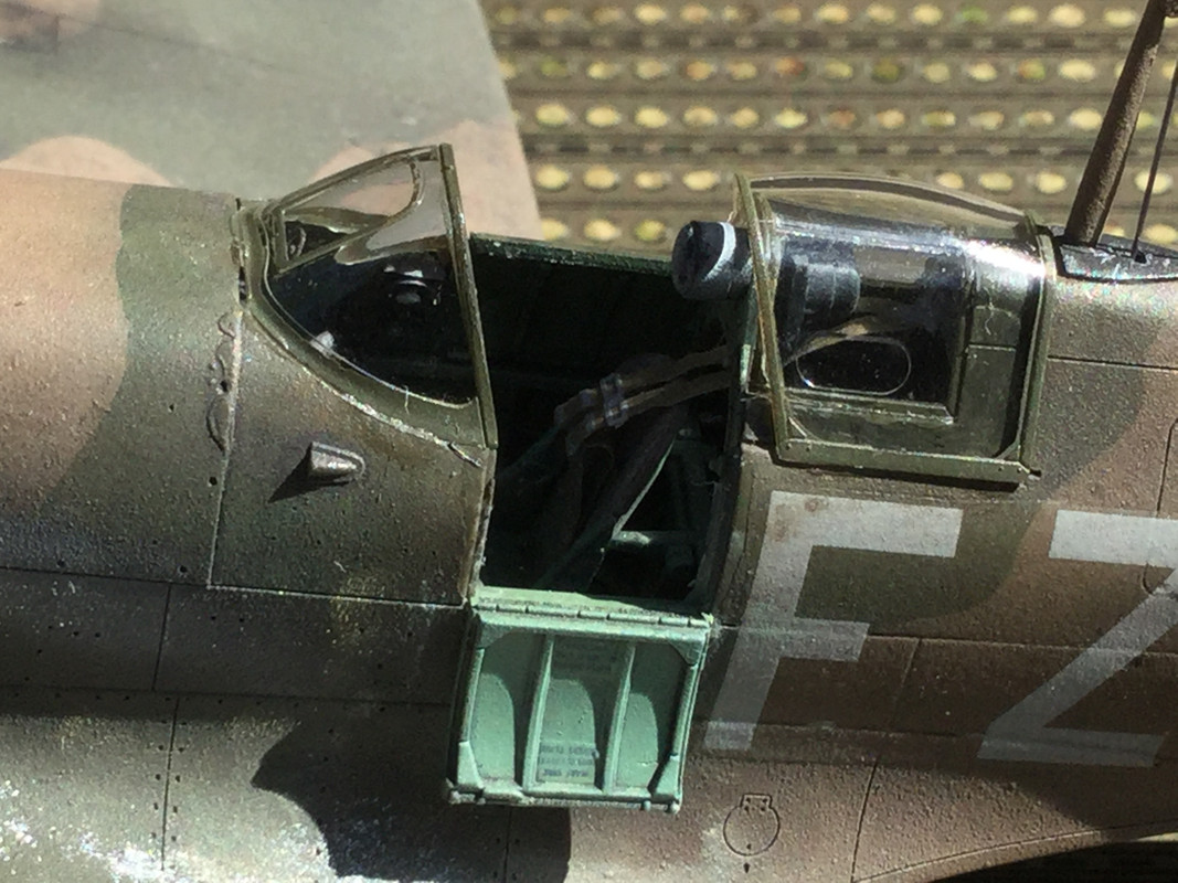

The only things that I see (and small ones at that) to critique are both here in this close up:
one- the excess glue or whatever it is on the vertical panel line near the windscreen, that could have easily been cleaned up before painting with a bit of sanding.
two- your canopy framing paint work is a bit translucent, that is easily remedied in three layer painting. Inner color, a black middle layer, then lastly the external color.
You have definitely got this.
Hey!
You’re not gonna to try to fly that worn out looking thing are you? Nice job for a third build ! The only critique I have is this. You need to build more!
No Kidding! the things are few that I would call you on. The poor fit of the bottom front canopy,The translucency of the frame, as Stik said of it and a heavy lump in the seam on the forward panel edge. Minor stuff!

It’s all about patience and looking ahead before you do it.
You should fill in the seam on the fuselage behind the cockpit and, (not being able to see the bottom) probably in the same location on the bottom also.
For a third model I’d say you’re doing just fine.
It’s just like target practice, you have to keep at it.
!https://media.giphy.com/media/tgSLiTm3PVECA/giphy.gif
Thank you very much. I appreciate the advice and #4 will hopefully be better. It’s been so much fun building and learning as I go. Again, thanks to all of you.
Someone mentioned the seam behind the canopy. I think thats the antennae wire shadow. I can be a little sloppy but not that bad.
Stay safe everyone.
Zoomed in on it the first time… but I REALLY zoomed it again big time and the antenna base gives it up as a shadow.
It sure looked like the seam.
That’s a very close coincidence.
Click on it to zoom in.
Sorry 'bout that…
!https://u.cubeupload.com/Disastermaster/seamorshadow.png
Hey Disastermaster I appreciate you taking the time to give it a look. I actually went back and looked at the model again. I asked myself “Did I miss an enormous seam on this thing?”
Another newbie here, still working on my third model, as well as a fourth and a fifth, and not very secure in my skills. But I like your Spitfire a great deal.

Congrats on your third. [Y]
I hope you keep building and posting. And having fun.

Spitfire camo is more difficult than it looks and you really nailed yours. My only comment has been noted before, which is the glue and gap around the windscreen.
Thanks for all the additional comments. Time to take what I learned from all you brilliant modelers and apply it to the next one. The F4F Wildcat.
