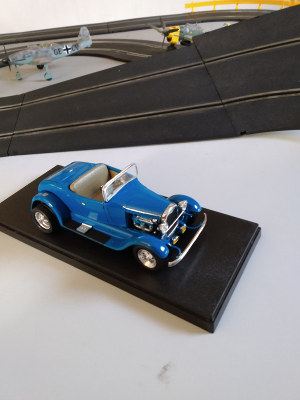

This is my '29 Ford Model A Roadster Lowboy. It is painted with Tamiya TS-53 Deep Metallic Blue. The model features a wired small block Chevy with three deuces with an automatic transmission, chrome mag wheels with spinners. It also has a '32 front grille and scratch-built radiator supports.
A few more…
Turned out great Mike. Looks good in that blue.
Outstanding job Mike!!! [t$t][t$t][t$t]
You keep making them better and better.
Jim [cptn]
Stay Safe.
That looks fantastic. I can hear the engine running now.
Thank you lurch, Jim and John!
Very nice build Mr. Mike-great looking hot rod. I have this kit in the stash and I like what you’ve don with yours.
Thank you Bob!
philo426, no comment, just a picture. I don’t understand?
I really like the dropped axle and 32 grill in that front view,Mike ! Always have liked that look.
Thank you oldermodelguy! I was going to use the '29 grille and radiator, but I wanted this '29 Model A to be different from the first one that I built.
Turned out nice. I like the color.
Thank you Olezippi!
