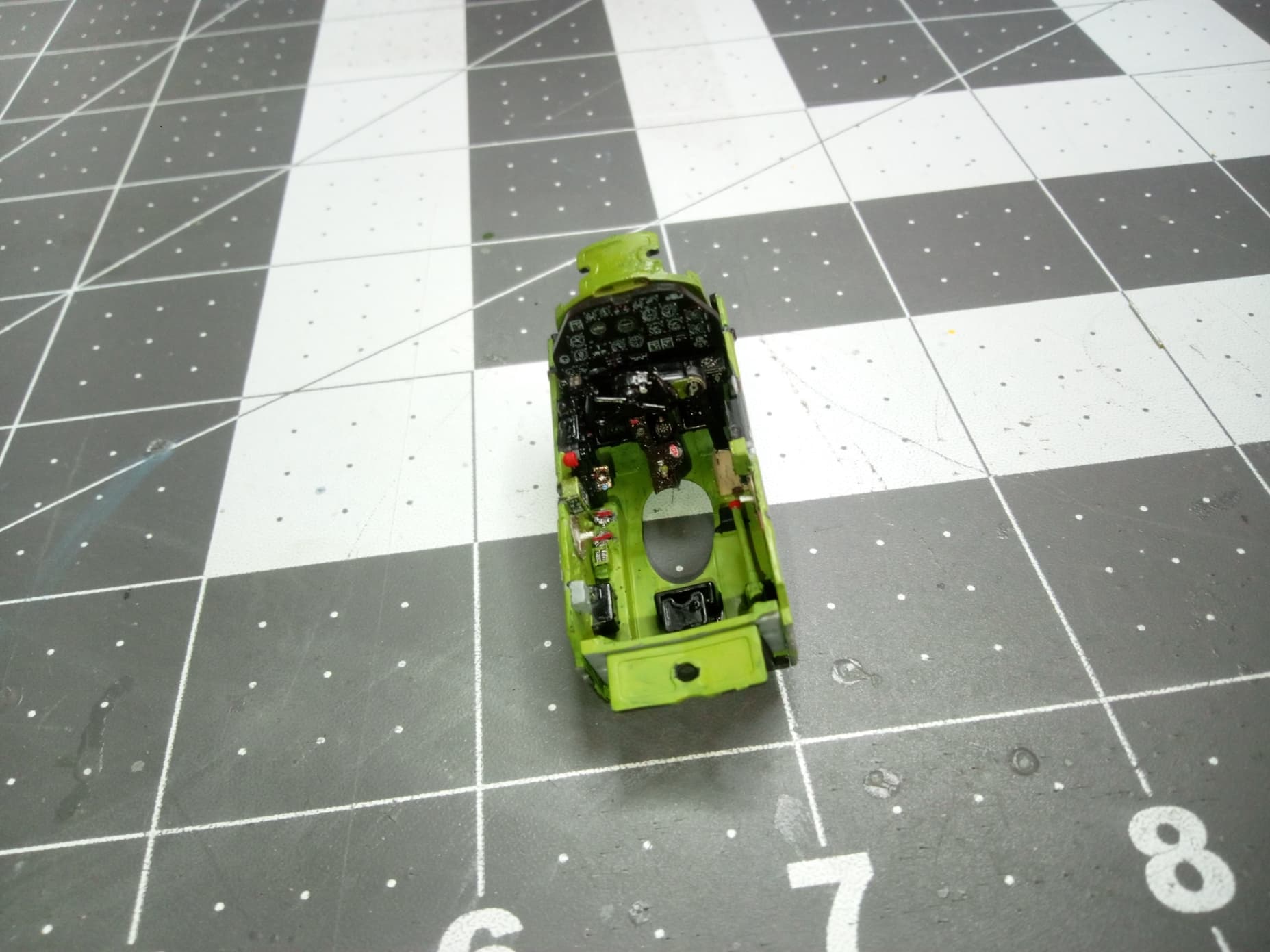

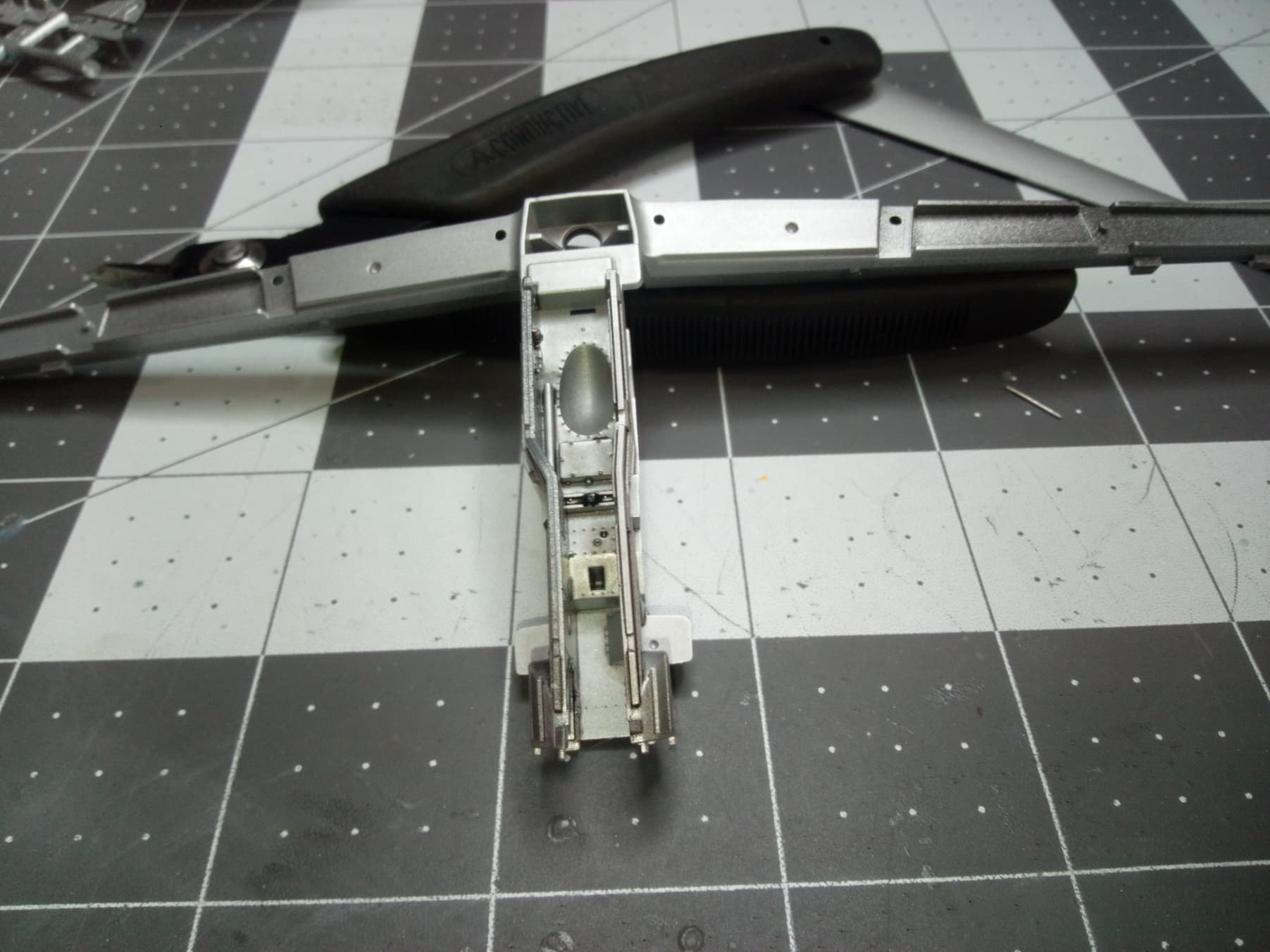

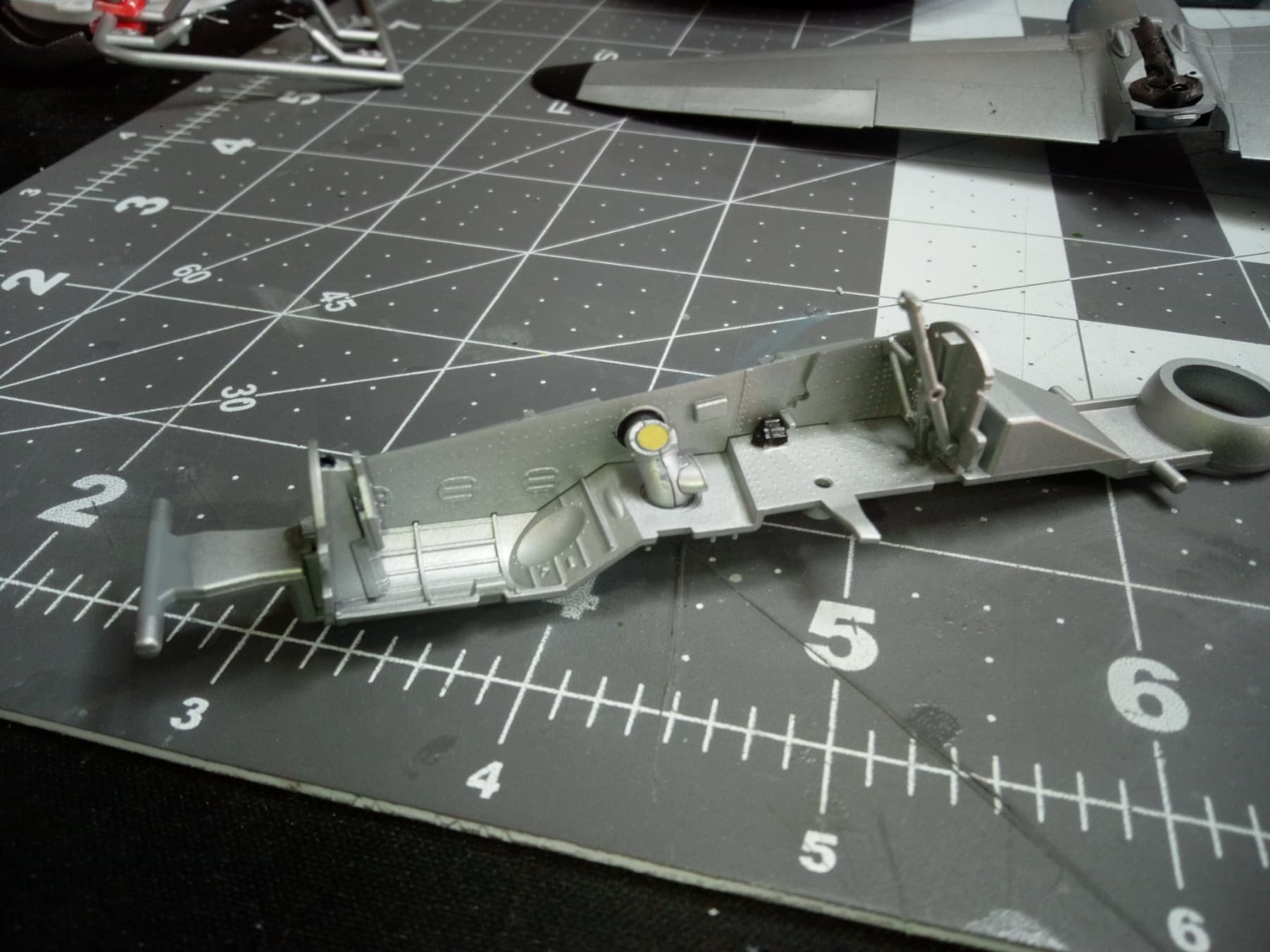

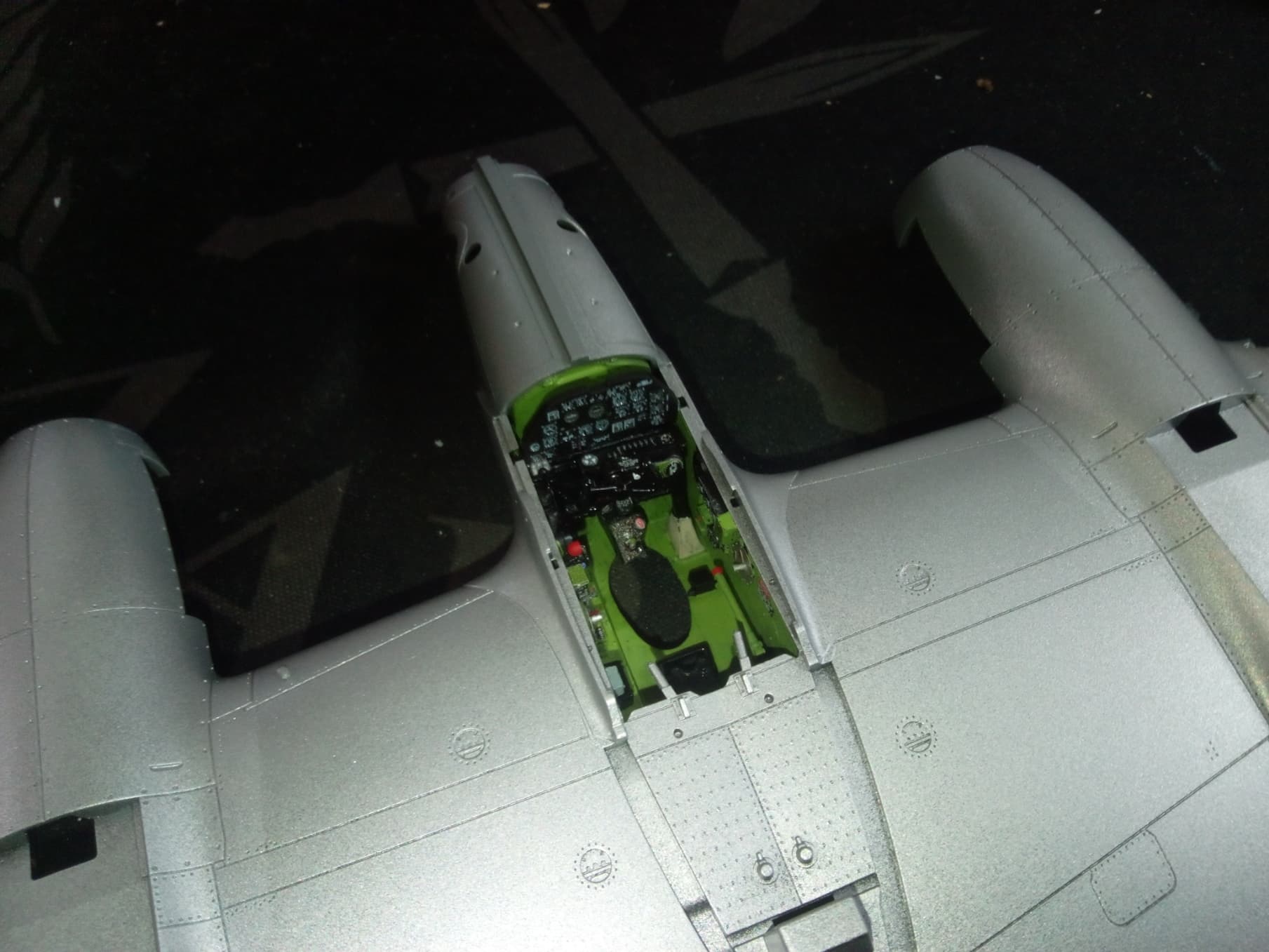

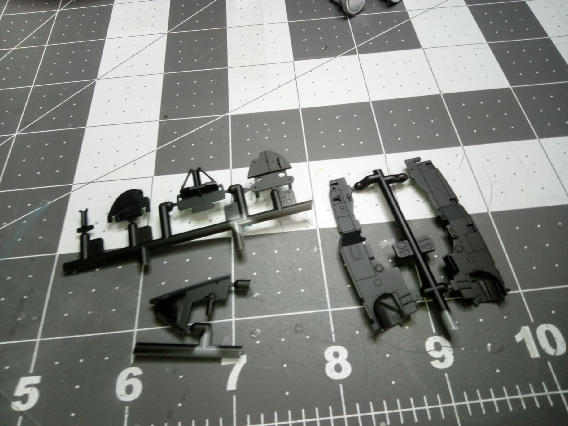

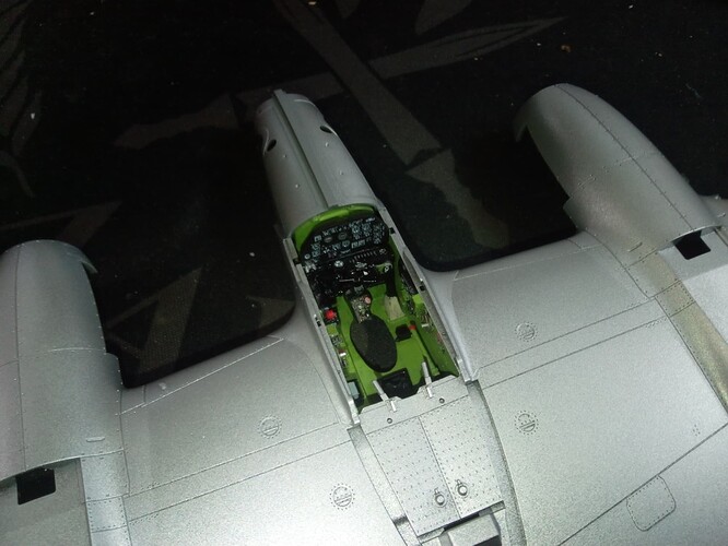

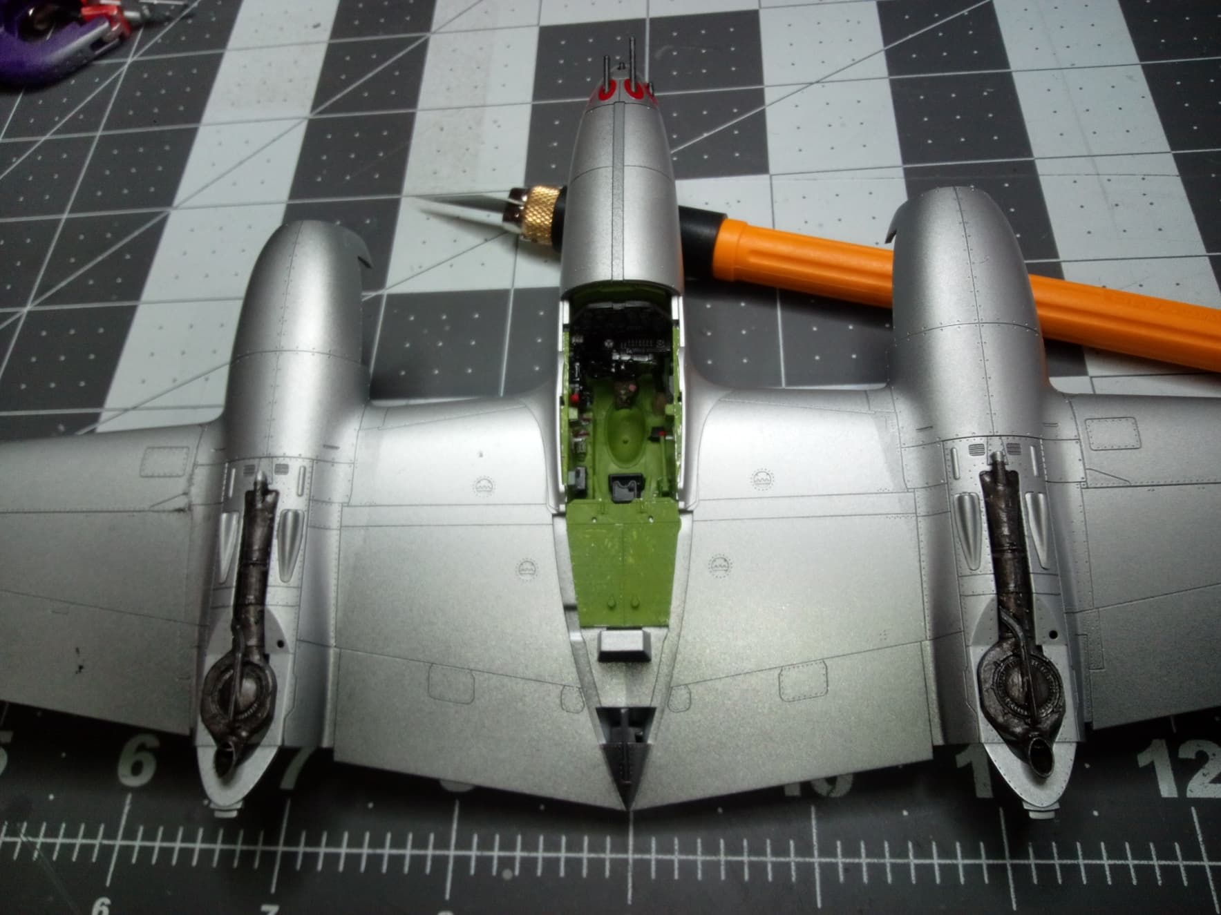

I started on Monday the 6th. I completed the cockpit today. I used a Look dashboard and various Eduard PE parts. I didn’t use them all, as I found all the tiny handles and levers to be too much, and the kits levers were fine.

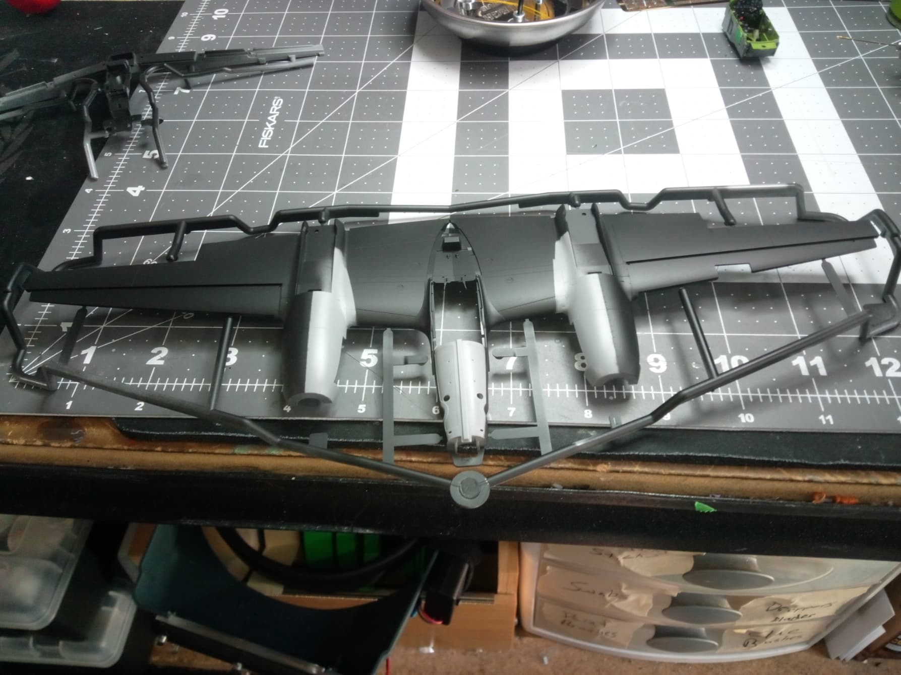

I think it turned out just fine. I then primed some components to let cure for the next steps.

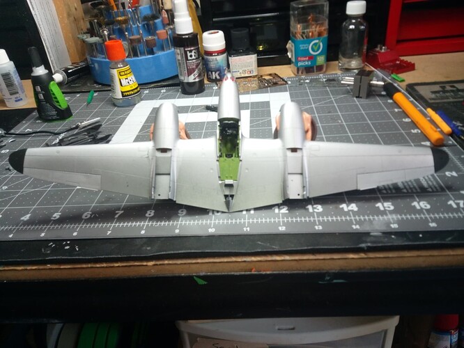

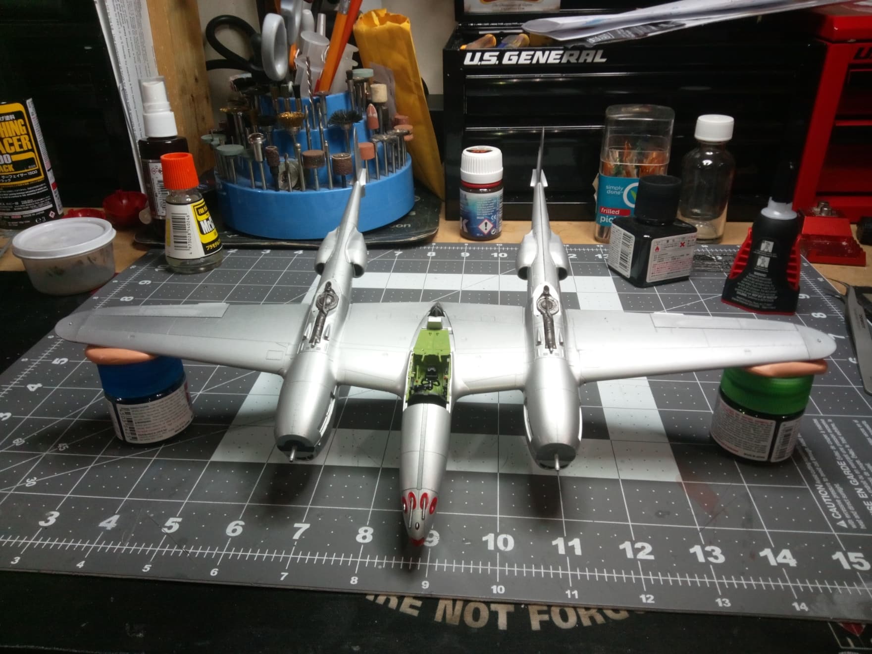

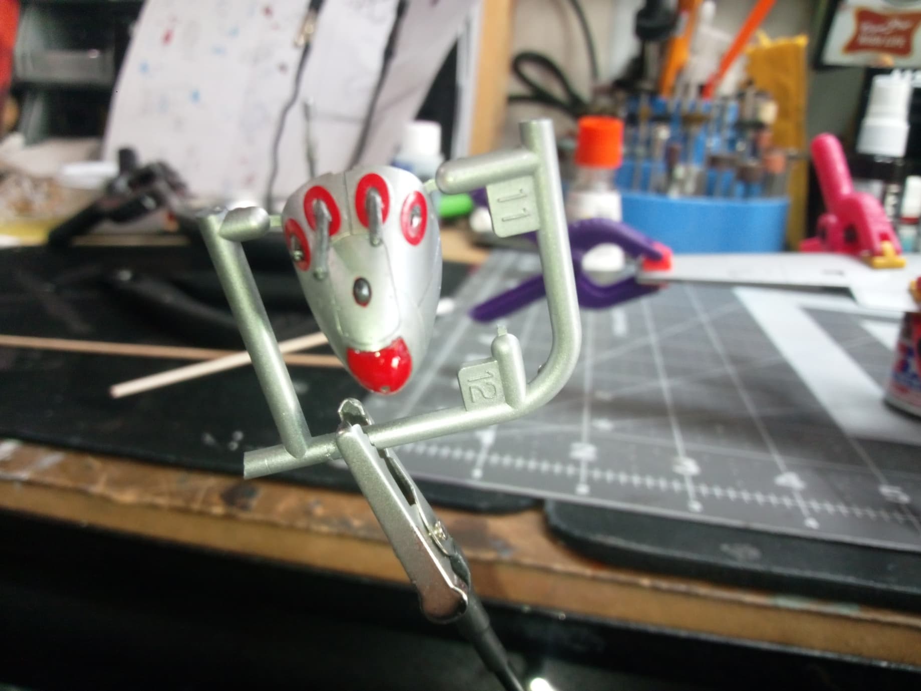

You’ll notice in the last pic that some grey plastic was left bare. I later painted the entire thing in Tamiya AS-12 Bare metal Silver. Black was chosen as the primer color because it works well with silver in my opinion. The bare gray plastic was covered in the silver, which acts as a primer for the olive drab to be applied later. I wanted silver under the drab so I could effectively employ chipping medium when the time comes. Question for those viewing…how does one chip and weather bare metal? Those leading edges of the wings would be dented and disfigured somewhat, but I’m at a loss as to how I can achieve this look with the bare metal look. Suggestions are encouraged!

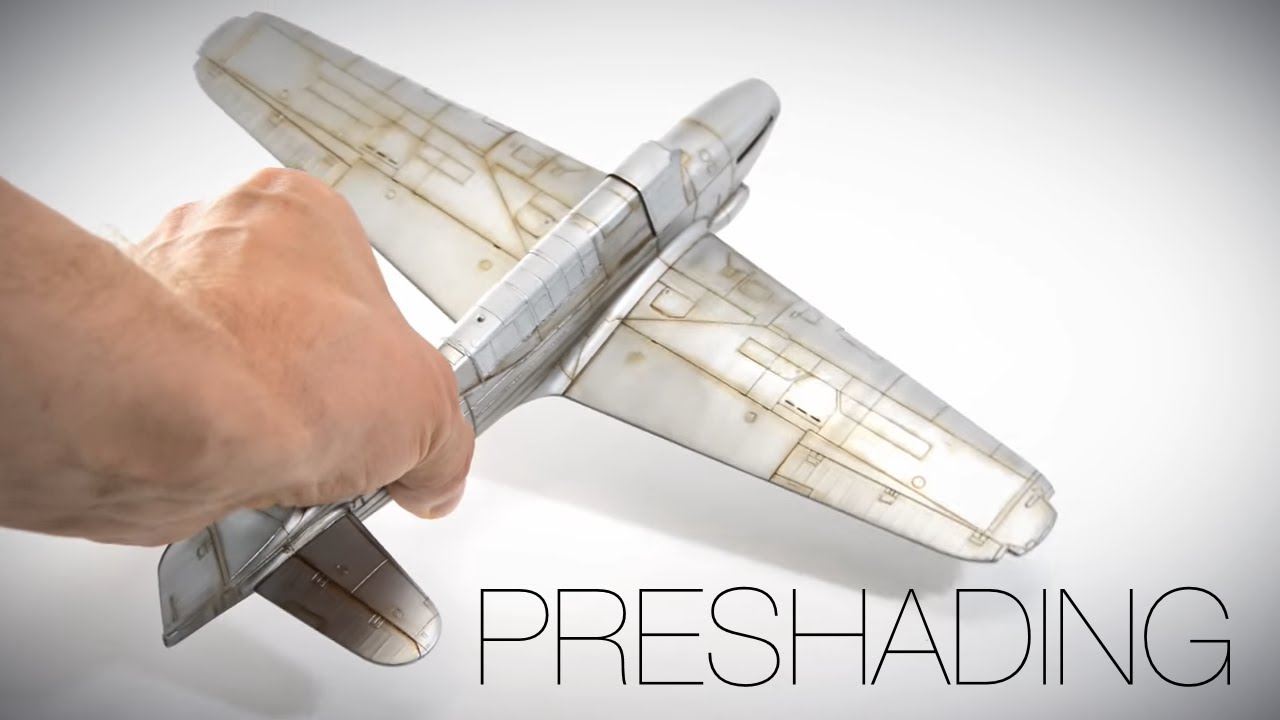

I stumbled onto a video on YouTube just the other day where this guy was using Marmite as a chipping fluid. I could not believe it. Marmite is a yeast extract that is used as a spread on sandwiches. It kind of looks like honey but thicker. The guy just dabbed a little bit where he wanted the silver to show through, painted the color over top then used warm water to clean off the Marmite and voila, chipped paint. It looks far easier than hairspray or salt. I have not tired it myself but here is the link:
It comes at the end, after the pre-shading part!

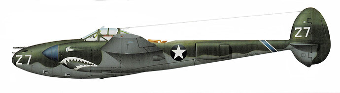

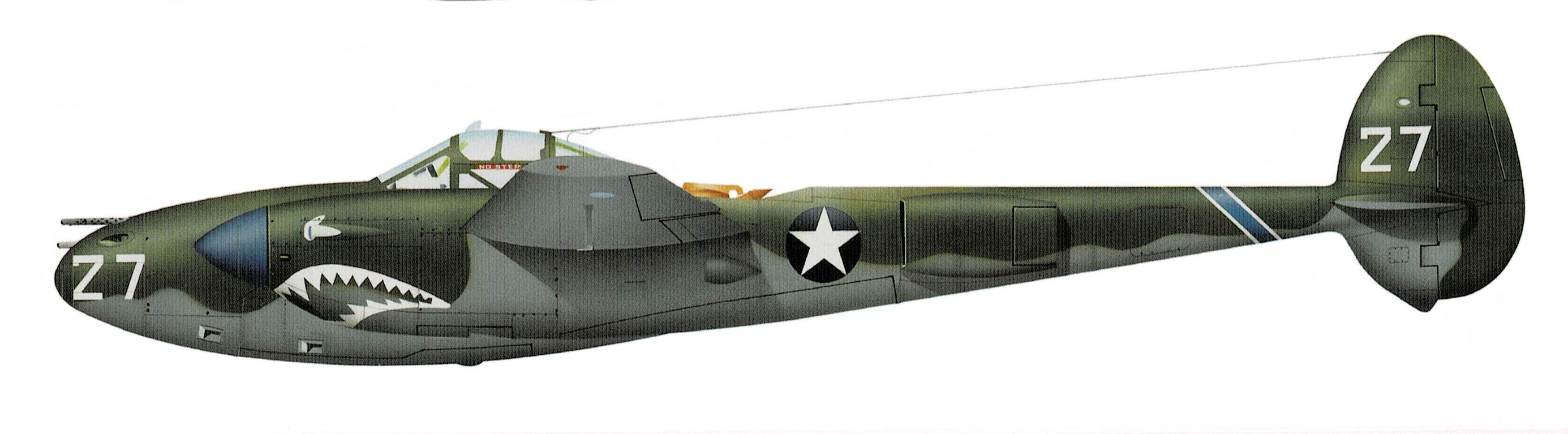

Here is Bong’s P-38F, White Z7:

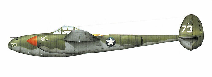

Here is Bong’s P-38G, White 73:

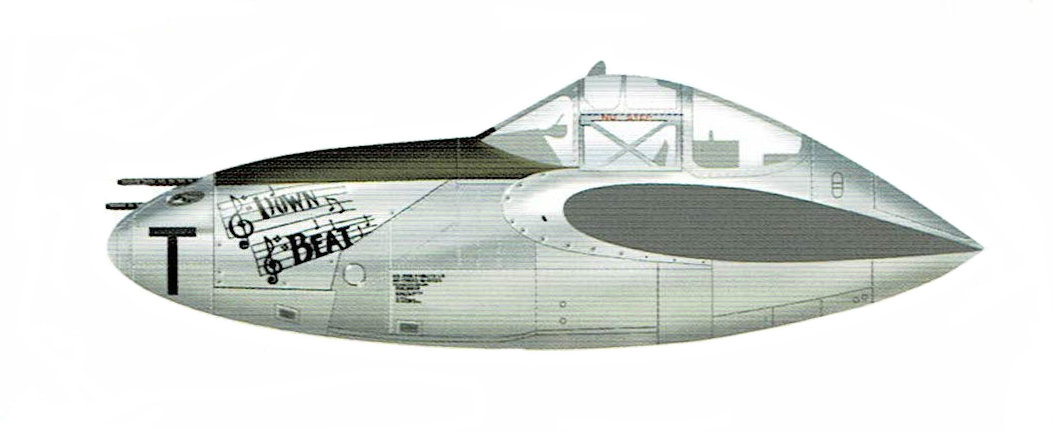

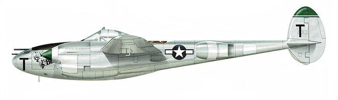

Here is Bong’s P-38J, Ser. 42-104012, Black T, “Down Beat:”

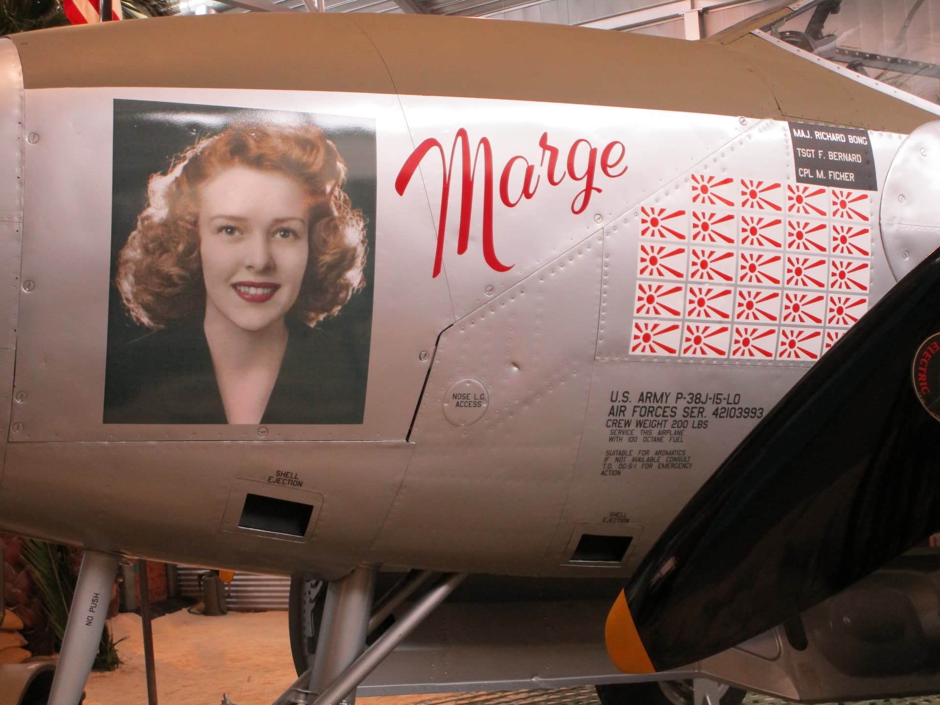

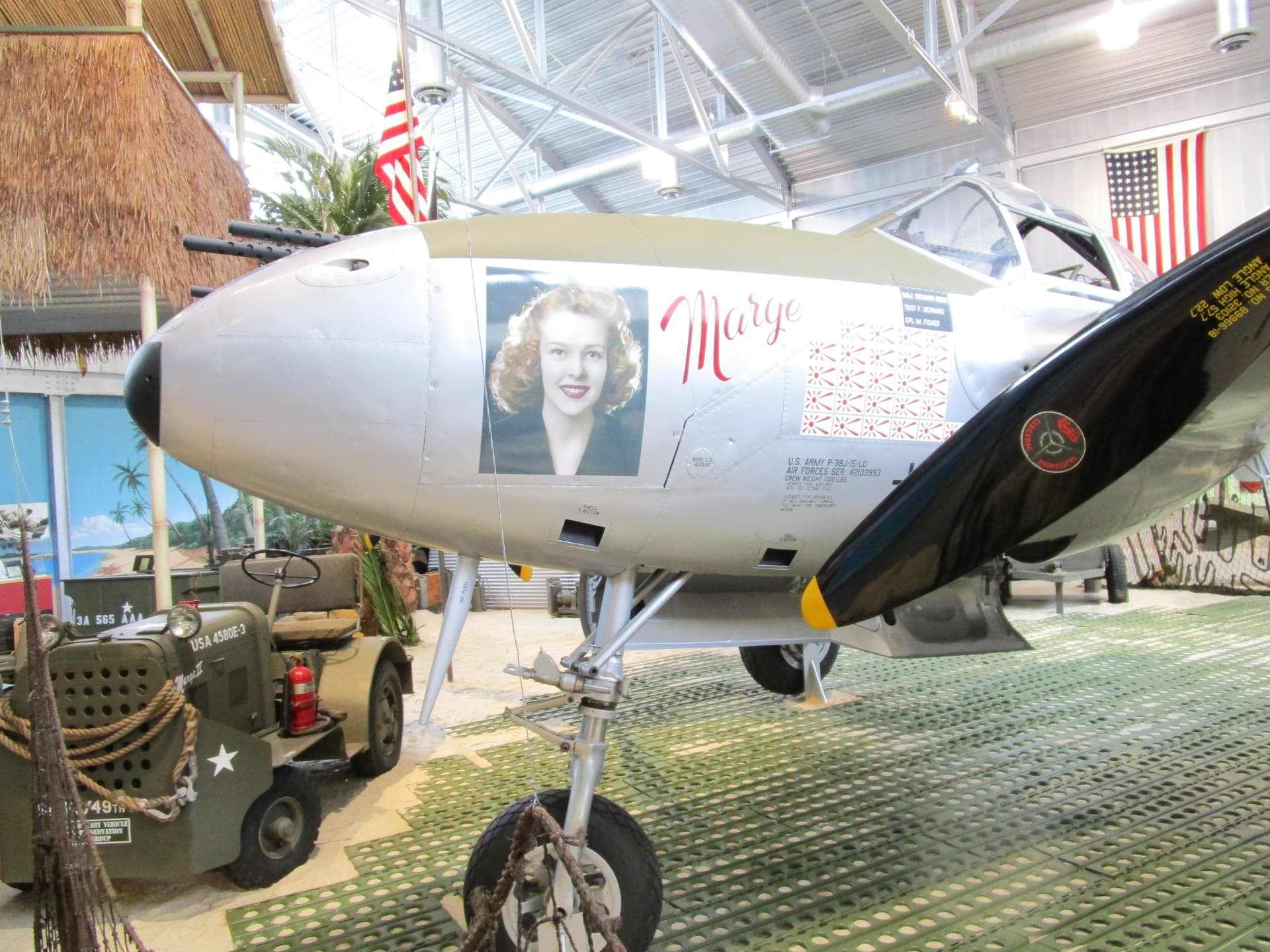

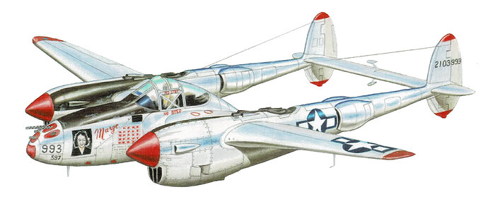

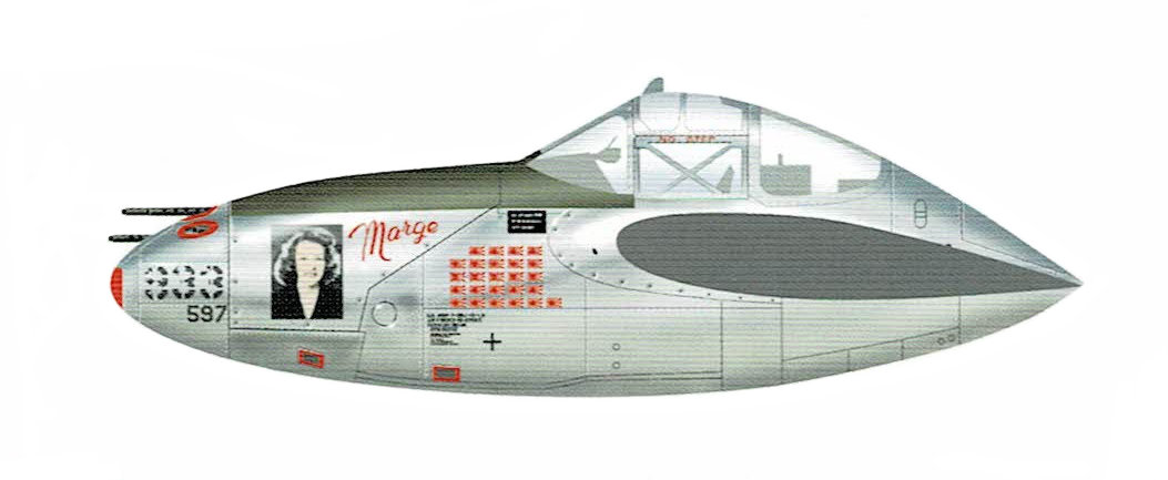

Here is Bong’s P-38J, Ser. 42-103993, “Marge:”

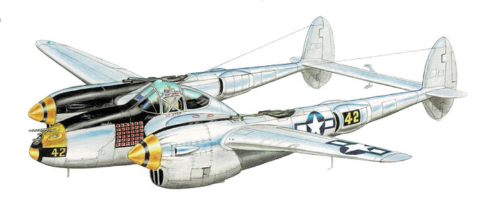

Here is Bong’s last P-38L-1, Ser. 44-23964, Yellow 42:
Another pilot, while flying “Marge” on March 24, 1944, on a weather reconnaissance mission over New Guinea, bailed out due to an electrical malfunction on the plane and Marge ended up in the jungle. The plane was recently found in the jungle and some parts of the plane were brought back. Here is the nose of Marge:
As I mentioned, my favorite is “Downbeat” and here is it’s nose:

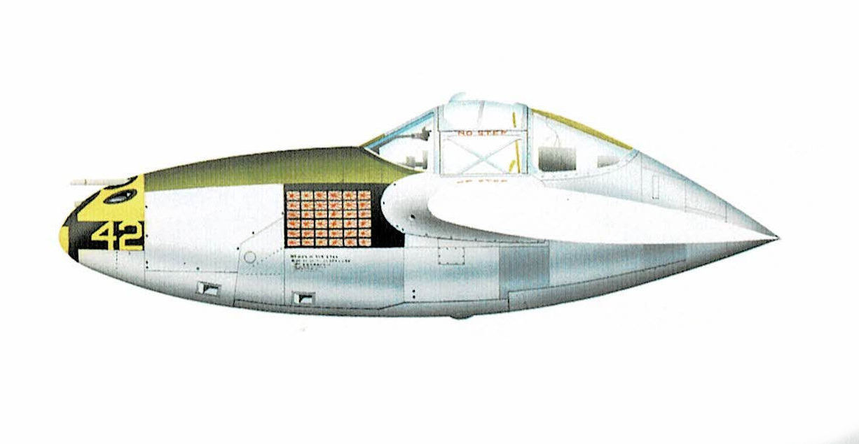

Here is the nose of Yellow 42 which displays Bong’s final count:

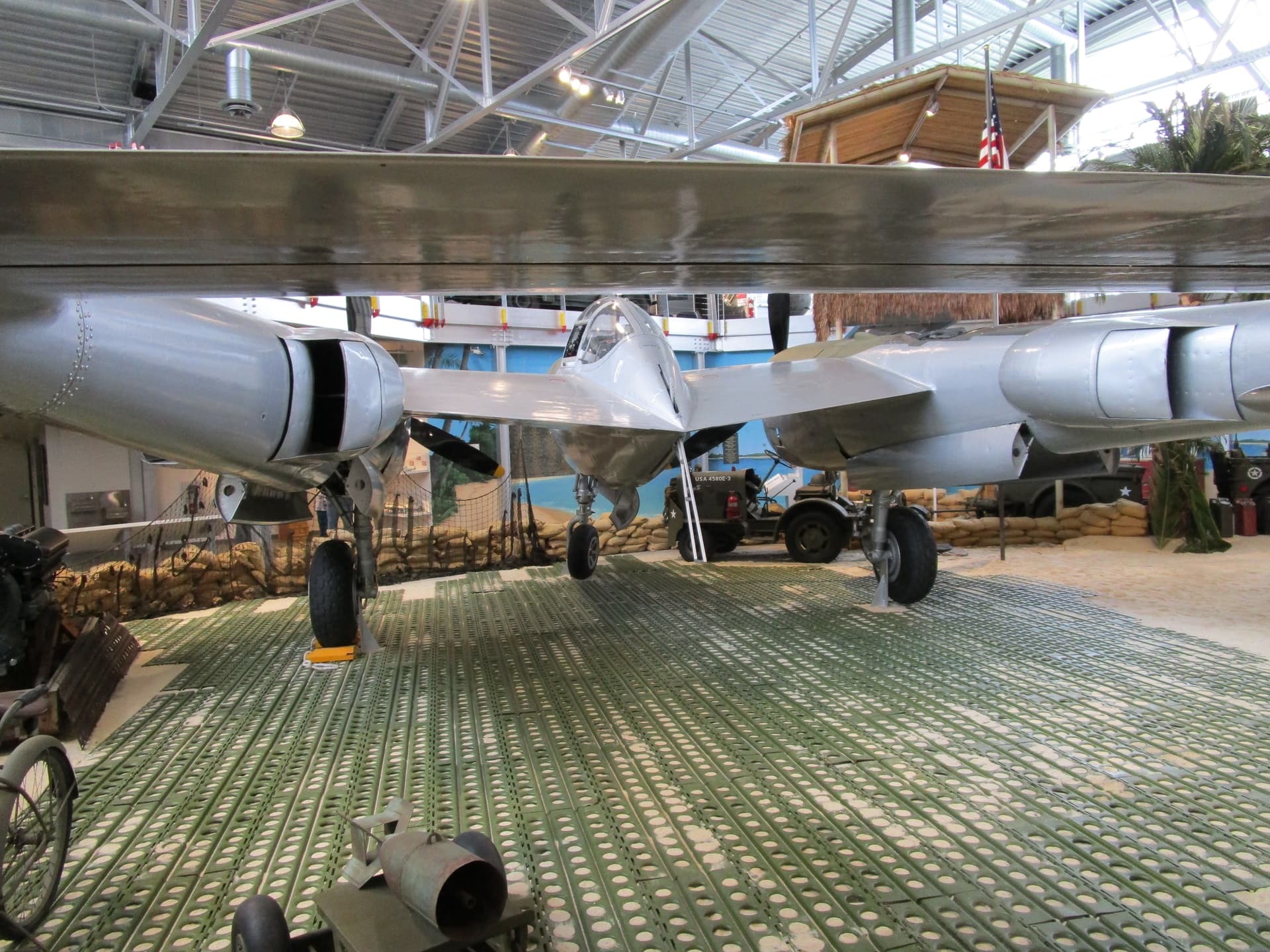

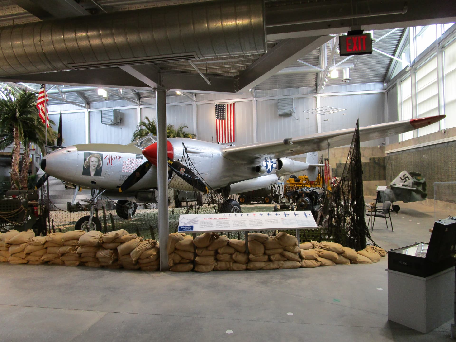

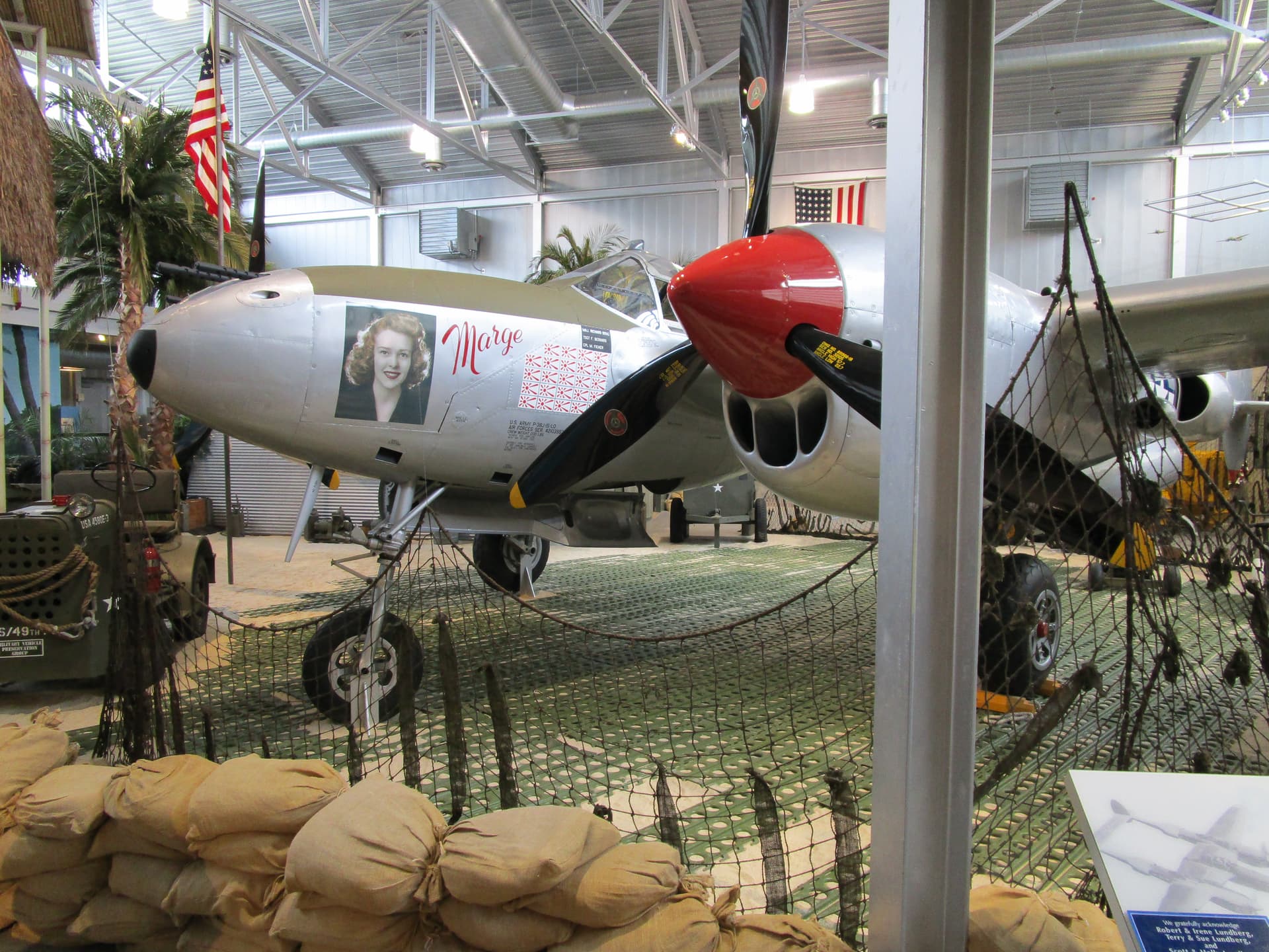

There is a Bong museum in his hometown of Superior, Wisconsin. It has a P-38 done up as Bong’s “Marge” Here are some pictures from the museum:

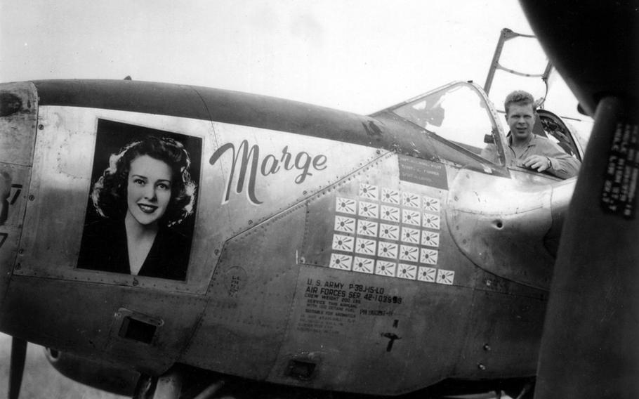

Finally, here is Richard Bong and “Marge:”

You just changed my plan with your post. Not a bad thing, just a major pivot on my P-38. I realize that the Tamiya rendition of Bong’s P-38 is wrong, as far as victories go. The plane is marked with 25 victories, which could have never happened because Mcquire crashed it before Bong scored 25. Bong was flying Downbeat for 25, and when he broke Rickenbacker’s record. I got to find new markings to bring my Diorama to correct.
Yeah there is some question on the Marge with 25 victory markings… That last photo posted above is a widely distributed wartime photo showing Marge with 25 victory markings… There are several more floating around out there as well…
That is the image of Marge that the model manufacturers use for their decal sets… Yes USAAF records show when and where Marge was lost and yes that Bong wasn’t flying it when that happened… The issue on the victory markings is one that is going to be debated forever… They have the evidence from the records and the wartime photo’s that seem to contradict themselves…

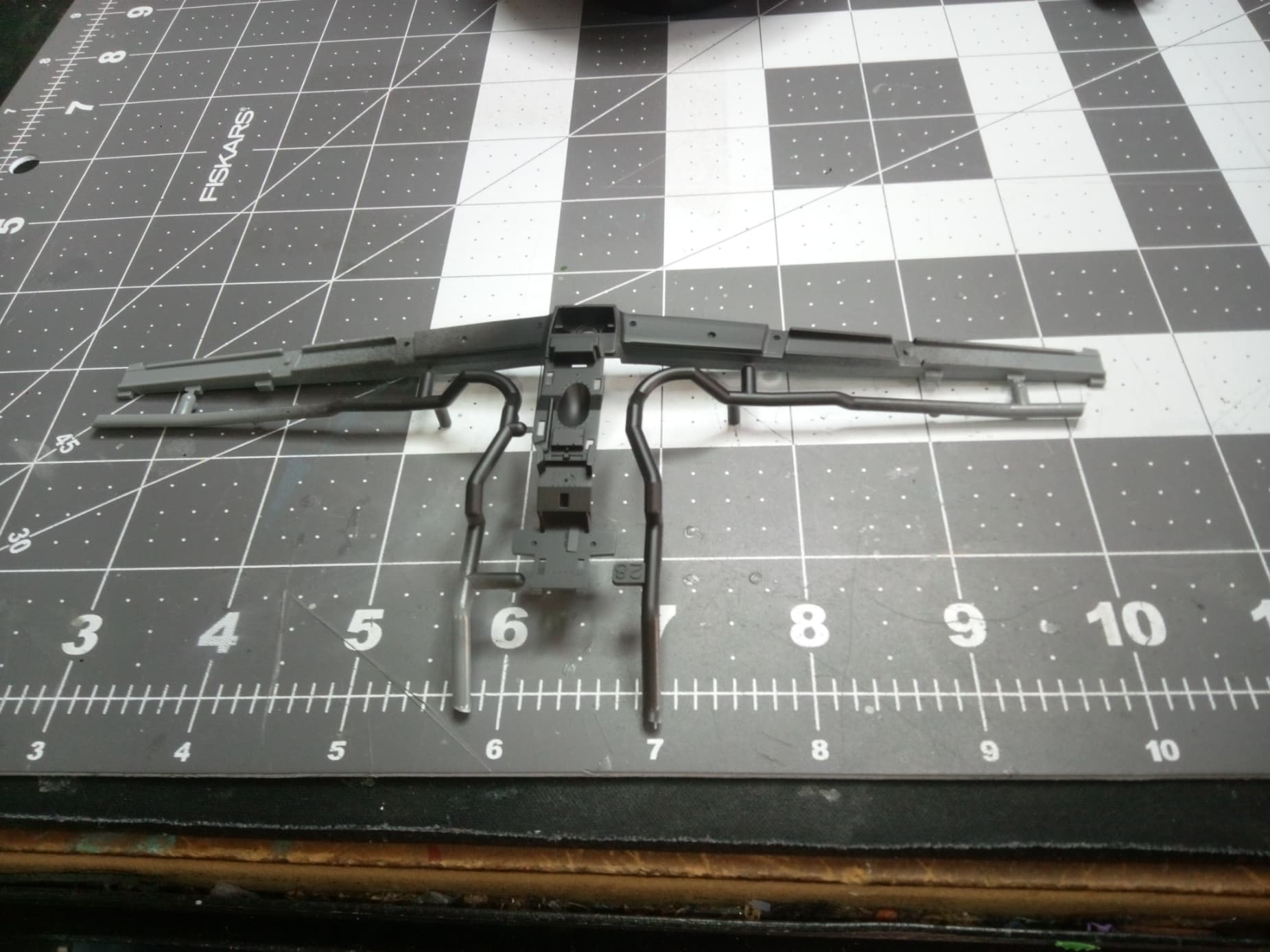

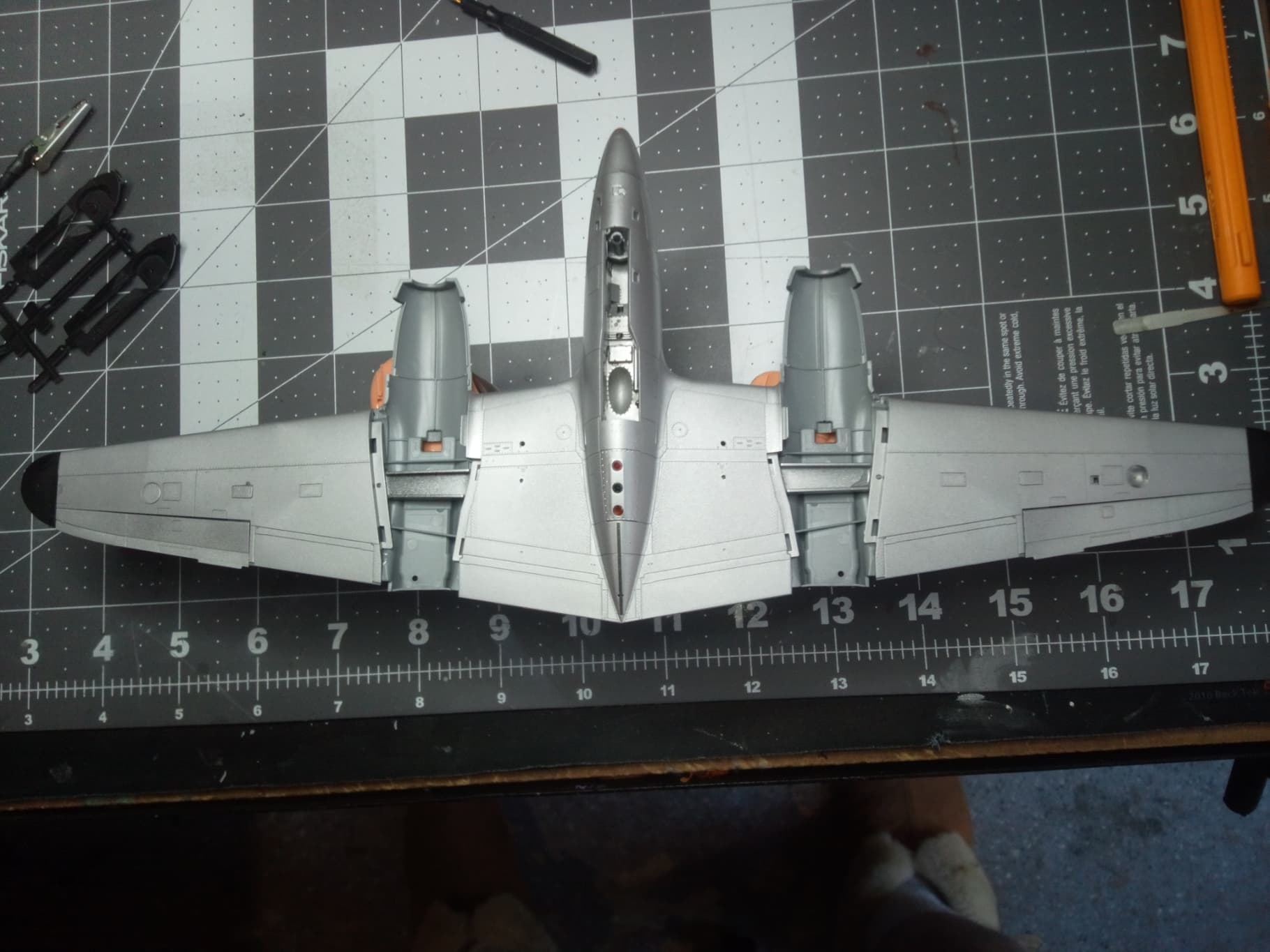

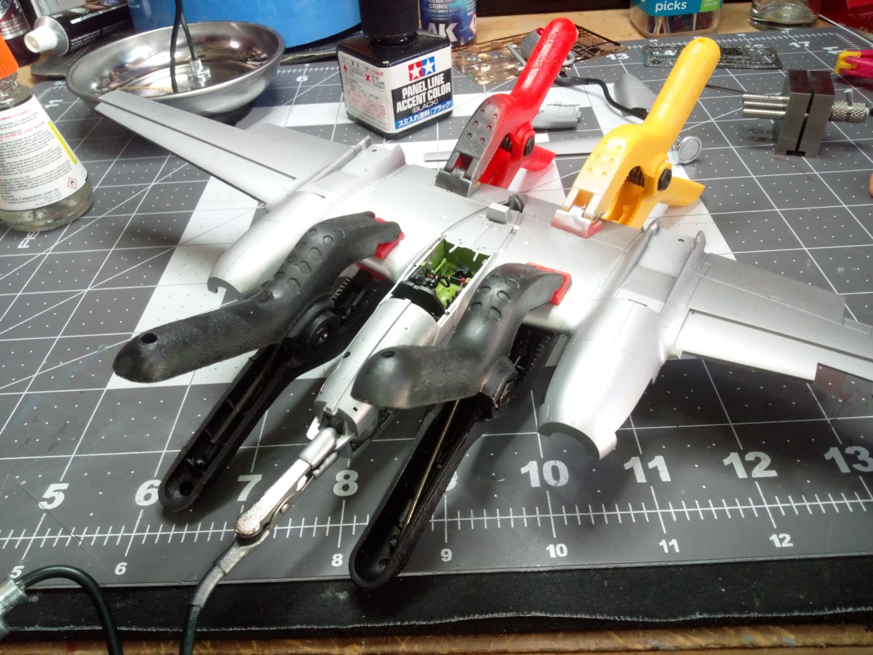

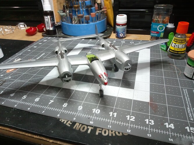

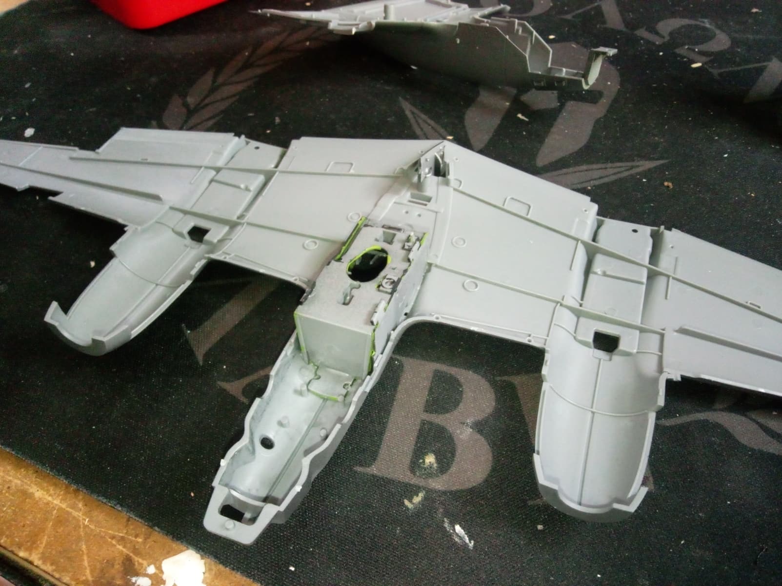

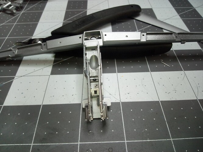

Got some solid time in this week on the P-38. Starting with building the nose gear bay:
Installed the cockpit:

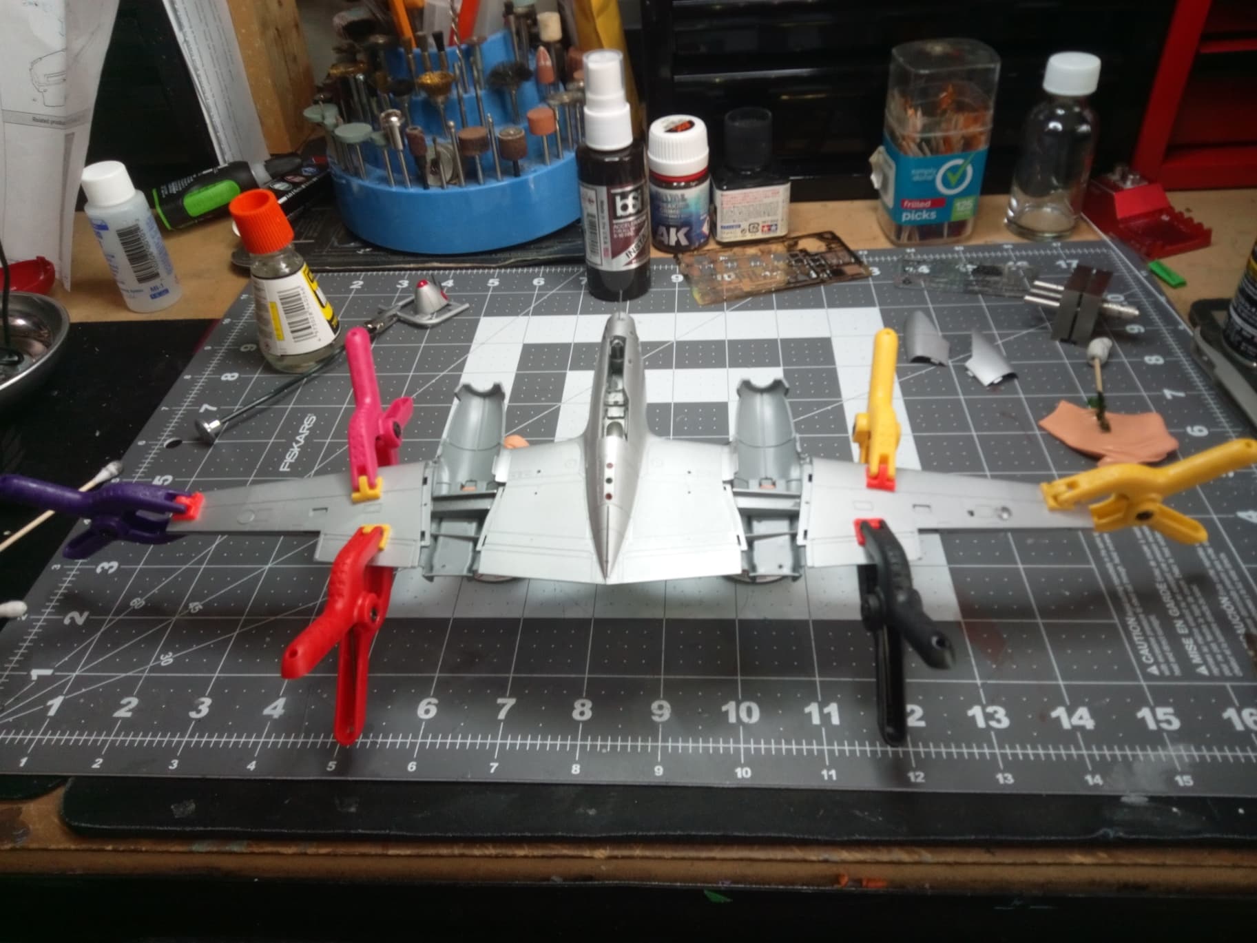

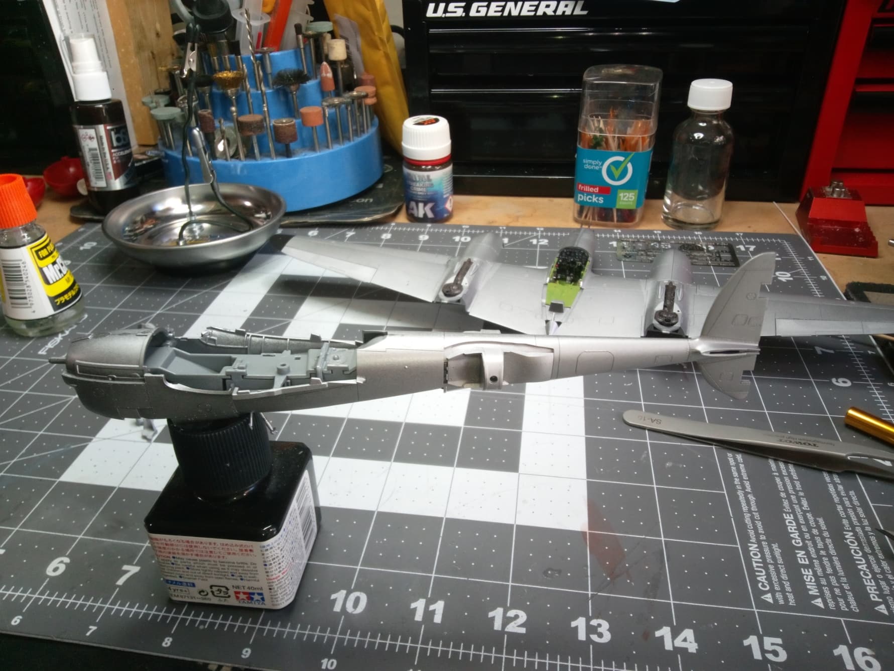

Attached wings, flaps, nose, and wingtips:
And painted and installed the superchargers (Eduard).
Further thoughts. Decided to go with the kit decals over the Down Beat scheme, even though they are not quite accurate. My audience won’t know the difference, and sourcing the Down Beat scheme was too problematic.

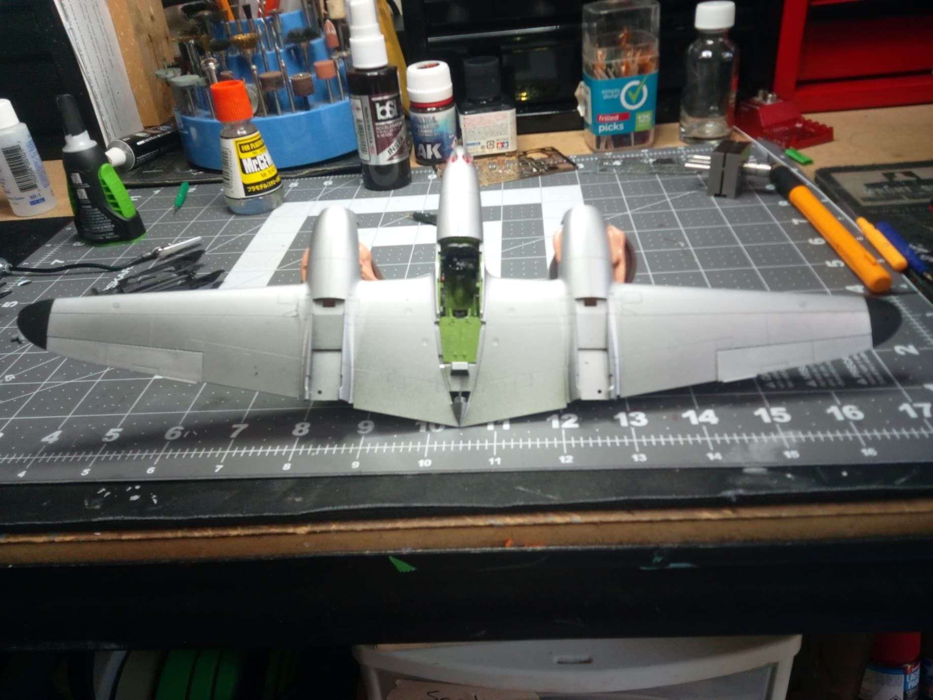

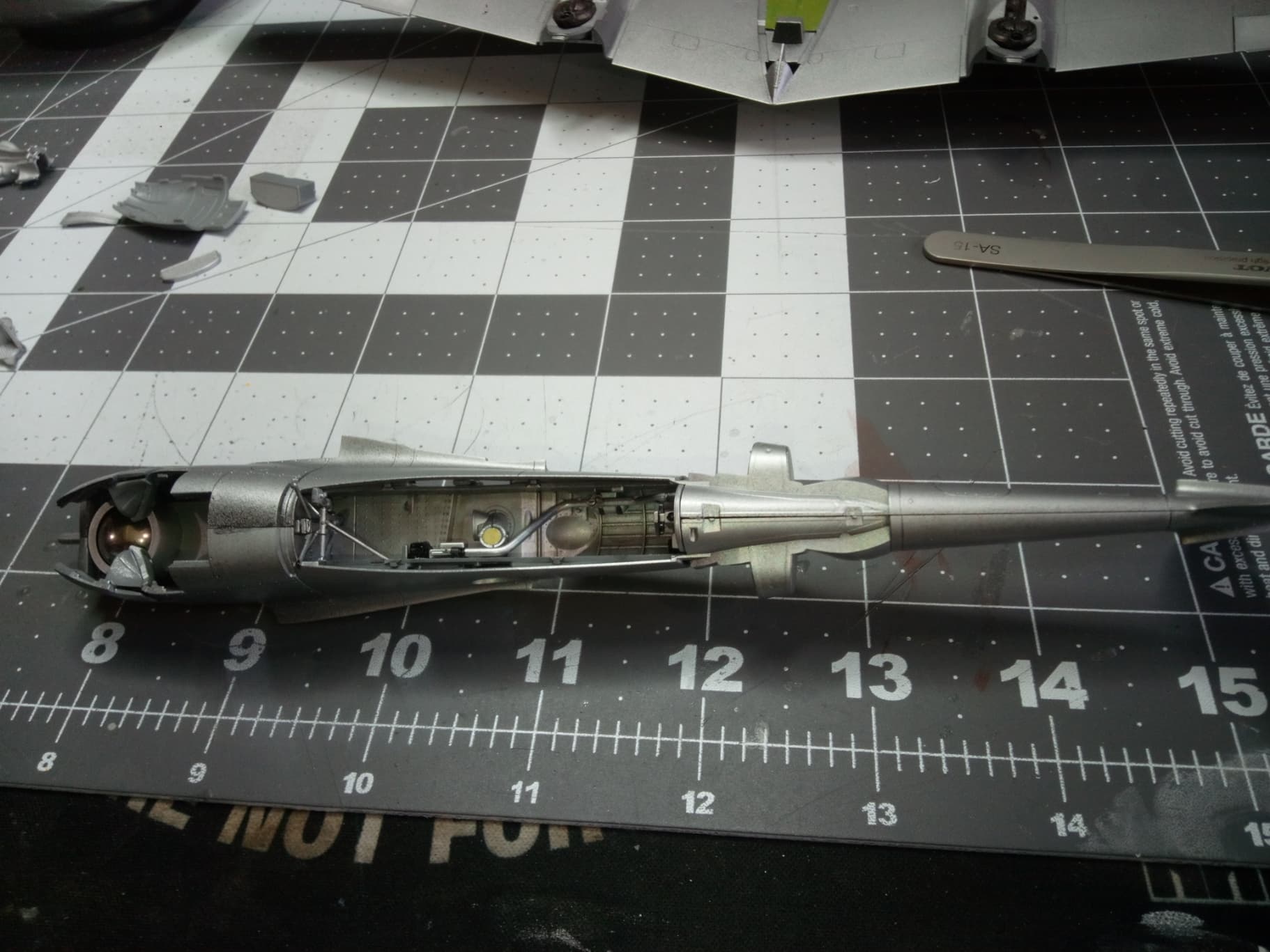

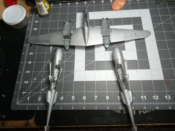

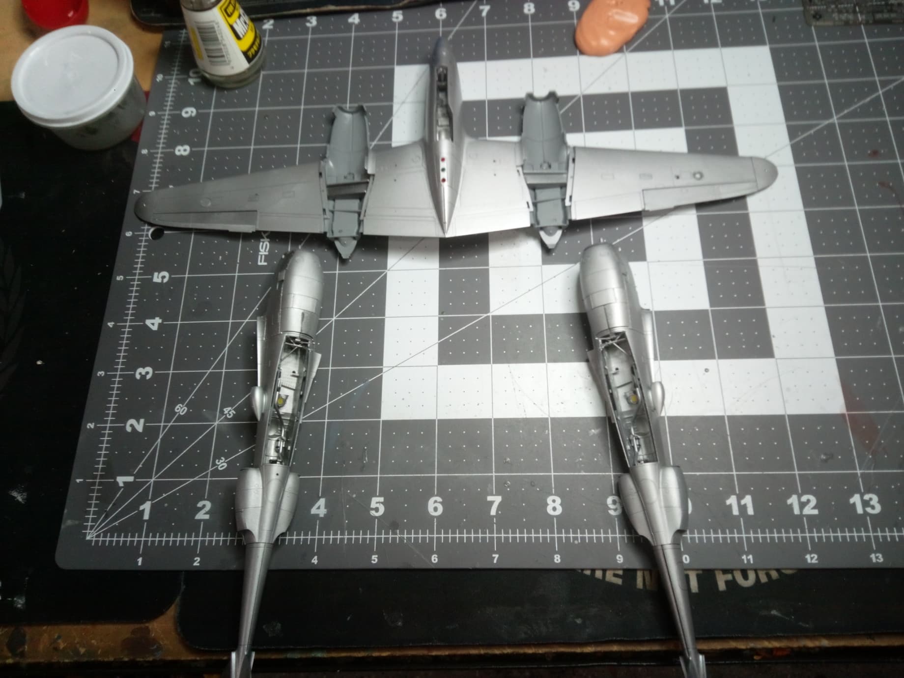

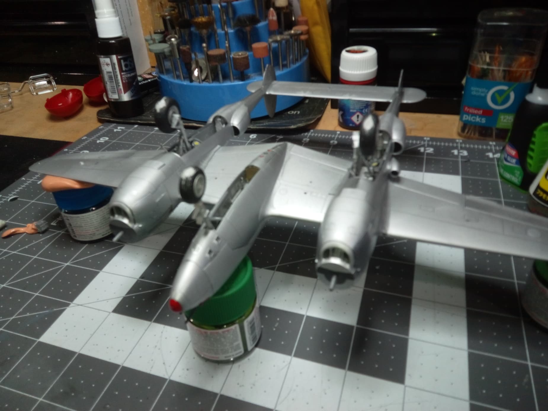

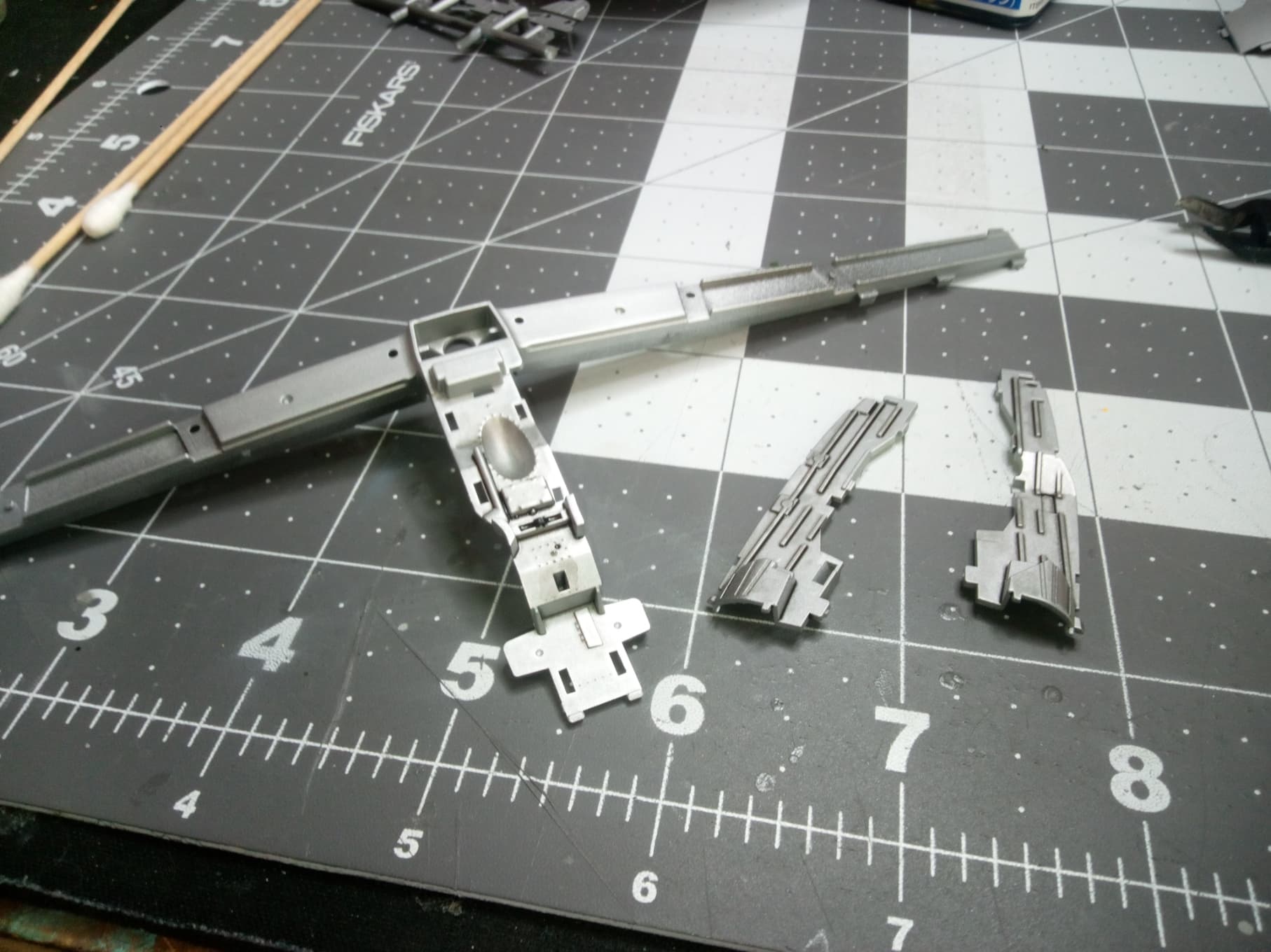

Update on the build. Been away from the bench for a while due to an inability to find motivation. Finally got my act together and began assembly of the twin booms. These went together relatively easy, with the exception of the cowlings on the air intakes near the tail. There are three pieces, and they are very fiddly to get lined up properly. I did my best. Oh, before I forget, in reference to an earlier post, I’ve decided not to motorize the props because there was a great deal of re-engineering to be done to the booms in order to accommodate the motors and wiring. In context of the diorama, the juice wasn’t worth the squeeze so I decided against it. I’ll do it on a different project another time.
So, here we go on the booms:
Then I was able to attach the booms to the fuselage:
Built the landing gear and installed them, as well as the tail control surfaces:
I had several issues with the nose gear. The part that forms the tube that holds the gear which was installed way back at the beginning, split back into two pieces while I was in the process of gluing the gear in place. The race against time was on! There is a support structure for the nose gear that the nose gear has to pass through and clip into place which makes for very fiddly machinations to get into place correctly. Along with holding the split part together, I really needed about four hands to make it all work before the time control super glue set. I made it. Thank God!
I invested in a set of Eduard sagged tires and went ahead and built, painted, and installed them. The white spots you see are the contact patch and were intentionally left that way so they can be glued securely to the dio base when the time comes. They look really great, much better than the kit tires.
Ran out of Tamiya AS-12 bare metal spray paint, just short of the goal line. So while I wait for more, I’m moving on to finishing the cockpit and painting the pilot. In an earlier post, I mentioned my need for figures in tropical dress. I’ve found some for the dio, but need to recheck my pilot figure to make sure he’s not wearing a jacket otherwise I’ll need to find a new pilot as well.
