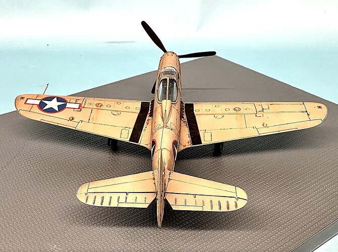

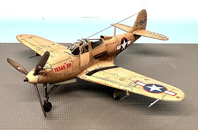

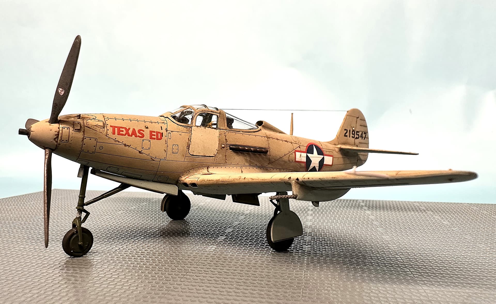

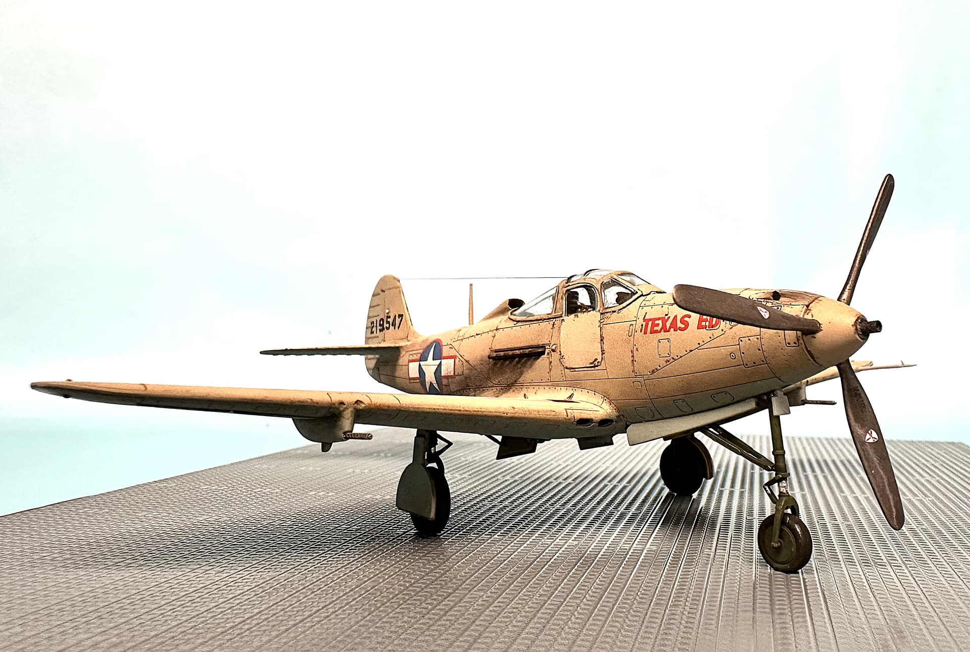

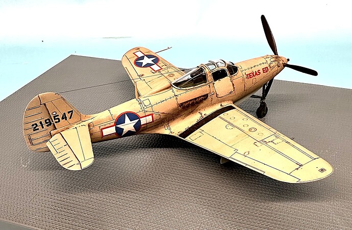

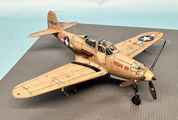

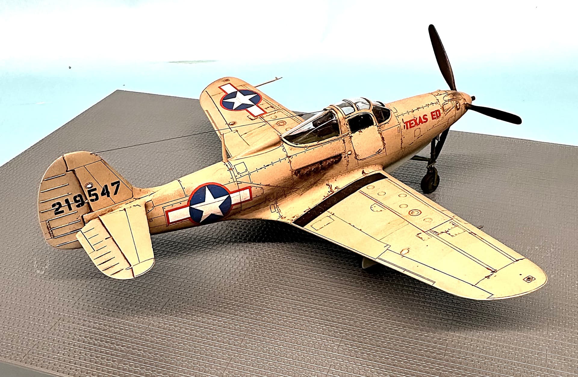

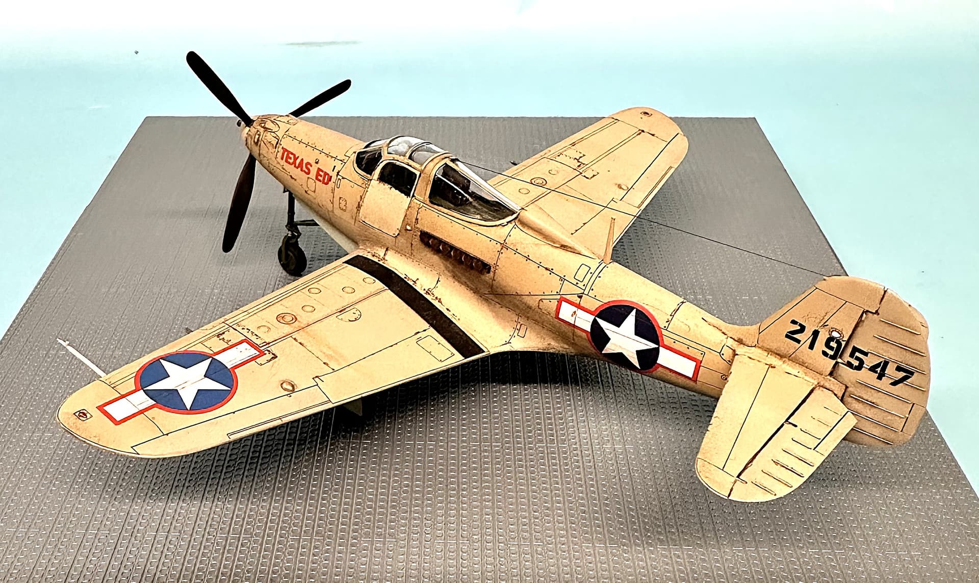

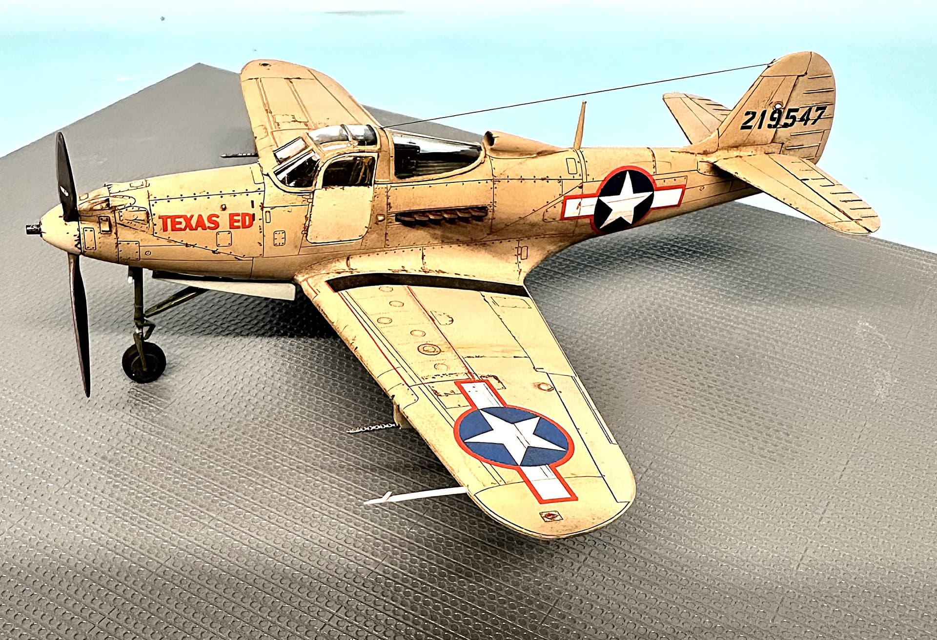

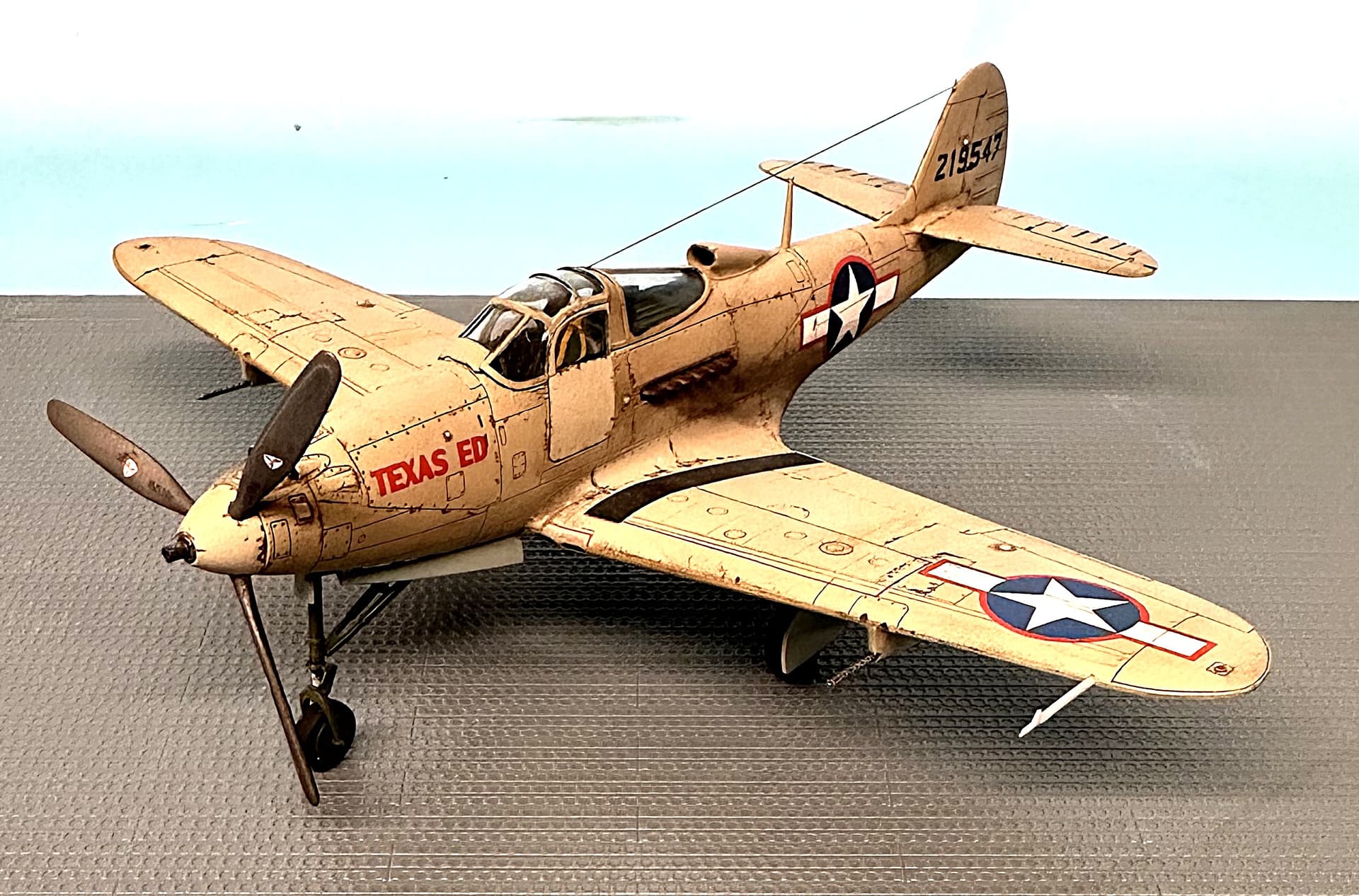

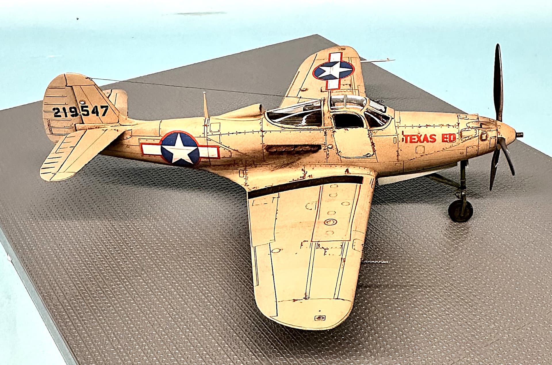

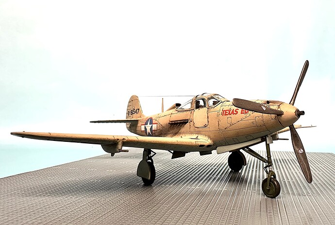

My usual builds are 1:48 scale, but I stumbled across these wonderful kits at the NATS in Virginia in 2025. Upon further examination I realized how nice they really are. Friends had been telling me this already, but as the saying goes, “You can lead a horse to water…”.
This is a FANTASTIC little kit and probably the best of the type in any scale. The engineering and fit are fantastic. Very little seam work was required which REALLY excited me, as I so hate that. Right from the box, this is a fantastic kit.
One or two things to watch. Arma gives you three little steel balls to weight the nose so the model will sit on it’s gear correctly. This works fine until someone bumps the table. I would suggest that when building this model, to add a small lead fishing weight as well just to make sure she stays on her nose gear. The doors do fit in the door openings but they are a little on the tight side. A few passes with the sanding stick and everything fits fine.
It’s a beautiful little kit, and I highly recommend any of the versions they make, which pretty much goes the entire P-39 lineage from the P-39D, F, N, Q and the P-400. I hope they will put out a P-63 as well!
Model is painted with custom mixed Tamiya Acrylics in a Coral over Light Blue scheme. I did use Quick Boost exhaust stacks and Eduard Weapons Set to spruce up the exterior. Infini Scale Aero Rigging for the aerial, and DK Decals, (Sheet # 72115). Weathering was done using Flory Weathering Washes, AK Weathering Pencils, thinned oils, pastel chalks and Tamiya Weathering Powders.
Markings are those of Capt. Felix O Brown, 46th FS, 15th FG, Kanton Atoll, August 1943.

Beautiful 1/72 work, the paintwork and weathering is really nice :+1:

Great work Freddie! That plane looks like it’s been through a lot.

Really nice finish! The weathering and colors are nicely chosen and applied. You could pass those photos off as a 1/48 build easily – those are some really fine panel lines.

This is a wonderful build. I especially like the weathering and how nicely everything looks scaled to the aircraft. Nothing looks exaggerated or oversized. Honestly, if you hadn’t said it was 1/72, I never would have guessed it from the photos.
