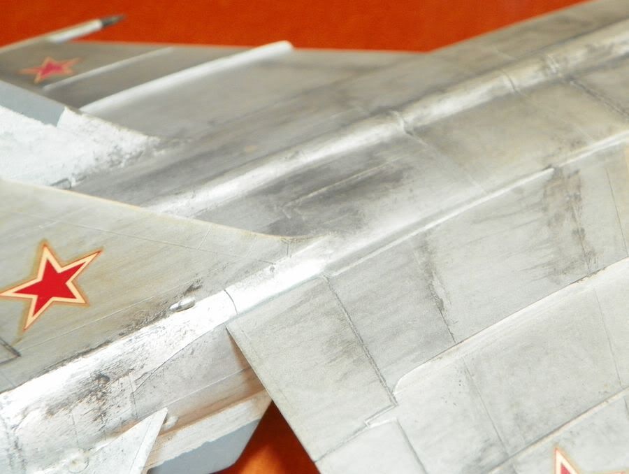

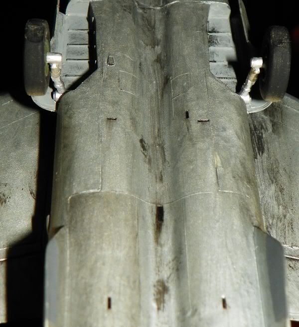

that’s i see after removed lots of dust layers
my old one!
as you see the parts in my copy was not so bad, probably mine was printed when moulds was newest.
At the time i build it i never used the putty [:S] and resolving with CA glue.
I actually have a similar problem with the hasegawa f-104 mould, i take one in the same period of mig-25 and he fit perfectly and free of flashes. Recently find the G version of same kit and with my disappoint the sprues comes with lots of flashes and pieces not fit perfeclty as the first i build.

I like the dirty streaks. and oil marks, thats a good idea. Did you make the rear exhaust area INSIDE the airplane with extra detail? It looks like it.
